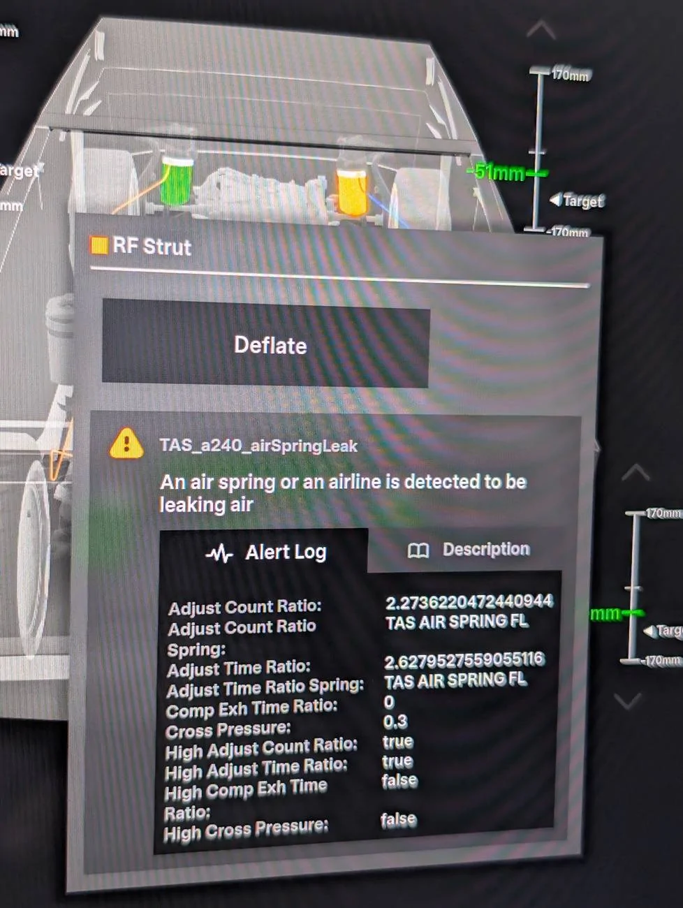

Cyberfamily
Becky
Jan 23, 2024
38
Alpena, MI
Tesla 3 AWD, AWD Cybertruck
Nurse
Check in the service menu. This showed up on mine a month ago. Going in soon.
Adding. It didn't show up in alerts. I went into the service menu. I heard it start and run often at the beginning of daily drives.
