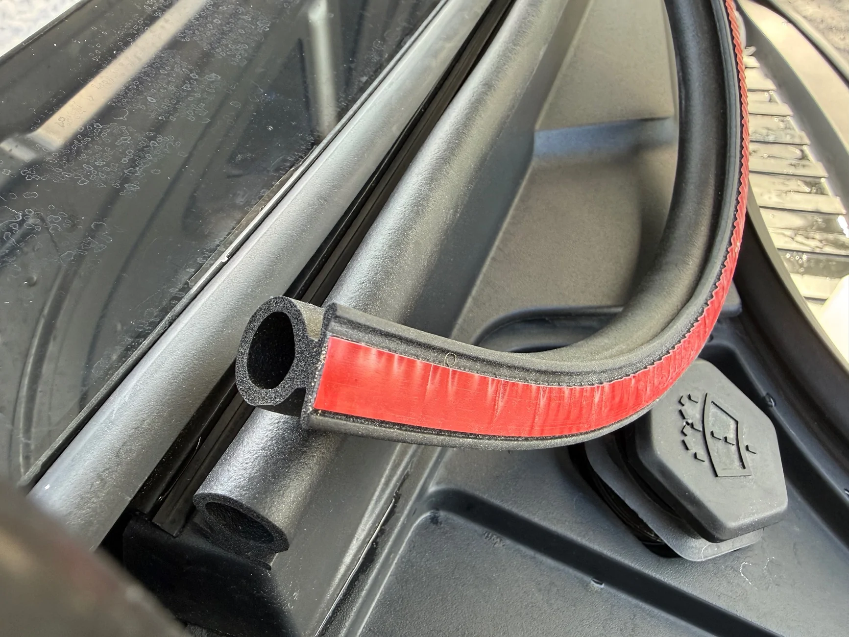

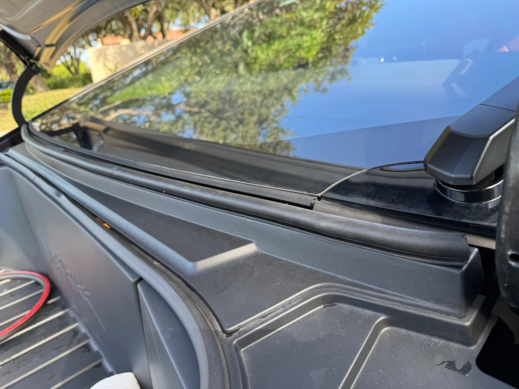

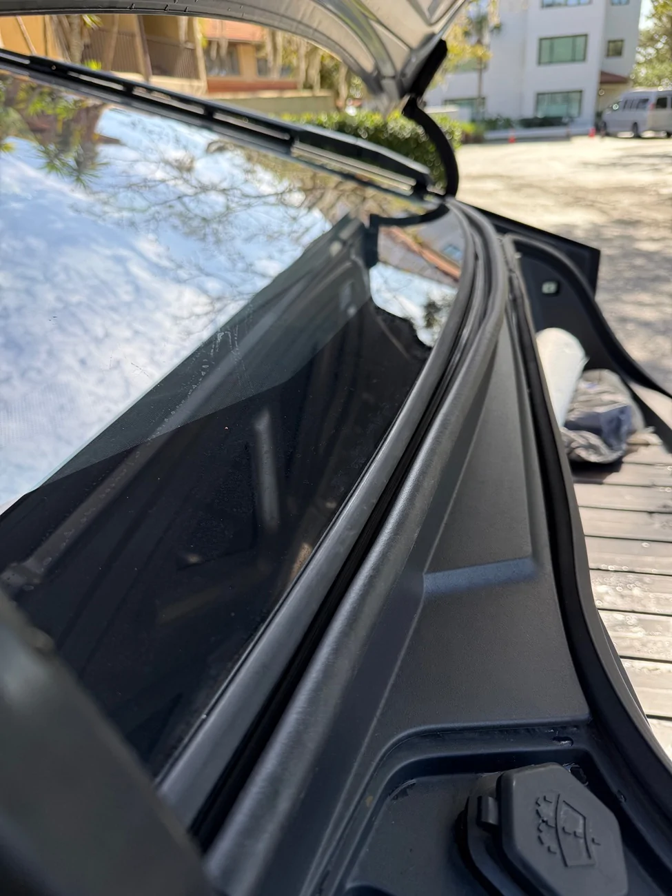

I had trouble with water getting into the FRUNK when I go through the car wash. Here’s what I did, just added an additional weather strip. Easy fix. It doesn’t seem to interfere with the Frunk closing at all.
Wipe it down with alcohol before sticking on the rubber weather strip. the outside ends are still not sealed, so it may not stop all the water, but I think most of it will be redirected and kept out of the Frunk.

Thanks this is useful. The original OEM gasket is starting to detach on mine. Do you have a link to the one you used?

10 Ft Rubber Weather Stripping Door Seal, D Shaped Automotive Weather Stripping, Car Door Seal Strip, Self Adhesive Soundproofing Weatherstripping for Doors Windows Car Truck Auto RV 3/4” by 3/4” BY 10’. AMAZON

I just took it through the car wash……no water leaking into the Frunk bucket, perfectly dry. Still water run off around the wiper washer fill cap and other side, which I expected.
