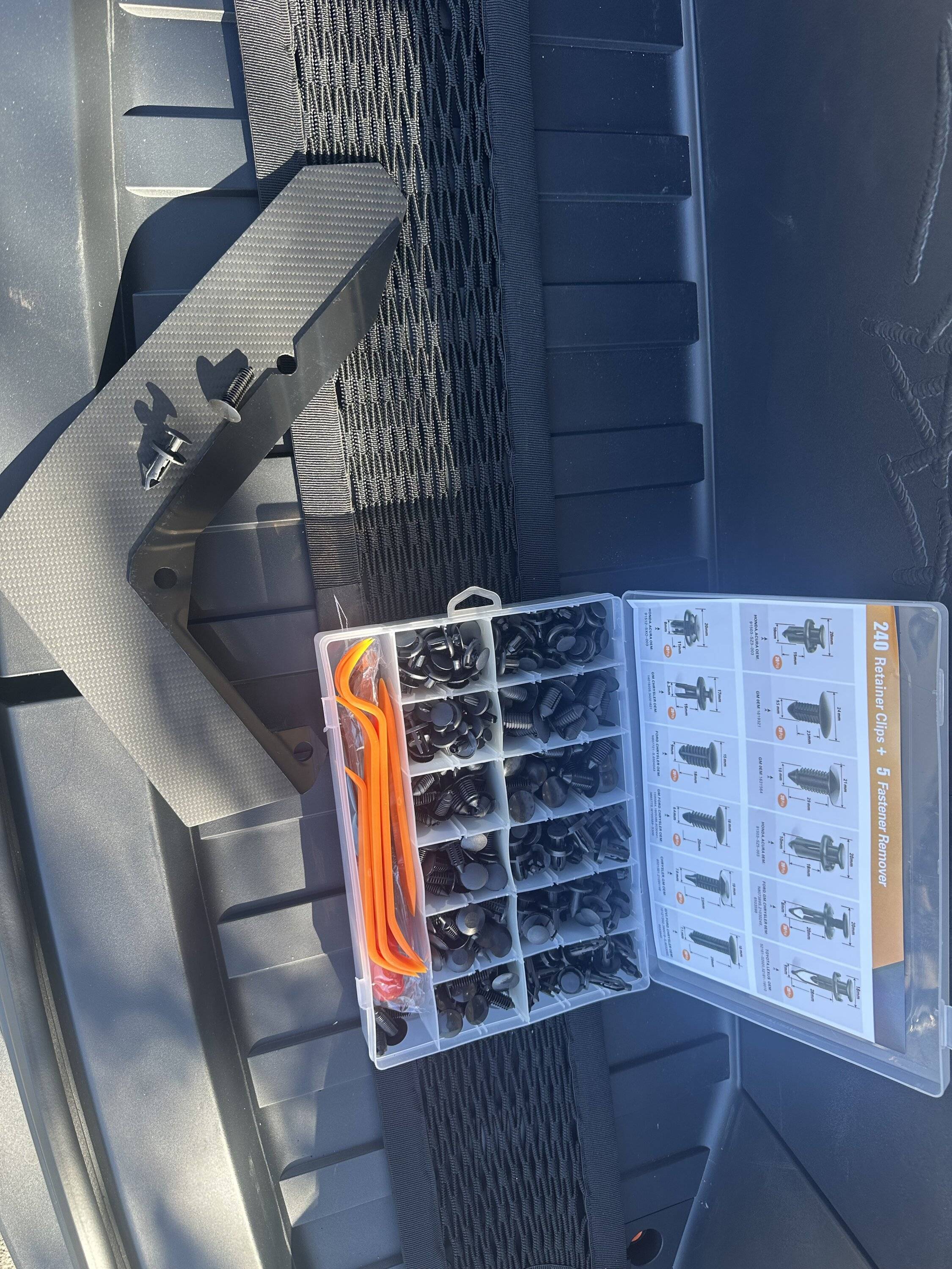

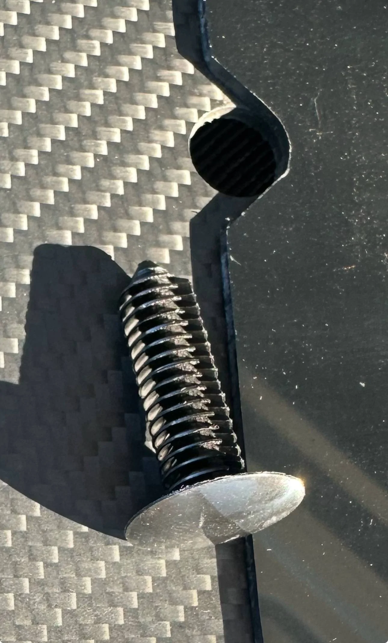

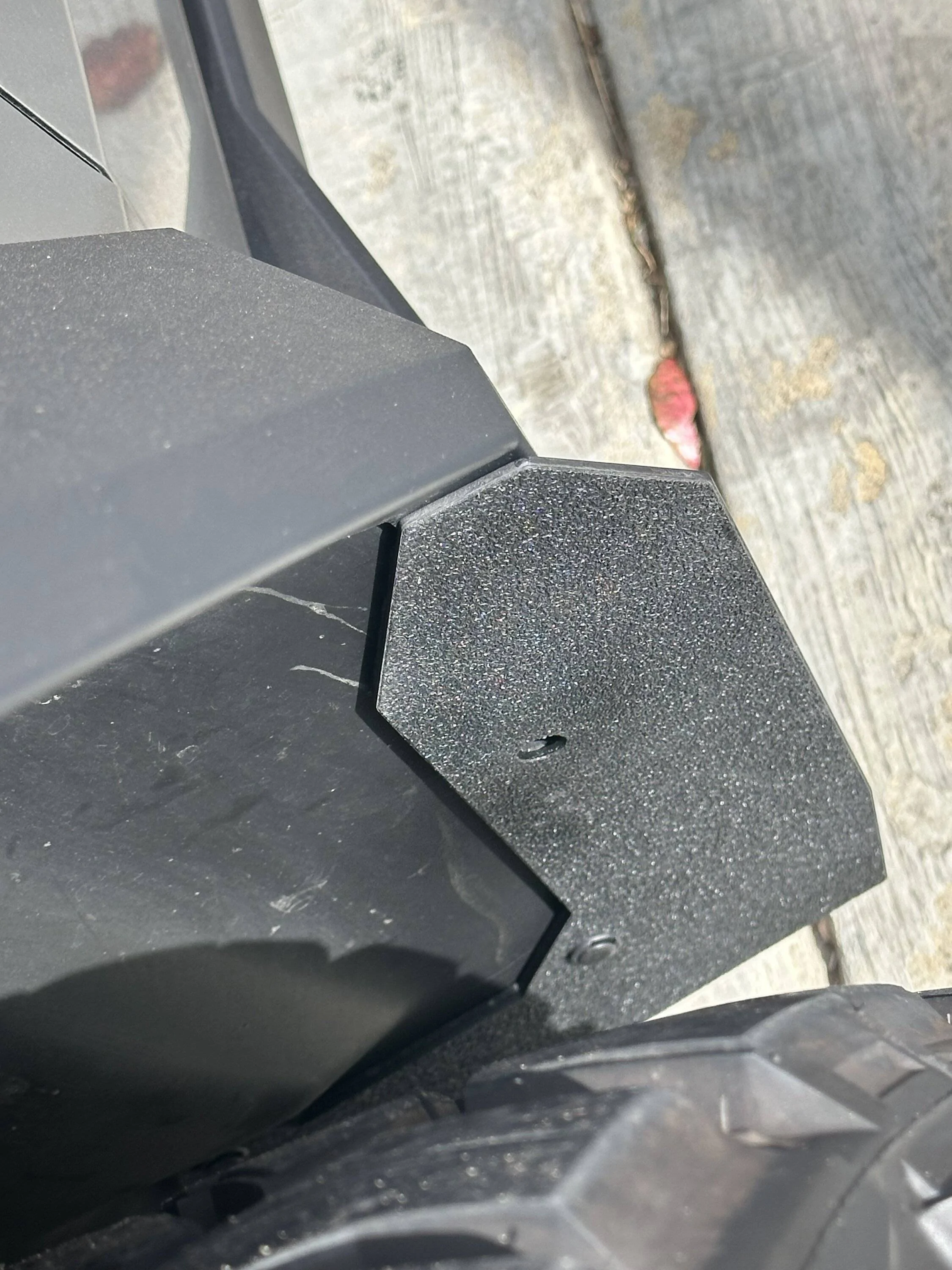

Just an install tip for the body pins. I used the Christmas tree type push pins and they worked so much better !!
The front top body pins are too short to properly engage. Try it and let me know.

I used a longer push pin and put the fastener body behind the mud flap and put the pin through the front of the mud flap
