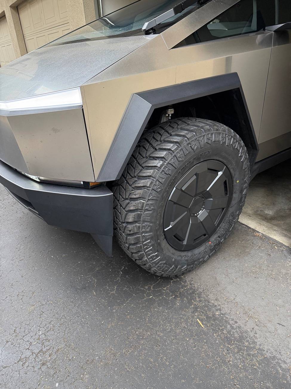

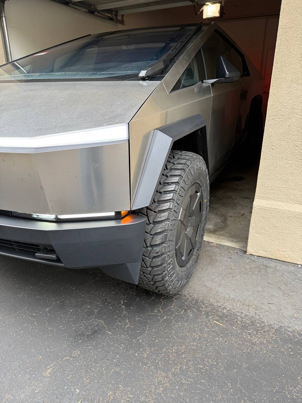

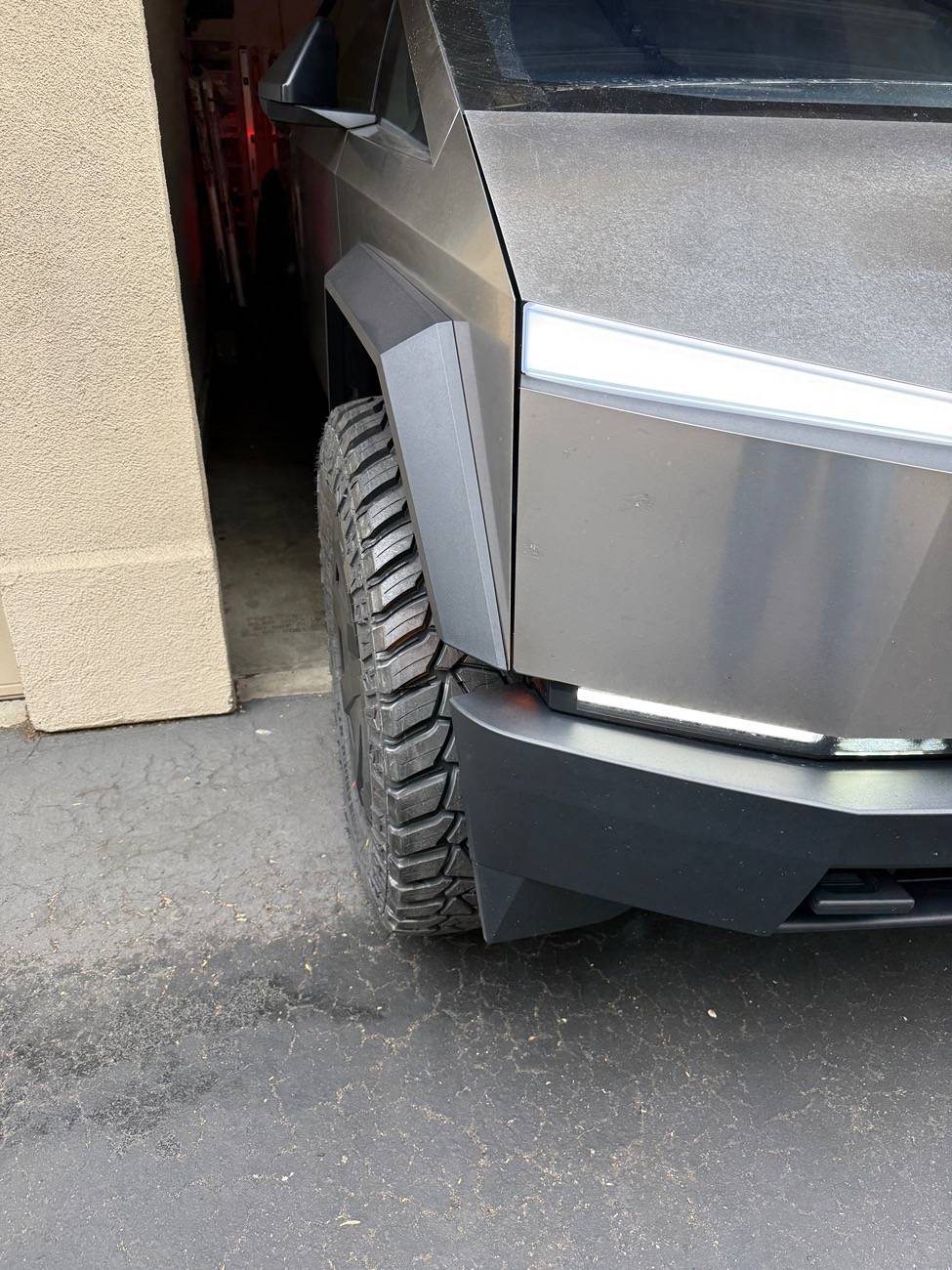

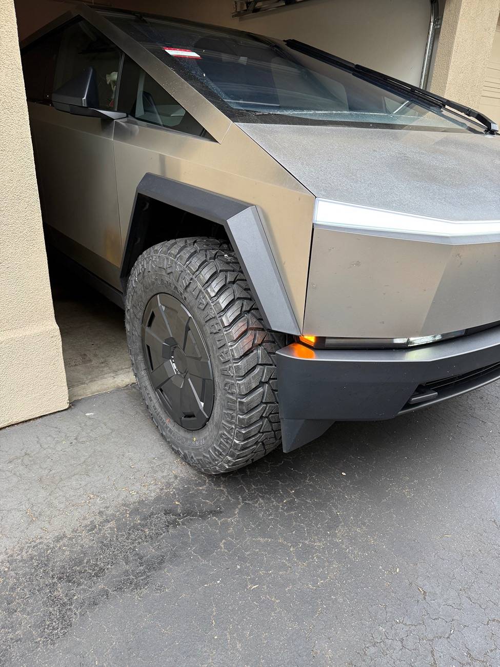

I just installed T-Sportline’s 1.5” spacers in the front and rear. Here are the before and after. I’m glad I didn’t go with the 2”. 1.5” stance is great.
The spacer are are well made. Installed 1.5 inch and lift to clear the 37/12.5/20 on stock core wheels. Runs great but need to do a range test. And will cut a little.
Tesla Cybertruck T-Sportline Wheel Spacers Installed (Before and After) IMG_0492
Tesla Cybertruck T-Sportline Wheel Spacers Installed (Before and After) IMG_0493
Tesla Cybertruck T-Sportline Wheel Spacers Installed (Before and After) IMG_0491
Tesla Cybertruck T-Sportline Wheel Spacers Installed (Before and After) IMG_0490

I wouldn't space the wheels wider on any vehicle, and particularly not the Cybertruck.
The best part is no part. While it's a small change, every change they make to the vehicle is a net negative with the potential exception of looks (since looks are subjective).
By increasing the moment arm (leverage) the wheel has to work on the suspension, spacers effectively make the truck's suspension weaker in terms of withstanding hard hits light hitting a hazard off-road, a pothole at speed, or landing a jump. For the same reason, payload capacity is reduced by an equivalent percentage. Who wants to make their truck effectively weaker?
The additional leverage the wheels have on the suspension loads the parts more under heavy braking, particularly the upper and lower control arms. The upper control arm is designed to "fail" in an accident, to prevent occupant injury and to encourage the vehicle to deflect away from the impact. Spacing the wheels wider means those parts will "fail" in accidents of less severity than intended.
Any hit to average efficiency is an equal hit to battery longevity. Because battery longevity tracks closely with charge/discharge cycles.
Tire store guys don't like dealing with them.
They introduce another potential point of failure. All vehicle forces go through the wheels.
They make the fender flares less effective.
Off-road, I've already noticed the Cybertruck has the widest track compared to other off-road trail users. For example, when going through old snowpack, deep clay/mud, or a rocky area where a previous trail user has cleared or built a path wide enough to proceed. Why make it worse?
The Cybertruck is at the outer limits of what most drive-thru car washes can accommodate. I don't plan to use them, but spacers likely prevent those who do from using them.
The best part is no part. Wheel spacers for vanity reasons are just plain dumb.
That said, it's your truck, so go hog wild. Throw caution to the wind. Take on the extra incremental risk, be stupid. It's your life.
100% correct on each point. Why diminish dynamics solely for appearance?
