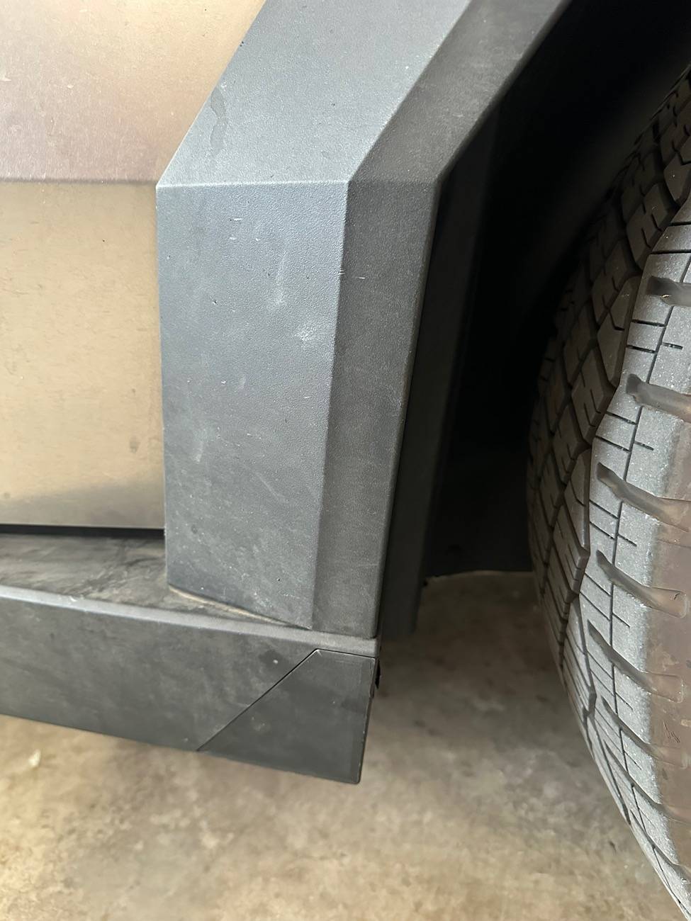

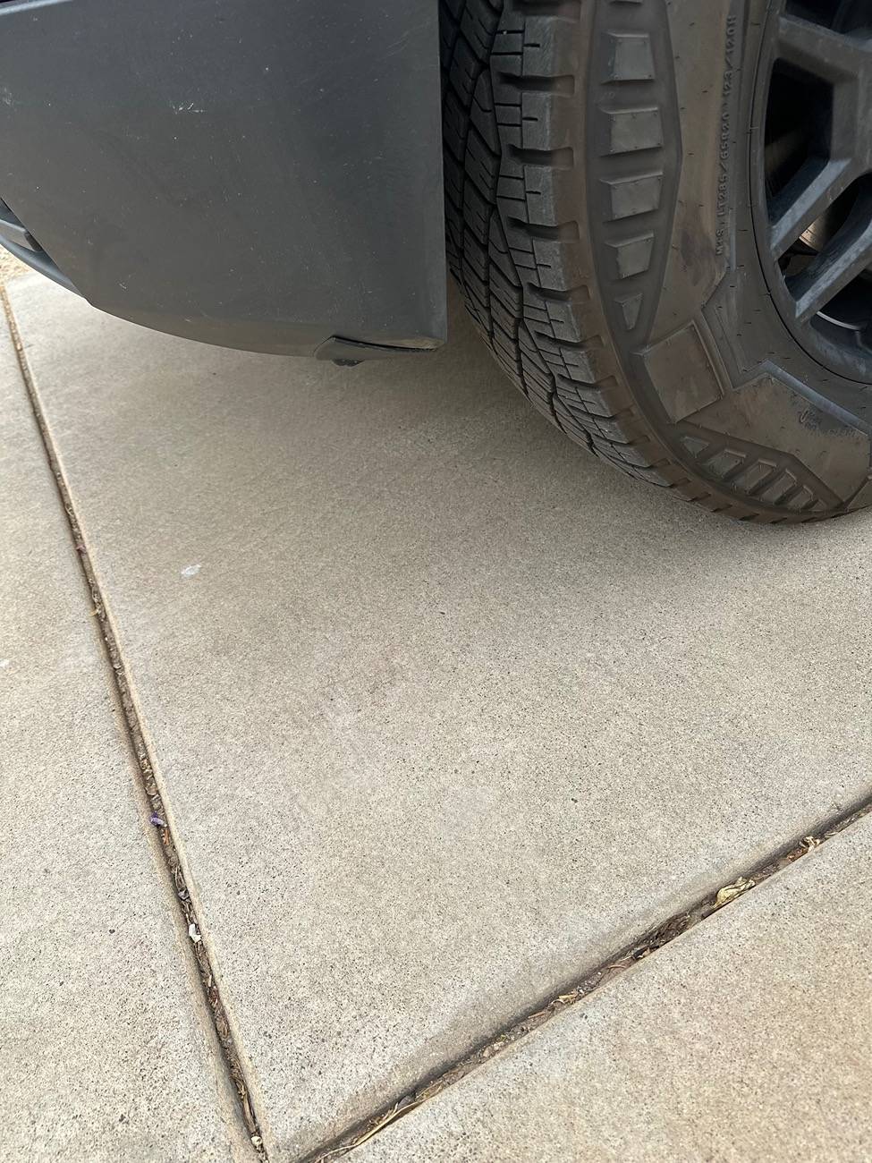

Front fairings come off with 2-3 push-pull connectors and 2 10mm nuts. The EVVida fairing delete (front) goes on with just the 2 push-pull connectors.
Rear fairings come off by dropping 3 10-mm bolts on the rear-most section of the truck’s plastic rock sliders, a 10-mm bolt from the rear wheel-well holding the fairing, twisting the fairing away from the truck while yet connected to the end of the plastic rock slider, and then removing 4 torx-20 screws that hold/connects the fairing to the plastic rock slider. All bolts can then be reinstalled and the Etsy-printed fairing delete can be snapped in. It is then held in place with 2 push-pull connecting pins, and with an small press-clamp that comes with the fairing delete from EVVida.
I’m glad just to not have to buy more fairings because I ran over something unintended.
I think the rear delete looks better than the front, but overall I am pretty pleased. As far as the functionality I’m very happy.

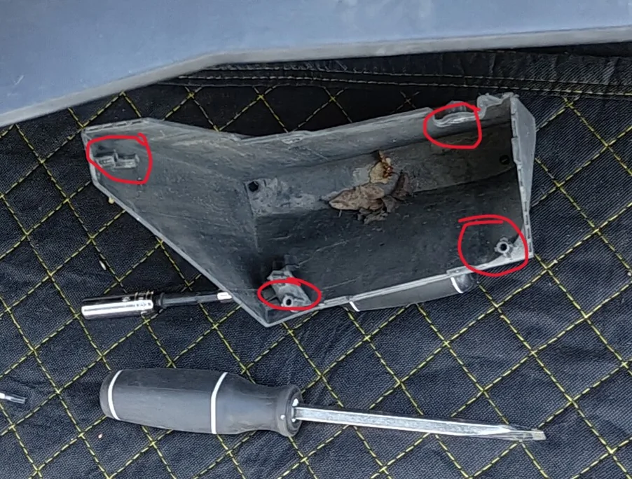

Do you have a picture of the rear one but that shows the end facing the tire? Thanks!
CT_AZ_4x4
CT_AZ_4x4
Jay
May 22, 2024
840
1,405
Scottsdale, AZ
AWD CT
Self employed

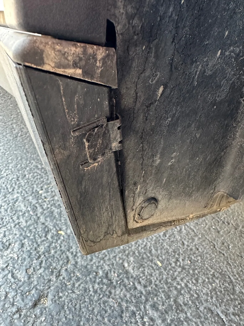

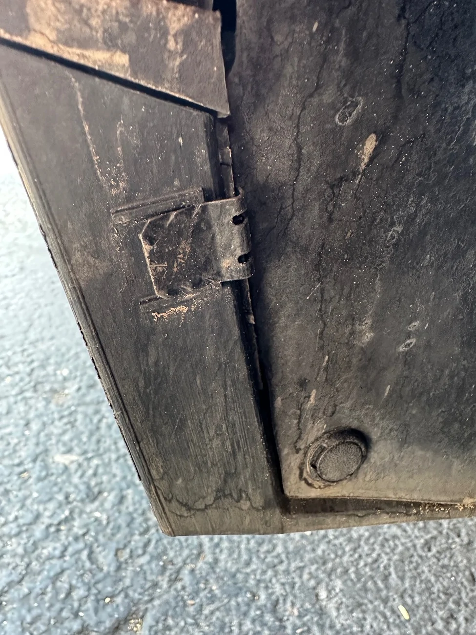

I'm surprised about the latch, I would imagine that would be somehow a screw or something like that.
Its a “clip,” but it works really well. It could be installed with the raised edge of the clip INSIDE and hidden (the opposing side of the clip is flat), and that might aesthetically looks “smoother,” but I knew that it would be harder to remove in that orientation. And now that I am getting the OEM rocksliders these will be coming off.

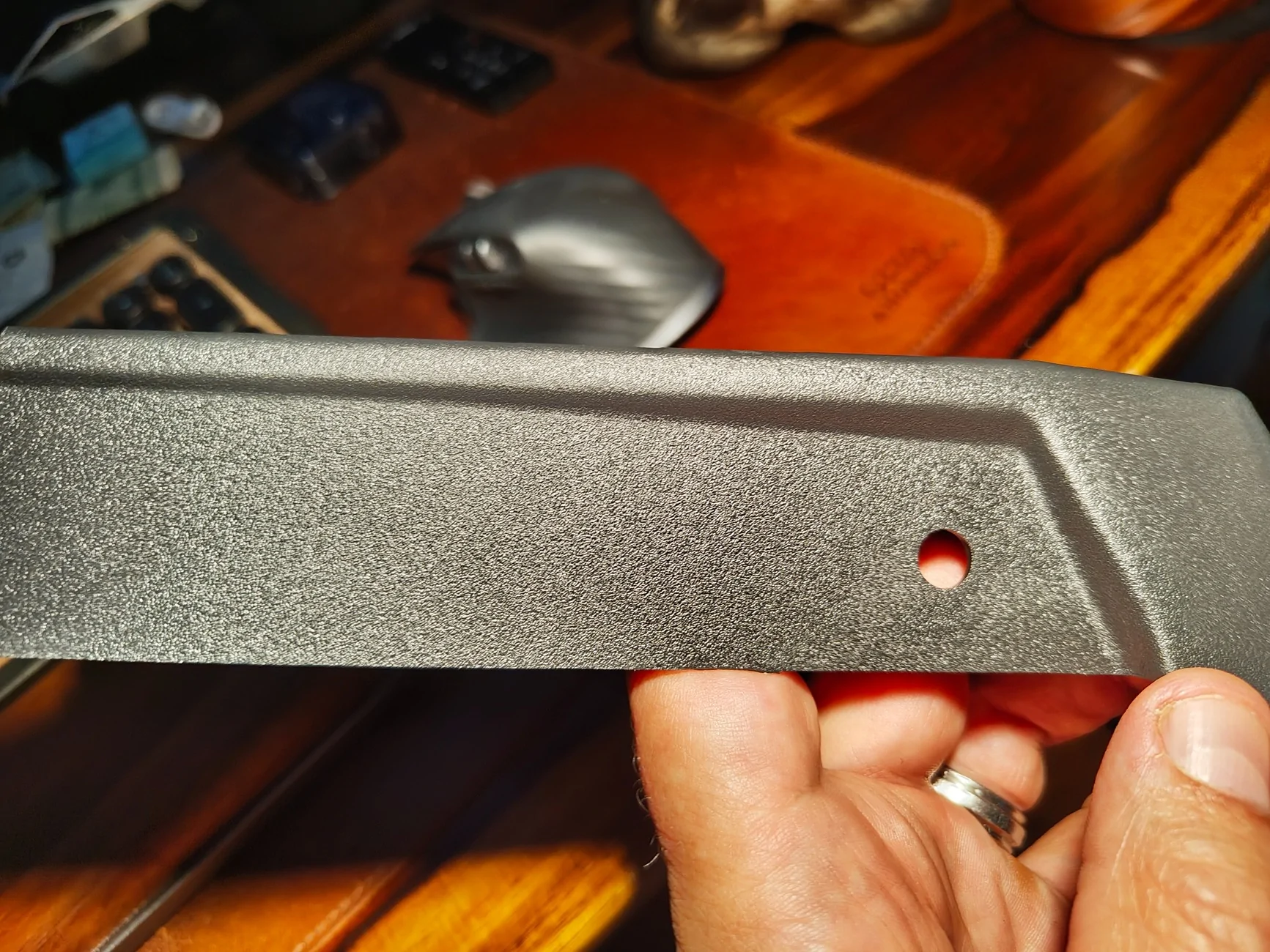

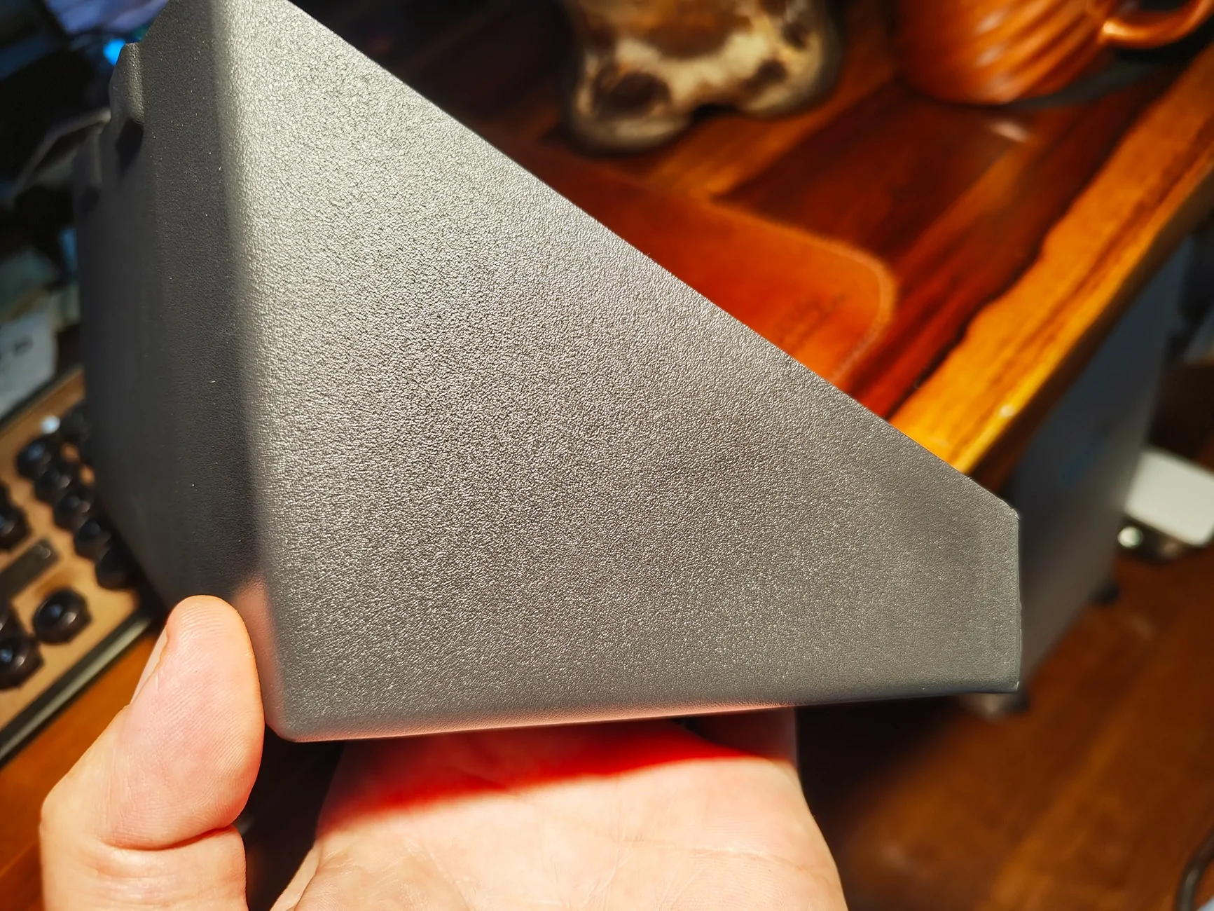

Just in case anyone else is interested, I found them on Amazon from (BestEvMod) and they are incredible. They are either stamped or injection, but they are NOT 3D. On top of that, only $49.99 and ships free. Also includes the tools and the rivets so to speak. I'll post pictures once installed.

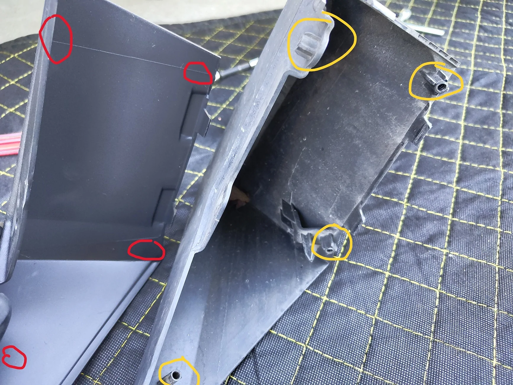

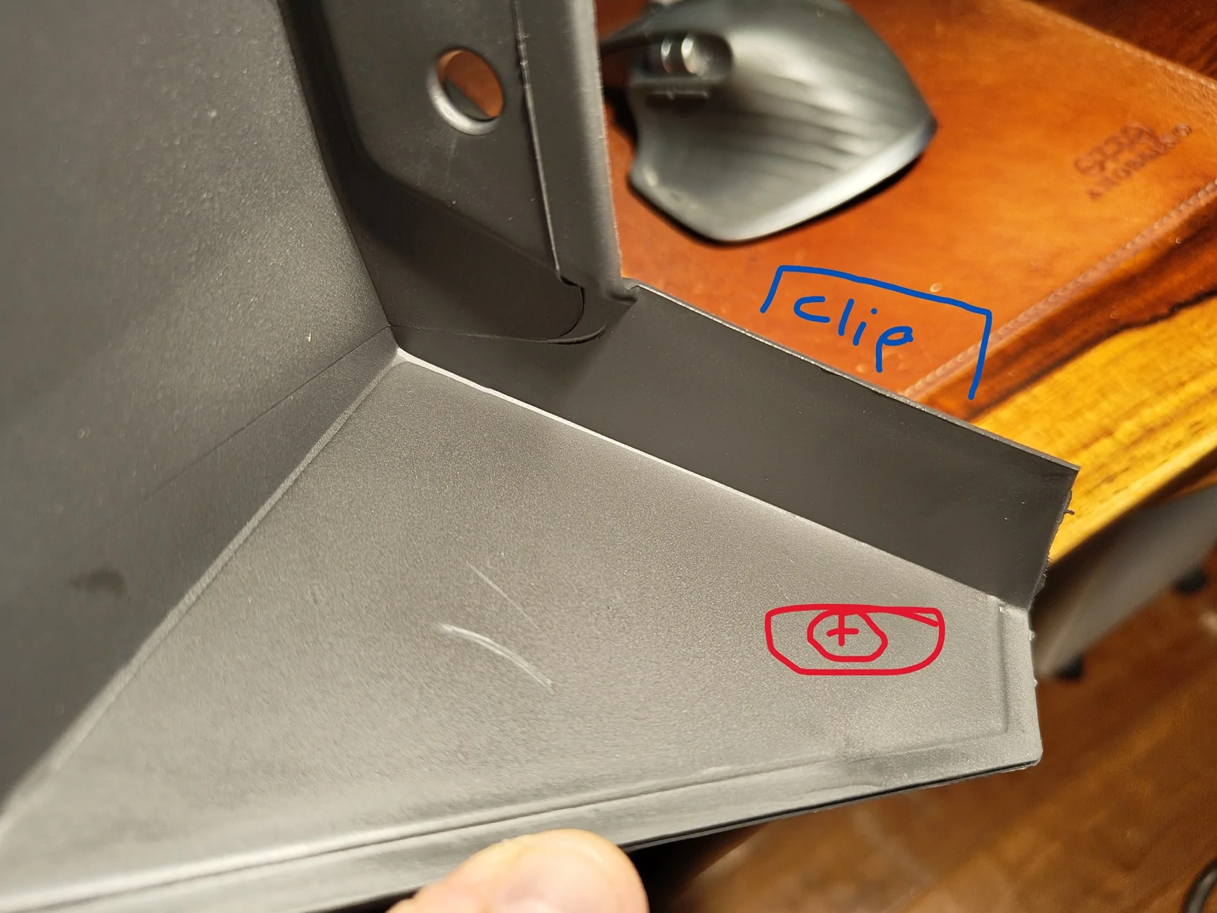

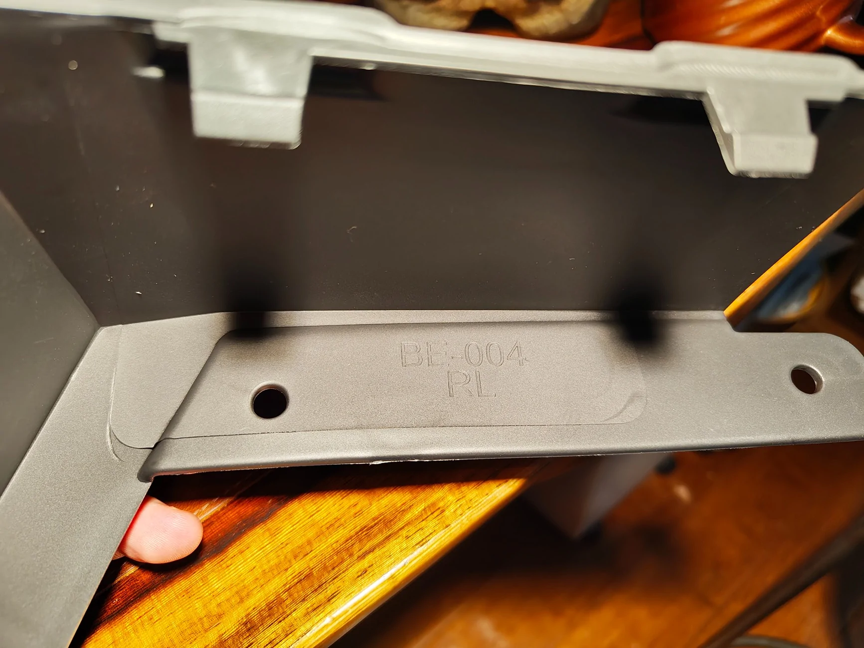

I have an update on the fairing delete and how it could be updated. I rather see this update than the tools coming with the pack.
The main flaw and why the dumb clip is needed is because they don't come with the 4 screws that are on the OEM fairings. I would rather see a price increase and no tools with these changes. See pictures.
