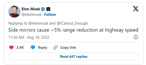

I wouldn't take those results too seriously. That particular wind tunnel is quite a bit too small to measure something as large as the Cybertruck, especially the difference between mirrors/no mirrors (because the mirrors are out in the turbulent air near the periphery of the tunnel). The tunnel has to be big enough that the walls aren't impacting the results.
using a smoke wand doesn't give you the whole picture. it shows a tiny area's impact but a lot of the drag is what is happening feet away from the body.
I might remove my mirrors but I would expect the drag reduction to be such a small reduction as to be invisible.

At highway speeds the energy consumption reduction of removing the mirrors would be easily noticed by people who look at their efficiency numbers.
That said, I won't be removing my mirrors because the Cybertruck already has considerably more range than I need or use.
