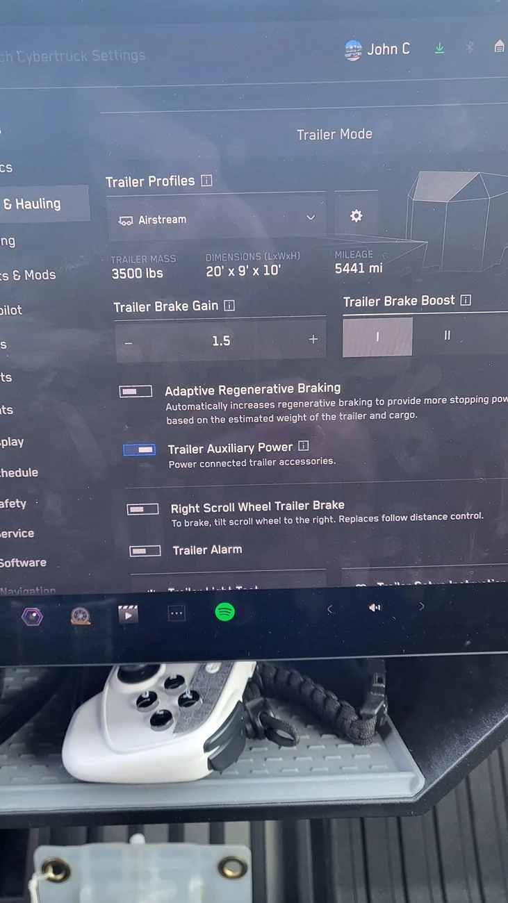

Very curious, when only connecting to Aux, does it show a trailer connected on the screen?

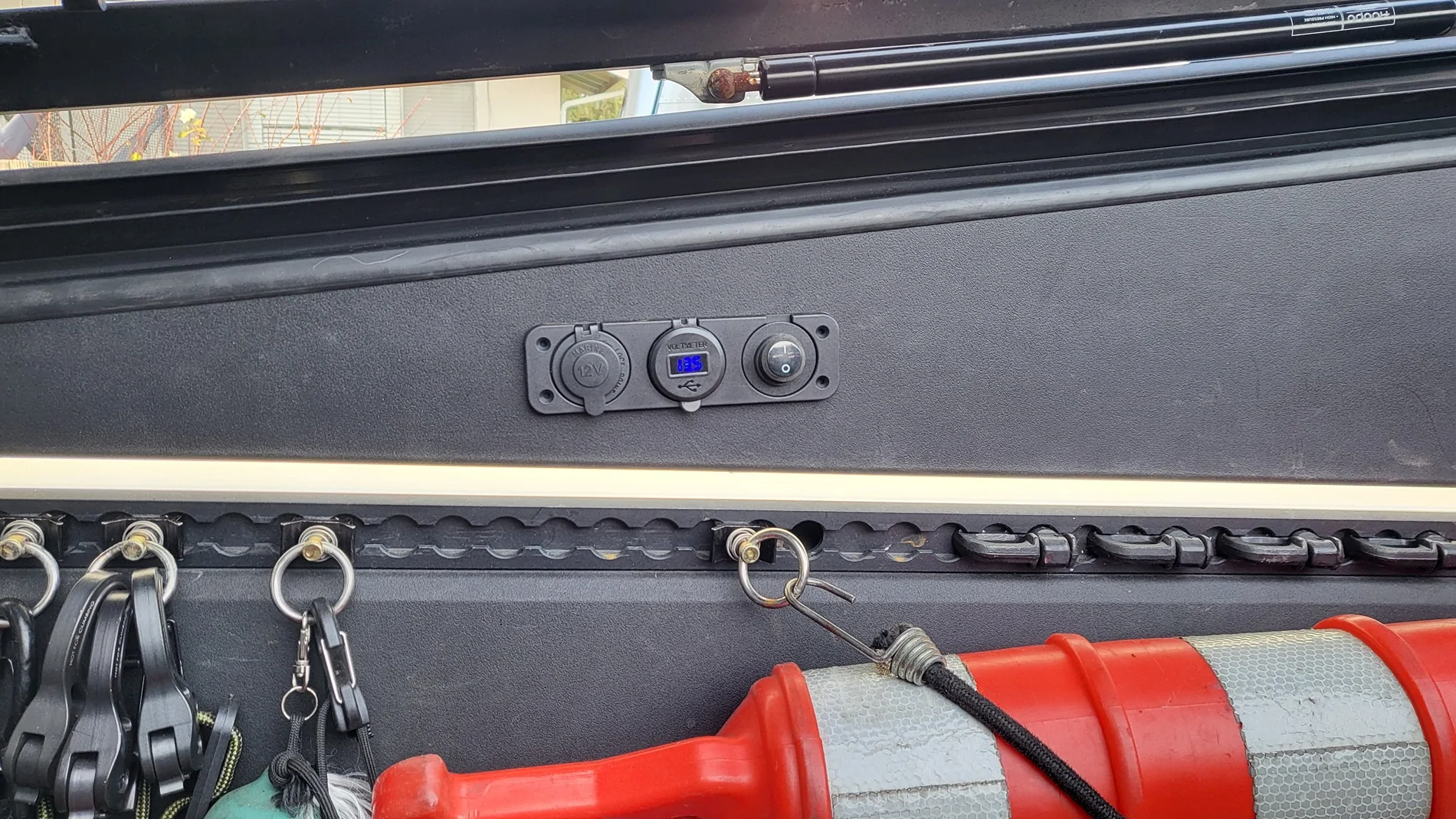

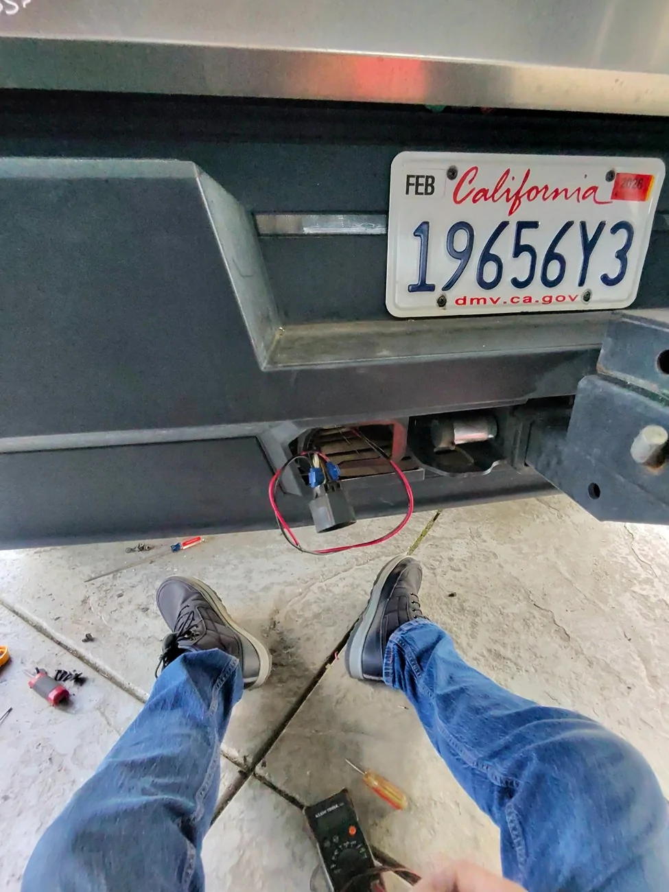

I tapped into the 12 volt auxiliary which you can control by the touch screen Trailer section and mounted an auxiliary panel with USB C and cig lighter port. Works great!!
No, and you can control auxiliary power via Trailer function and it will only give power when it is selected on the screen.

Wait - you mounted a 12-volt and a USB port in your bed?
