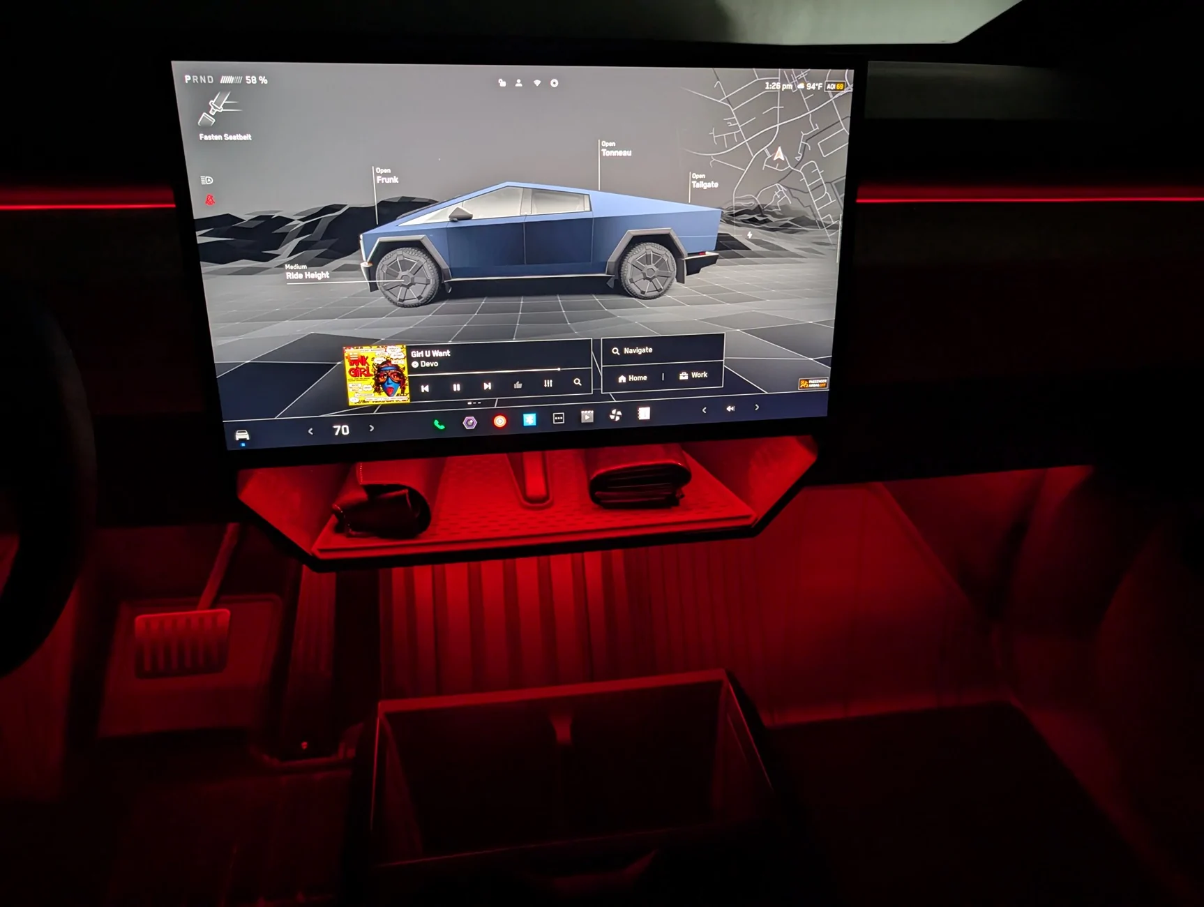

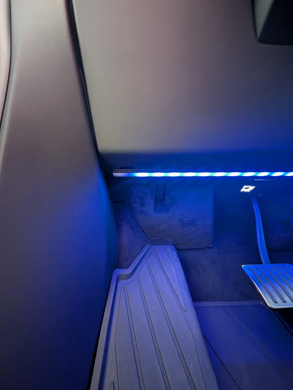

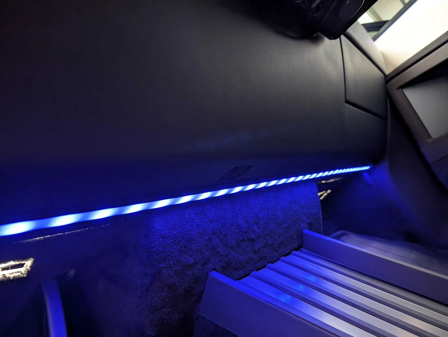

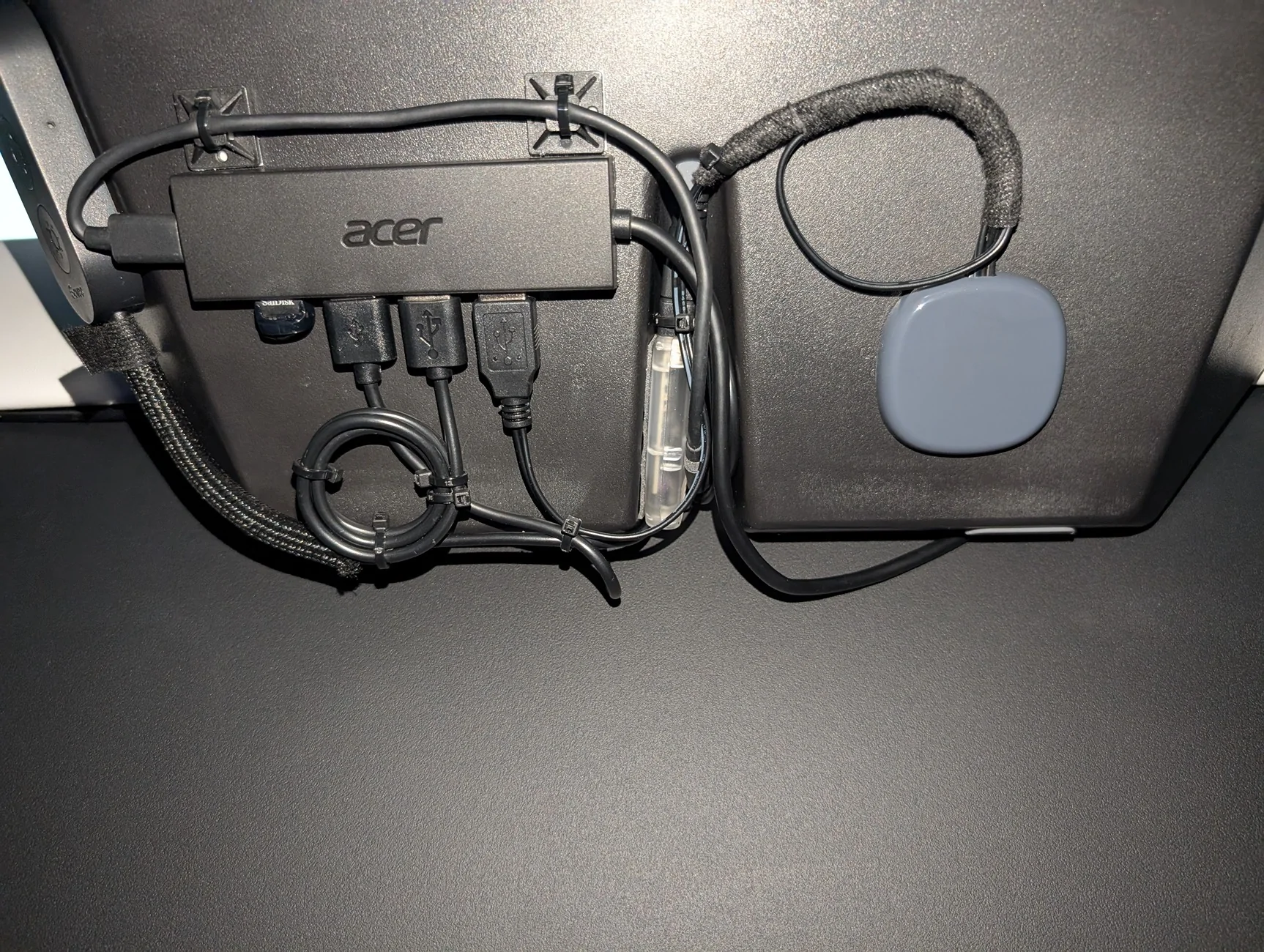

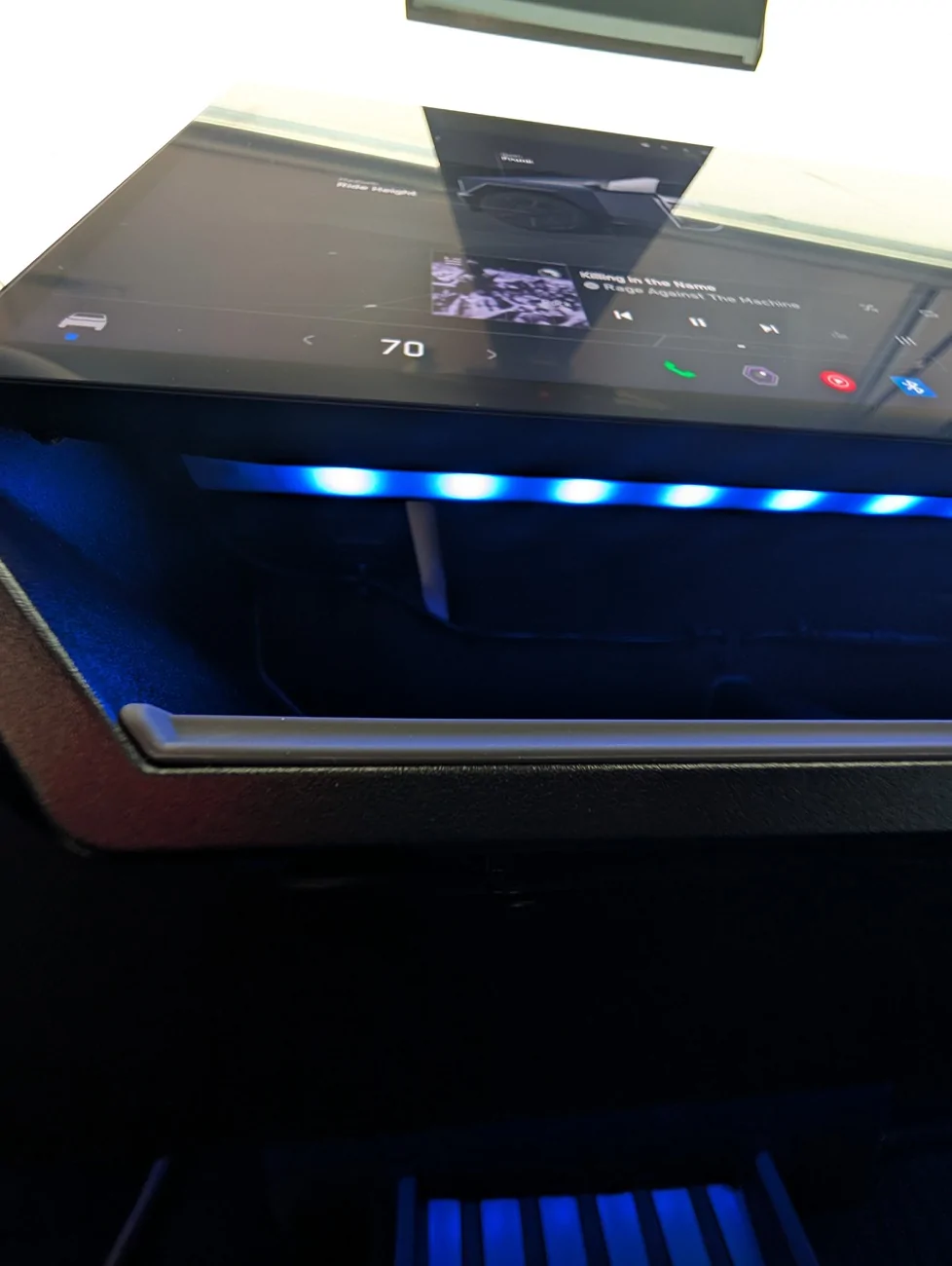

I wanted more lights in the cabin so I used the Govee USB powered LED strip lights intended for a small TV. These are cuttable so I had the idea to light up the storage box as well. I was able to use the aluminum channel in the box and the entire length of the footwell. I threw away about 6" of the excess strip light. The controller is mounted via pre installed adhesive tape to the side of the storage box. Since its black you can barely see it. Only the driver can see a portion of it. The underside of the storage box is where I mounted a USB hub to power it and other things + my flash drive 512GB. The hub has a 2' cord which is perfect to reach the USB port in the glove box. The white dash trim is perfect to hide the cord and is not visible at all.
