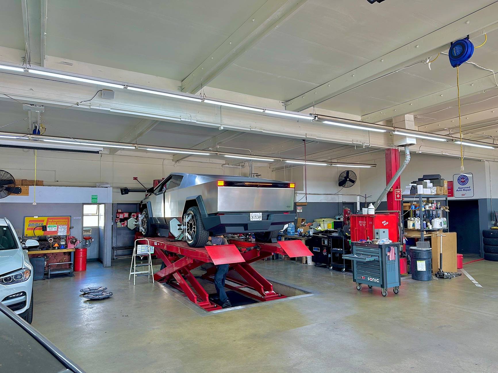

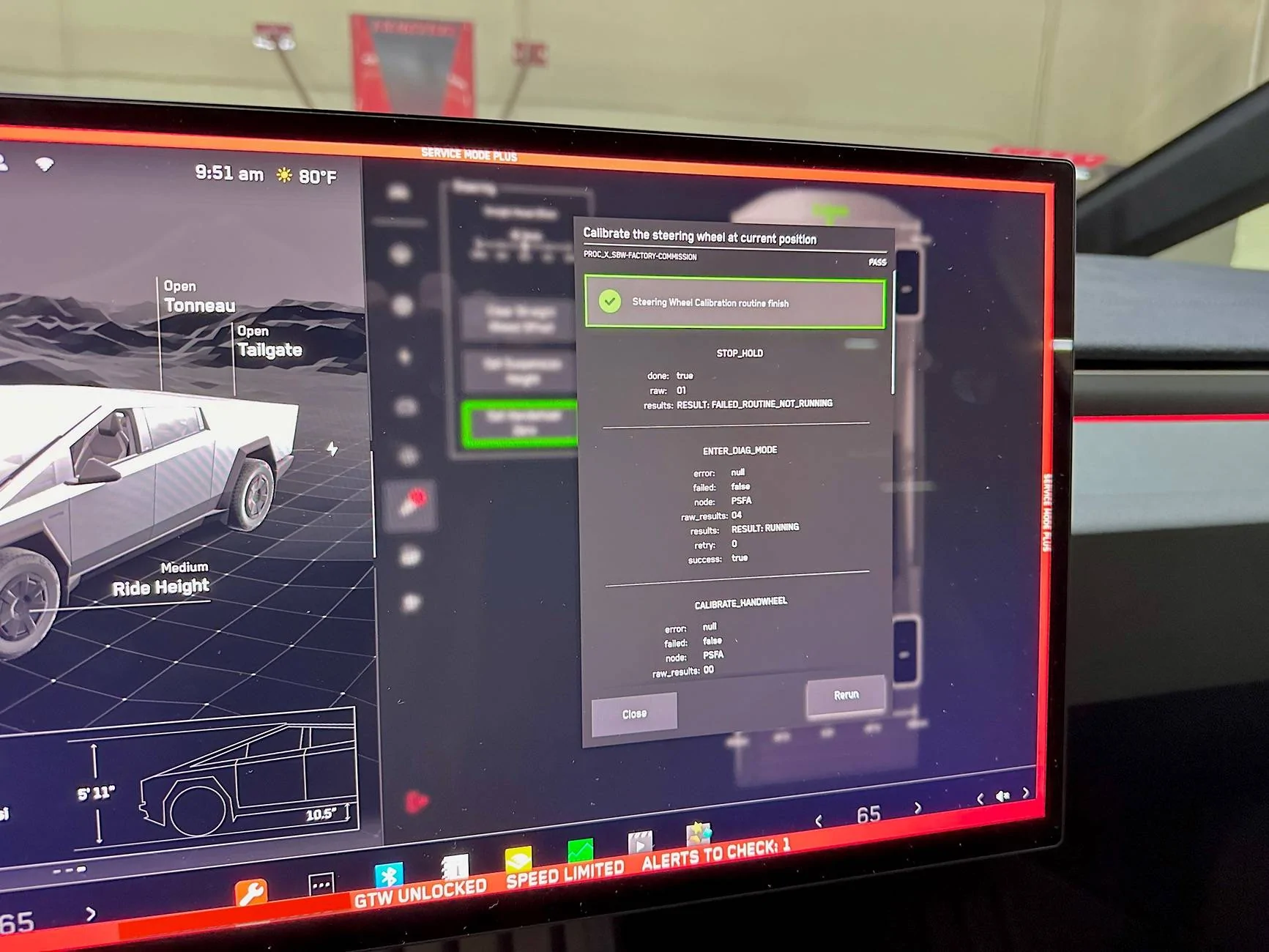

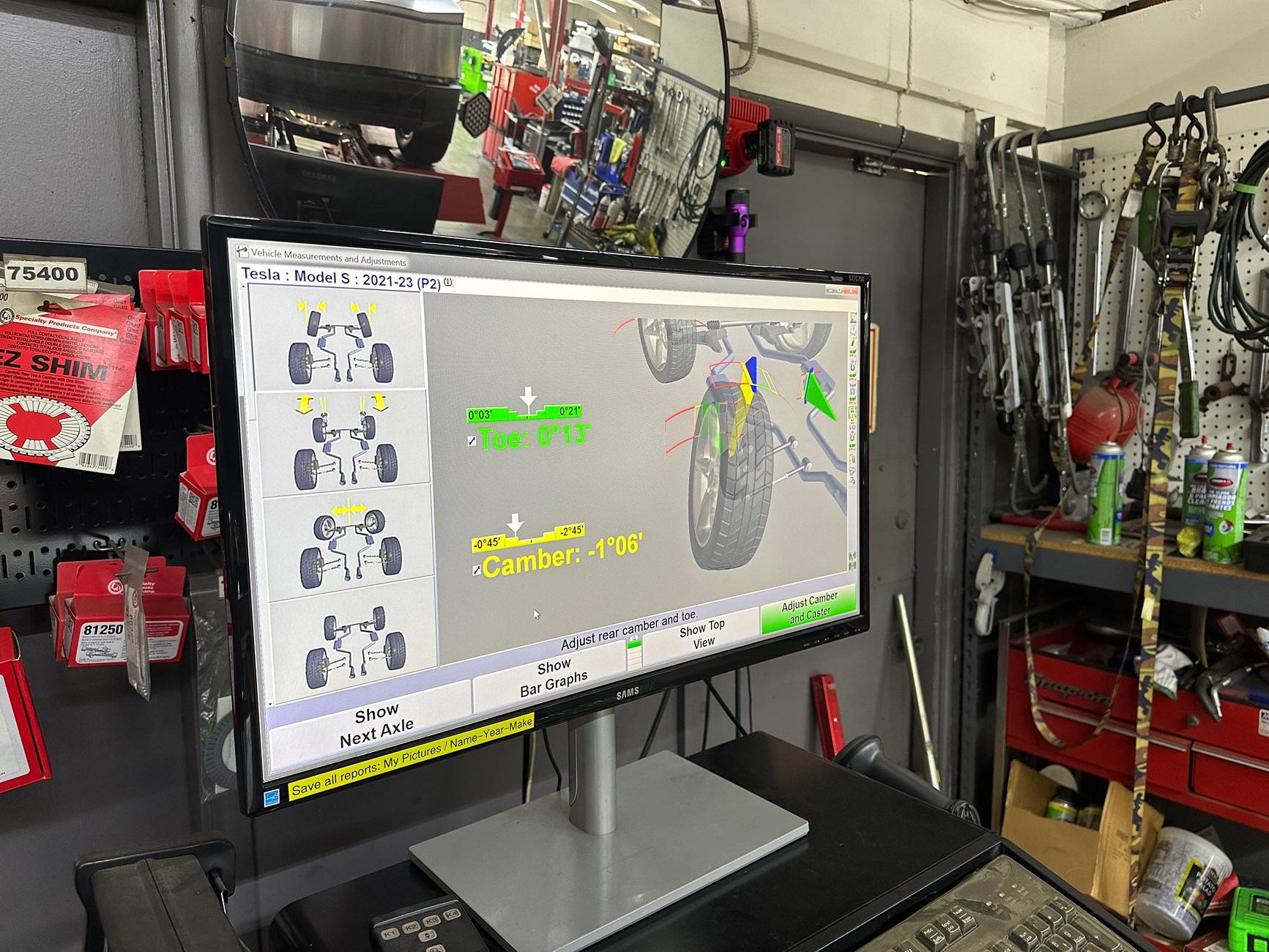

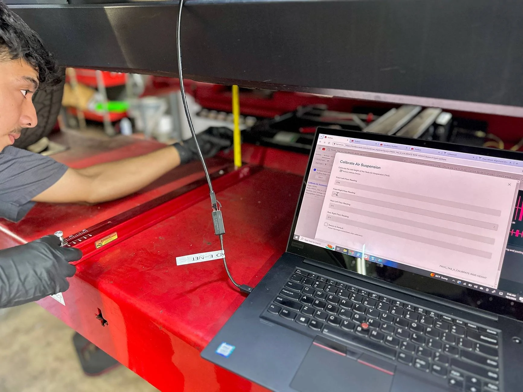

In order to properly align, the shop will need Toolbox so that they can place the vehicle in Service Mode+. The rear steering gear will need to be placed into a center/lock mode so that a caster sweep can be performed. I aligned my truck at <200 mi and it was off a small amount and most new vehicles I have found are never set up for ideal tire wear.
It is also possible to place the vehicle in SM+ remotely but the vehicle will need to be in regular service mode 1st.
All of Tesla’s service information is available for free on line. For shops that report that the specs are not in their machines, what they will need to do is pick a Model S from the menu and then carefully follow the instructions Which also include a ride height calibration check.
Tesla Cybertruck Wheel Alignment Locations? IMG_5815
Tesla Cybertruck Wheel Alignment Locations? IMG_5814
Tesla Cybertruck Wheel Alignment Locations? IMG_5821
Tesla Cybertruck Wheel Alignment Locations? IMG_5822

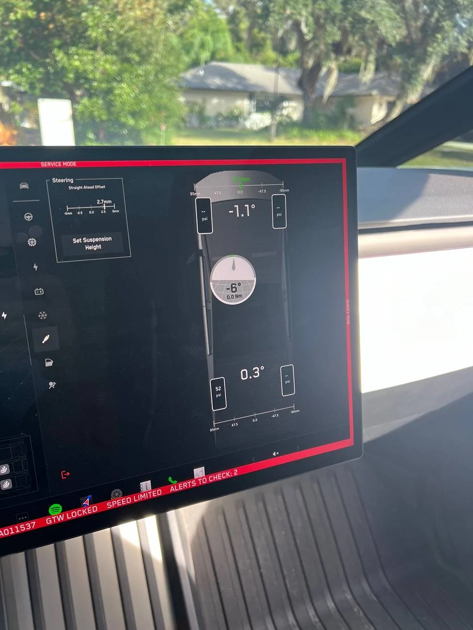

I'm getting a Service Required notification on the screen for wheel alignment, plus it's noticeably pulling to the right. Shaking is more likely tire balance than wheel alignment.
  • Like
Reactions: REM
TorqMonstr
Scott
Oct 26, 2024
68
124
Beast, M3, MY
Auto Mechanic
go into service mode check the alignment offset and let us know what the numbers are.

Thoughts?
