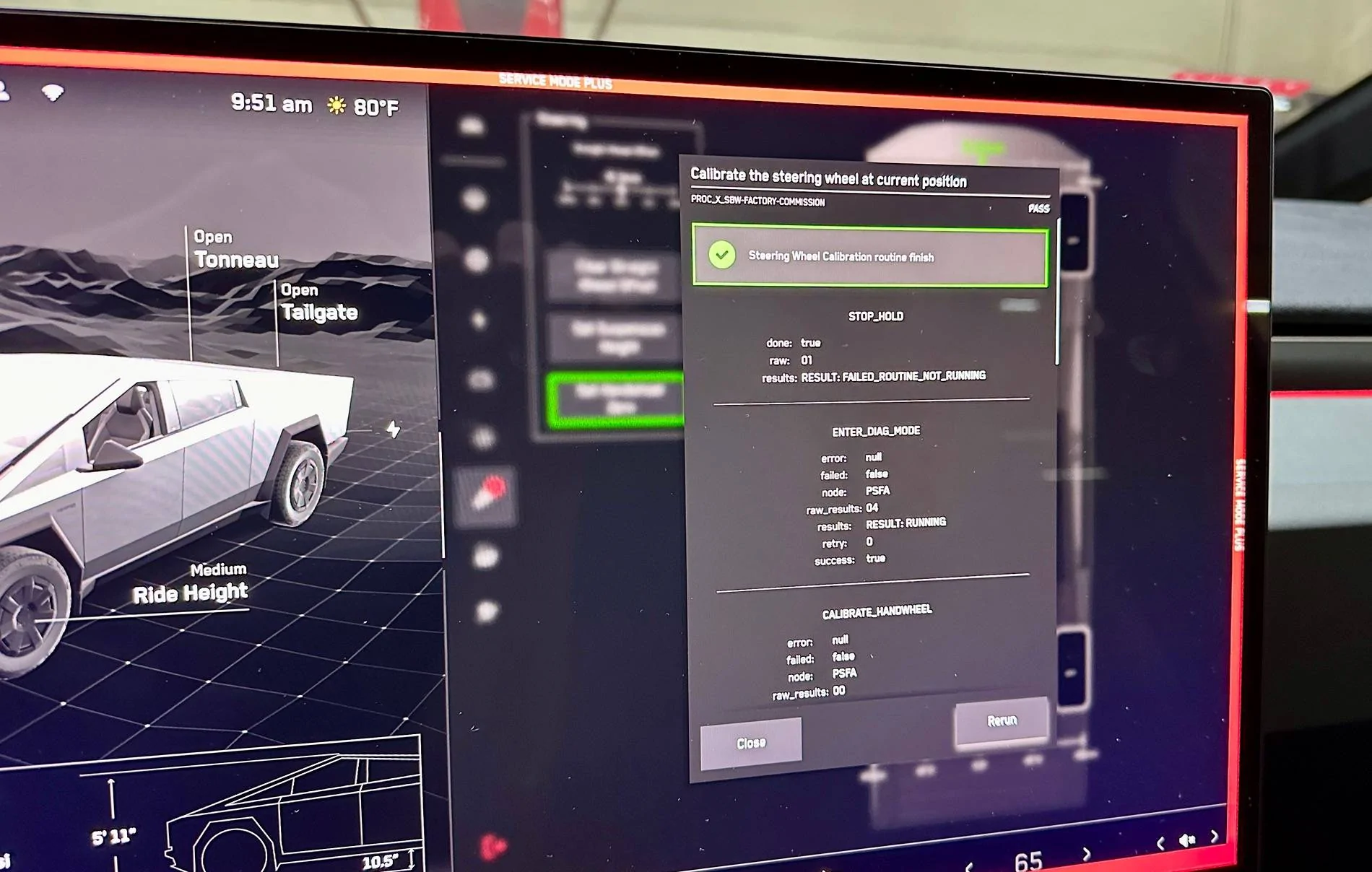

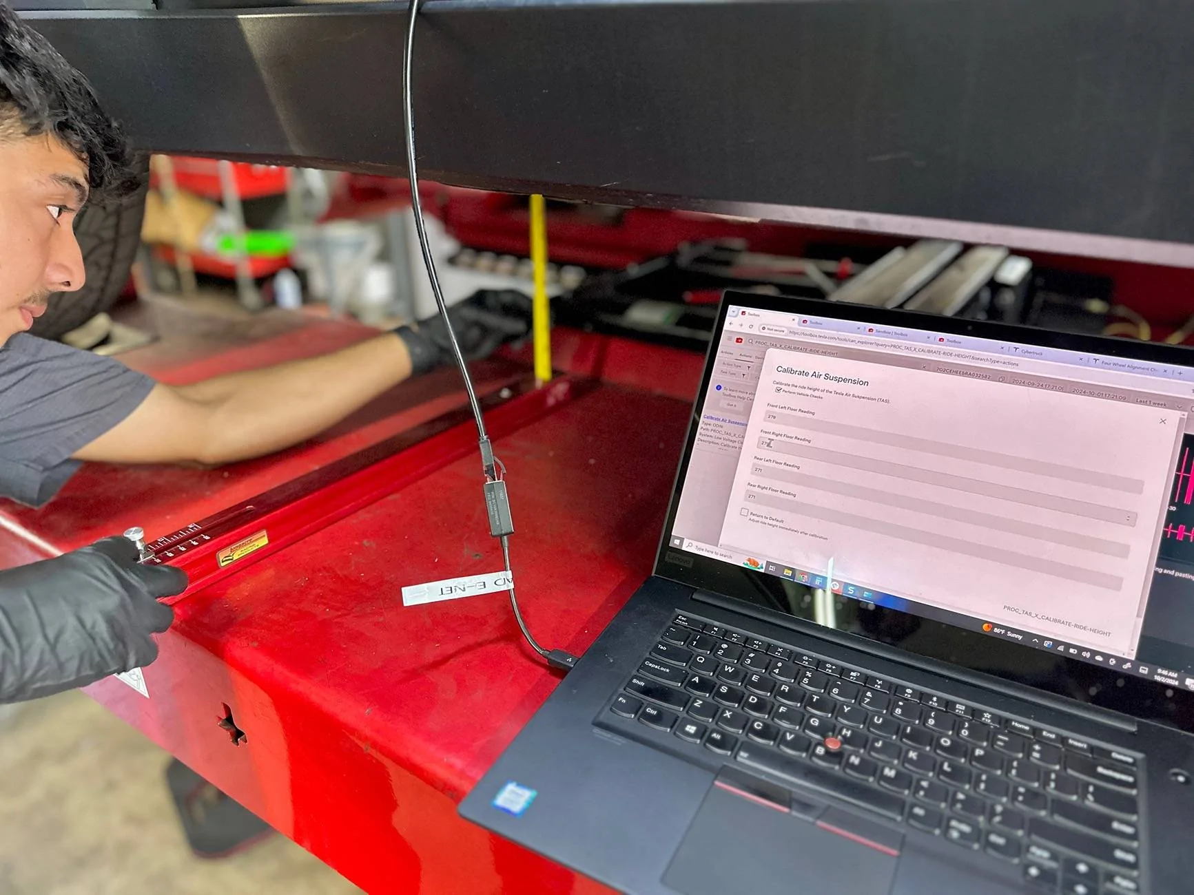

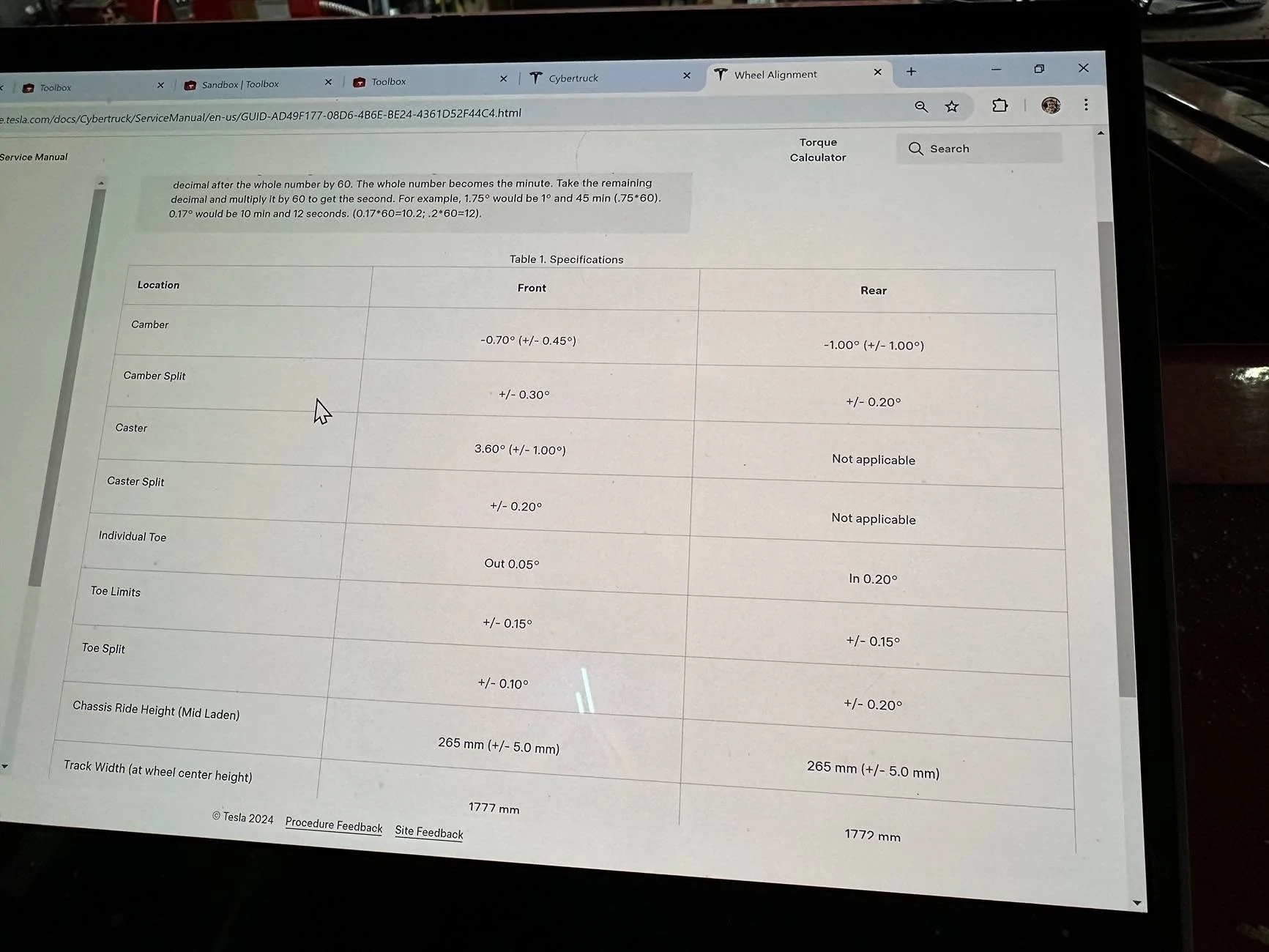

My vehicle wasn’t aligned to ideal values from the factory. Cheap insurance to have it checked but the alignment procedure is specific and the shop performing these steps need to be able to carry them out appropriately. If it’s off then getting the values correct can extend tire life.
