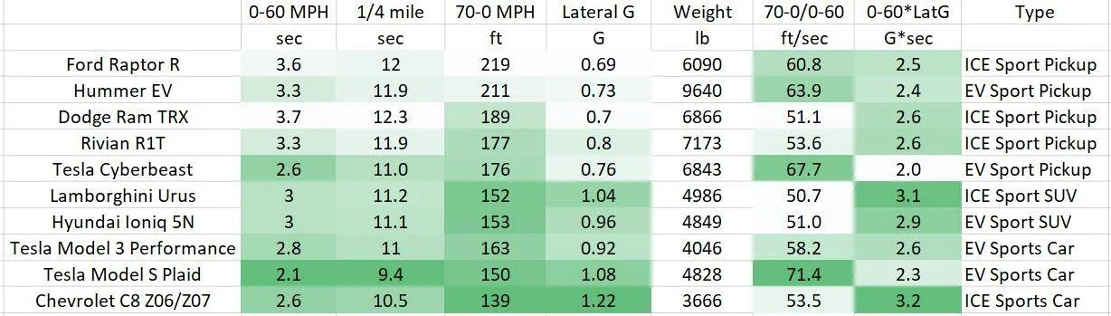

I've seen a number of posts describing the CyberTruck as a sports car in various ways. I thought it worth putting up a few numbers to show that as currently configured, the CyberTruck is definitely not a sports car and in fact may be one of the most imbalanced vehicles on the road today in terms of performance envelope.
Considering your post on the whole, what stands out to me is that it's very unlikely you own or have driven a Cybertruck. First of all, the Cybertruck is only a sports car relative to other pickup trucks (and most of them have far lower payload capacities). None of the vehicles on your list can pack the payload the Cybertruck does with ease. Of course it's not going to compare well with a hot blooded sports car like the C8 Corvette. I'm surprised you even put it on the list! It shows a lack of understanding of why people say the Cybertruck drives like a sports car (it's relative to other pickup trucks).
Comparing to its peer group (high performance off-road pickups), the CyberTruck shows how well Tesla is doing, taking the shortest distance to stop from 70, having the quickest 0-60 and 1/4, nearly the lightest overall weight and second best on cornering performance. However, the overperformance on positive acceleration is definitely not matched by overperformance on braking or cornering which is easy to see from the last two columns which attempt to balance the two factors (braking over accelerating in the first column and accelerating times cornering in the second). In the first column, lower numbers are more balanced and in the second, higher numbers are more balanced. Cybertruck is the worst of the group on both metrics, especially cornering to accelerating balance and in fact is the worst of the entire table in column 2 and the second worst in column 1 (Model S Plaid is the worst in column 1).
Your idea of what provides "balance" is misguided. Historically, when someone says a sporting car is very balanced, they refer to to the handling, they are saying it has neither heavy understeer or oversteer. However, the concept you introduce (out of thin air) actually penalizes a car for having better acceleration. What matters for braking performance is not how fast a car accelerates, but what speed it can reach (a metric that you conspicuously left out of your made up "balance" metric). A skilled driver is never forced to use acceleration that is too much for conditions so there is zero downside to having more than you need in any situation. Enough time spent on this misguided "balance" concept. It's meaningless.
This chart is at the heart of your misquided notion that the Cybertruck somehow falls down when it comes to sporty performance. First of all, the skidpad and braking numbers are highly dependent on tires. The Cybertrucks numbers are on All-Terrain tires, yet you are comparing them to numbers returned from vehicles wearing hot-blooded sporting tires, DOT legal racing tires. This is just silly in the extreme.
There are a lot of things that are wrong with this chart. The Model S Plaid is not a Sports Car either, it's a powerful four door sedan, at best, a Sports-Touring Sedan. In any case, the wild assortment of vehicle types included just shows that you fail to understand that when people claim the Cybertruck is like a sports car, it's relative to the class of of vehicle it's actually in, a pickup truck!
I do not own a CyberTruck, nor have I driven one. I have however driven a lot of different vehicles of all different types and aside from the steer by wire (which I am super enthused for) I am fairly certain I know what it feels like to drive the CT. The intent of my discussion was to show the total range of performance possible amongst vehicles on the road and to indicate that the CyberBeast in particular has an unusual performance envelope which is proportionally more in favor of acceleration over deceleration.
I didn't say handling balance. A better choice would have been performance envelope. In any case, the concept is definitely not meaningless. Think about people talking about how terrible drag cars are to drive on the street because they don't turn or stop but they accelerate incredibly well. I've driven a low 8 sec drag car with skinnies on the front, it's bananas! Similarly, when fast AWD vehicles first came out (GMC Typhoon for instance), people had to adjust to the fact the the brakes felt relatively worse because the acceleration was so much increased. Similar things happen to many drivers every year in the winter or the rain, because AWD vehicles still accelerate surprisingly well (usually because people don't use all the acceleration in the dry but do use all of it in the snow) but they don't brake as well as they used to so proportionally it feels worse. It is absolutely true that the CyberBeast accelerates incredibly well but doesn't brake or turn proportionally that well.
The point is to show that vehicles with extreme acceleration performance (ie usually sports cars) have much better brakes than the similarly accelerating CyberBeast.
What people say is the Cybertruck drives like a sports car or is the best driving vehicle I ever owned. I take people's words at face value. If they meant to say relative to an F150, they should say that. You know what assuming makes you right Mr. H?
Please also note that the Urus (and a number of fast SUVs as well as the rate performance pickups like the GMC Cyclone and SVT Ford Lightning) is a large, heavy machine that can tow and haul a lot of stuff (~30% less than the CT) and has much better braking and handling than the CT. This is what I was saying a performance variant of the CT might be like.

I'm not sure why balance is the goal. Excellent acceleration and pretty good braking -- better than the other heavy weights, if I read you chart correctly. Sounds pretty good to me. If I want to buy a heavy weight truck, CB beats the others beats the others hands down. Why would anyone think it should be compared to a sports car? But, hey, I'm all for improvements!
