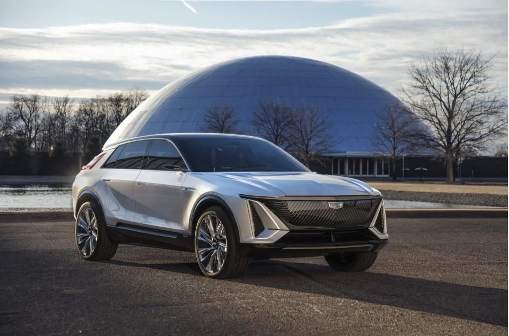

Tesla Cybertruck Will The Cybertruck Be Upgraded From 400 Volt to 800 Volt Battery Architecture ? cadillac-lyriq-concept_100755404_l
Cadillac Lyriq concept
