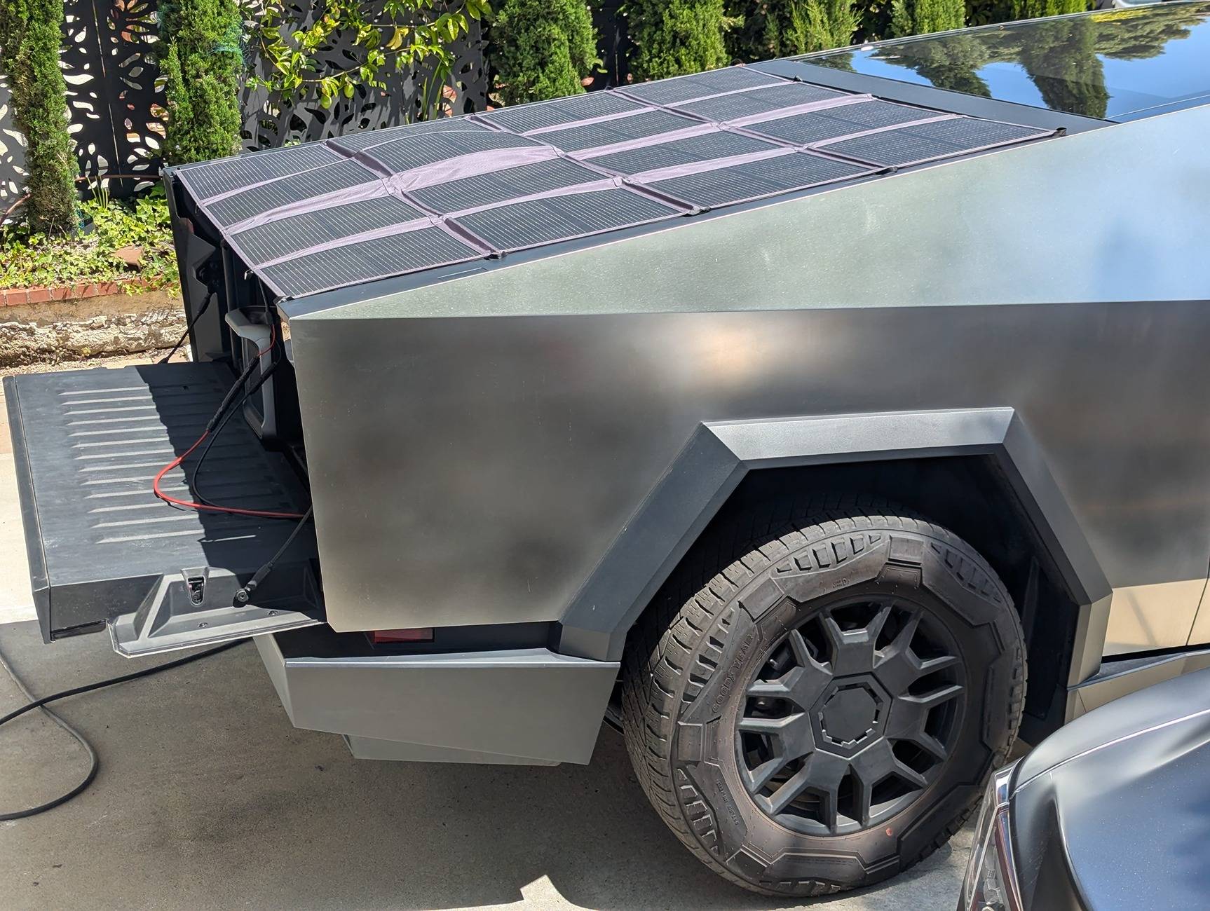

I'm also based in San Diego and picked up a 400W solar blanket that's easy to deploy and fits perfectly over the tonneau cover. It can also be placed over the roof glass or front windshield. That said, having a more permanent solution would definitely be ideal. The EcoFlow solution looks great, I would pick it up if they made it for the CT.

Can you please provide a link to that?
Sure, here is the link:
https://www.renogy.com/renogy-400w-solar-panel-blanket/
They offer a 200W version that’s about half the size, but the 400W panel is a perfect fit for the Cybertruck. In fact, there’s enough space across the Cybertruck to run three 400W panels simultaneously, delivering up to 1.2kW. Add the CybertruckCo 200w hood flexible solar panel and you could potentially reach 1.4kW. At that point, the limiting factor becomes your solar generator/battery capabilities. The solar blanket folds up into a surprisingly small tight package as well.

Nice! Both of those Deltas would easily do the job. Yes, there are 16 loops in total, on the corners and along the edges, that you can use to secure it with carabiners. The magnet idea is clever; I’ll definitely consider trying that too. It has enough heft that I haven’t really needed to secure it yet, but there will definitely be times when it's necessary.
I’m with you, having a more permanent solution would be ideal. I was really hoping the solar tonneau would become a reality, but maybe we'll see something like the EcoFlow’s solution tailored for the CT.
