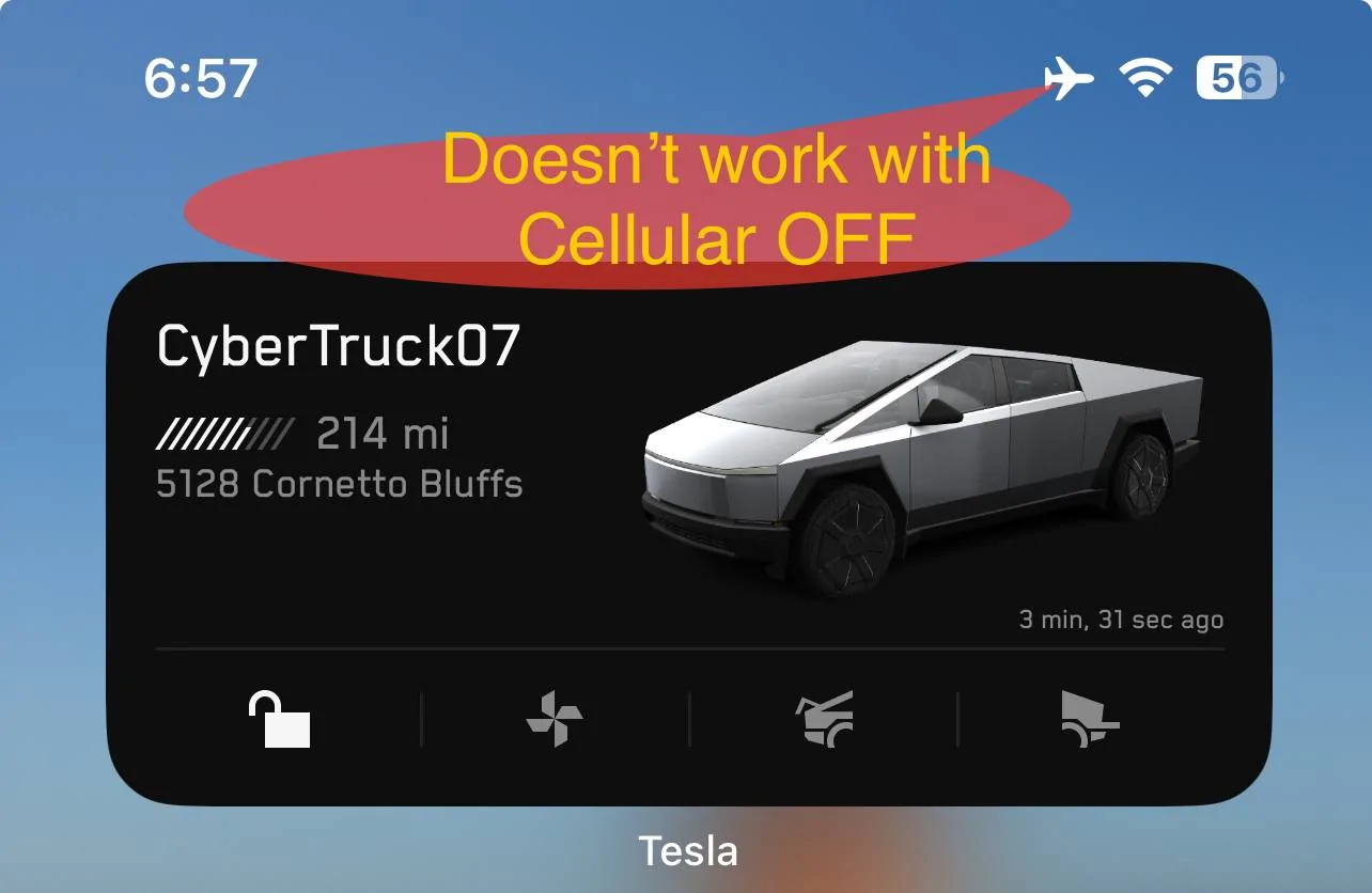

Never mind, the “Hands-Free Frunk” feature works fine on V2024.32.20 release. It is in a gray area whether it’s an operator’s error or bug(?). It is not functional with Cellular OFF (or in ‘Airplane mode’ in other word) as in this photo (which my mobile uses only WiFi in my home).
Tesla Cybertruck “Hands-Free Frunk” feature not working IMG_1642
With the cellular ON, it works properly. It should work fine with using WiFi without solely depending on cellular connectivity, should it?

It's not using cellular nor WiFi, it's using UWB.
Airplane Mode On is NOT cellular off, it's ALL RF off. Which includes UWB.
The use of UWB is why it only works on some phones at this time.

Thanks for clarification.
Using the UWB (Ultra-wideband) is suitable since its location precision is pretty accurate (in centimeter tolerance).
