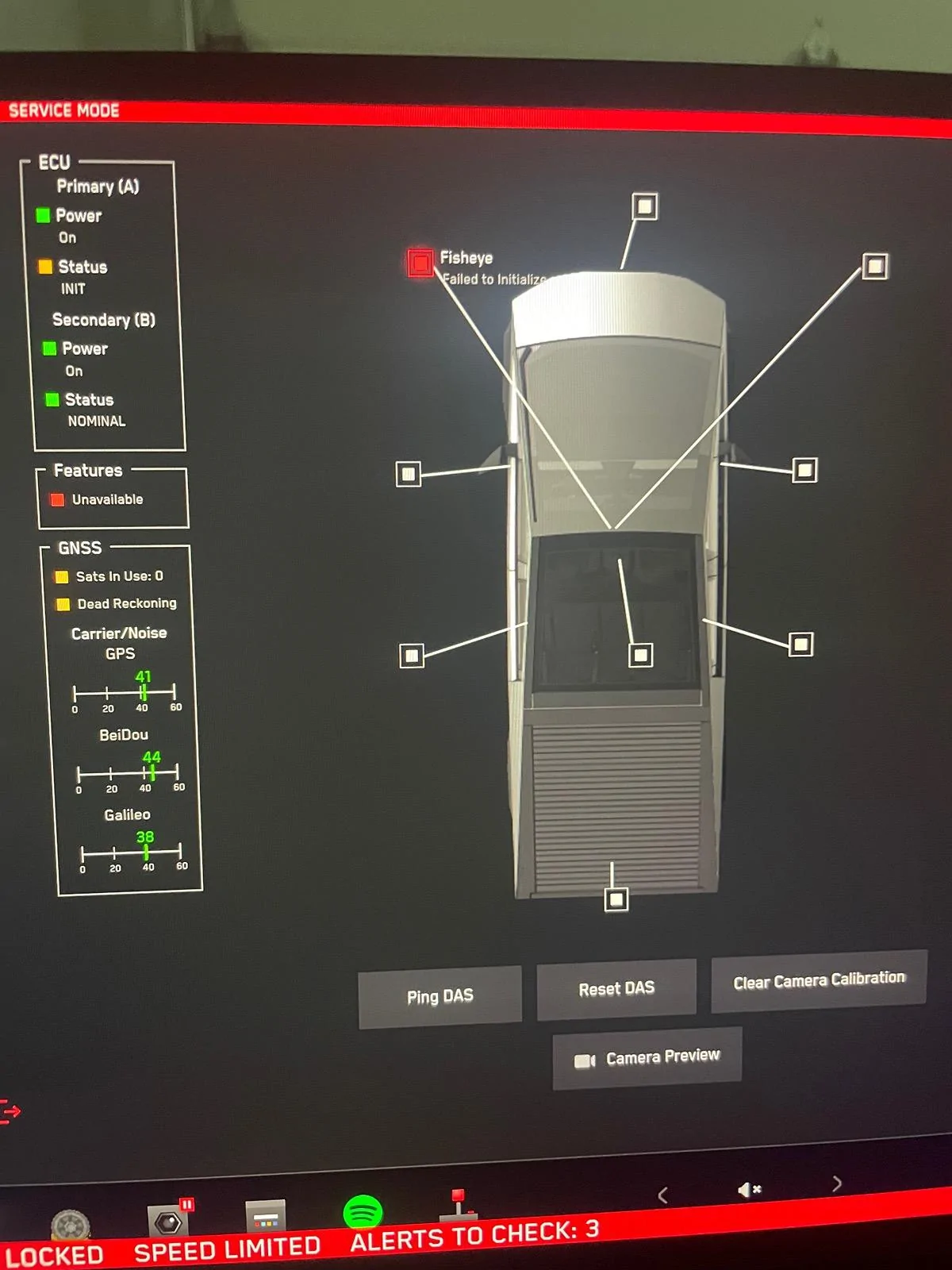

You can inspect and calibrate the cameras in the Service Menu.
Settings -> Software -> Hold "Cybertruck" logo for 5 secs -> Password "service"

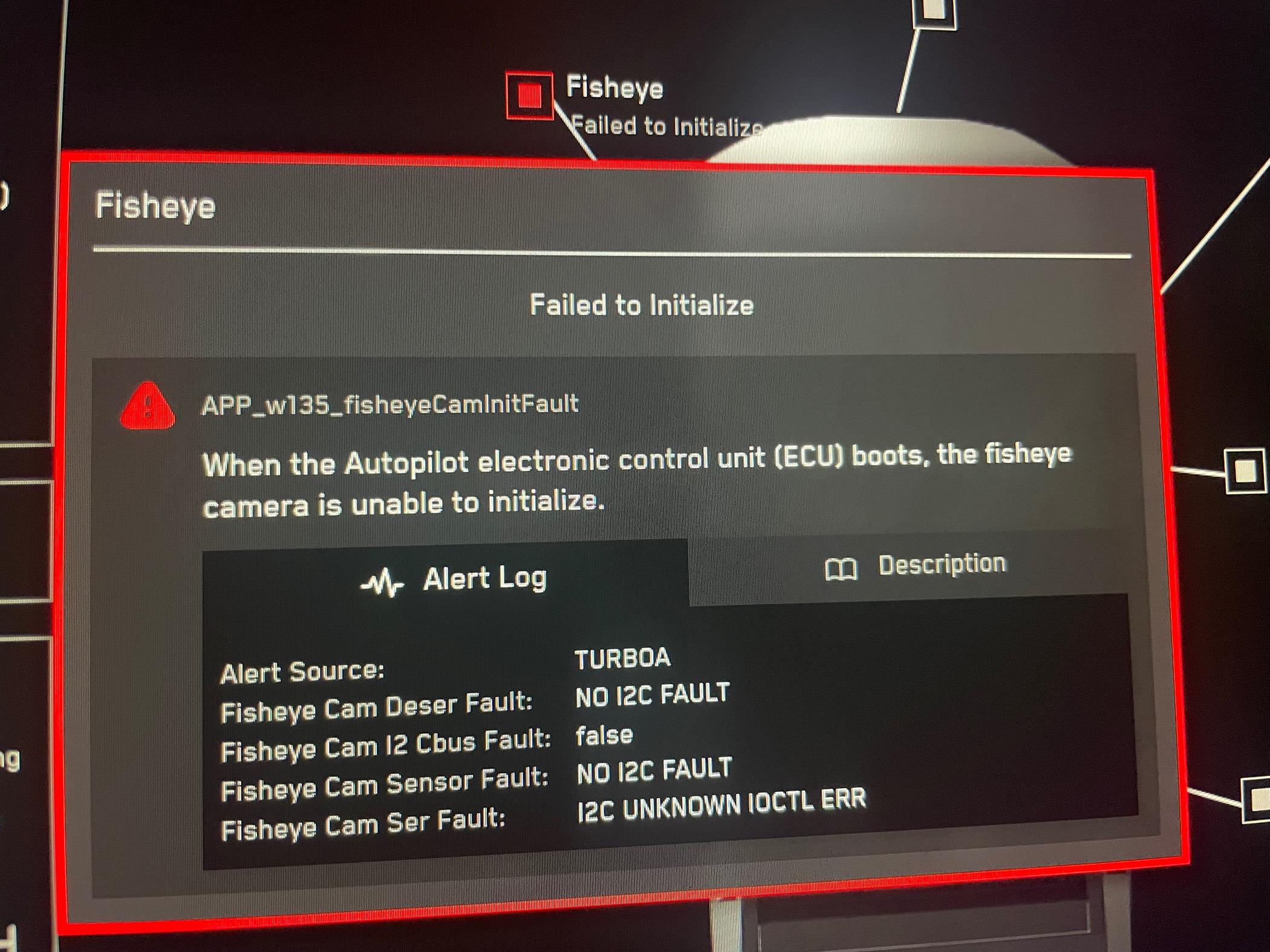

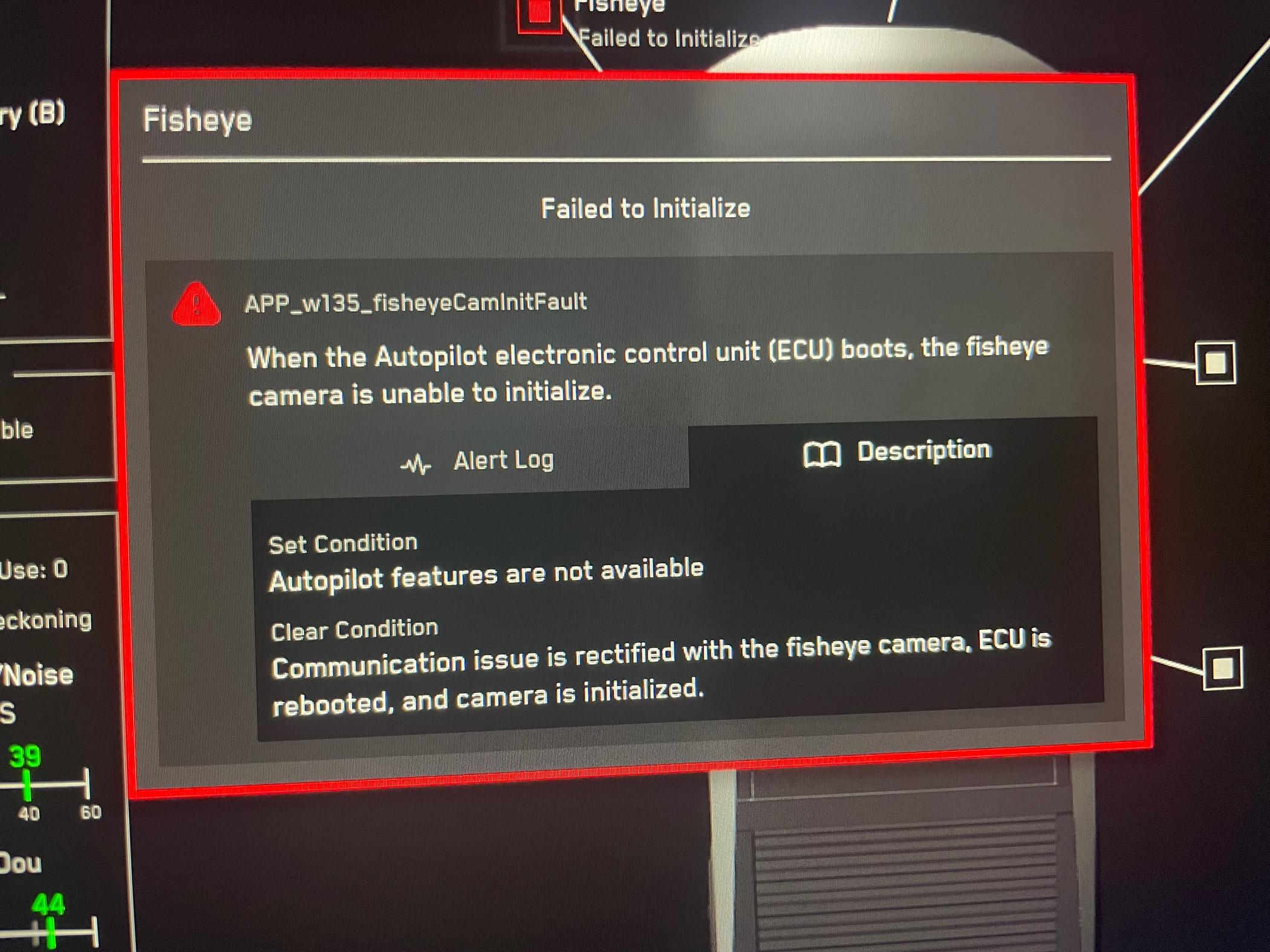

Thanks for the quick reply. There’s definitely a problem… See attached images.
My fisheye camera has failed to initialize
Any suggestions? Or just wait for my Tesla service visit?

I have the same issue with my Cybertruck and have scheduled a service appointment to have Tesla look at it. I've tried the "Clear Calibration" several times as well as the reboot on the system and nothing resolves the issue. I also dropped into a Tesla service center to see if they could quickly take a look at it for me and the answer was "NO".

Wouldn't be surprised if they replace the camera.

I had this issue and waited a few weeks to get in to service. They fixed it the same day. Replaced the front bumper camera. Then today just maybe 5 or 6 trips in total since the fix, it gave me the same alert regarding camera calibration. I saw in this thread how to access the service menu so I’ll look at that, but I’ll be scheduling with service again.

I have the same exact problem of no calibration, but in my service menu, the ECU is completely without power
