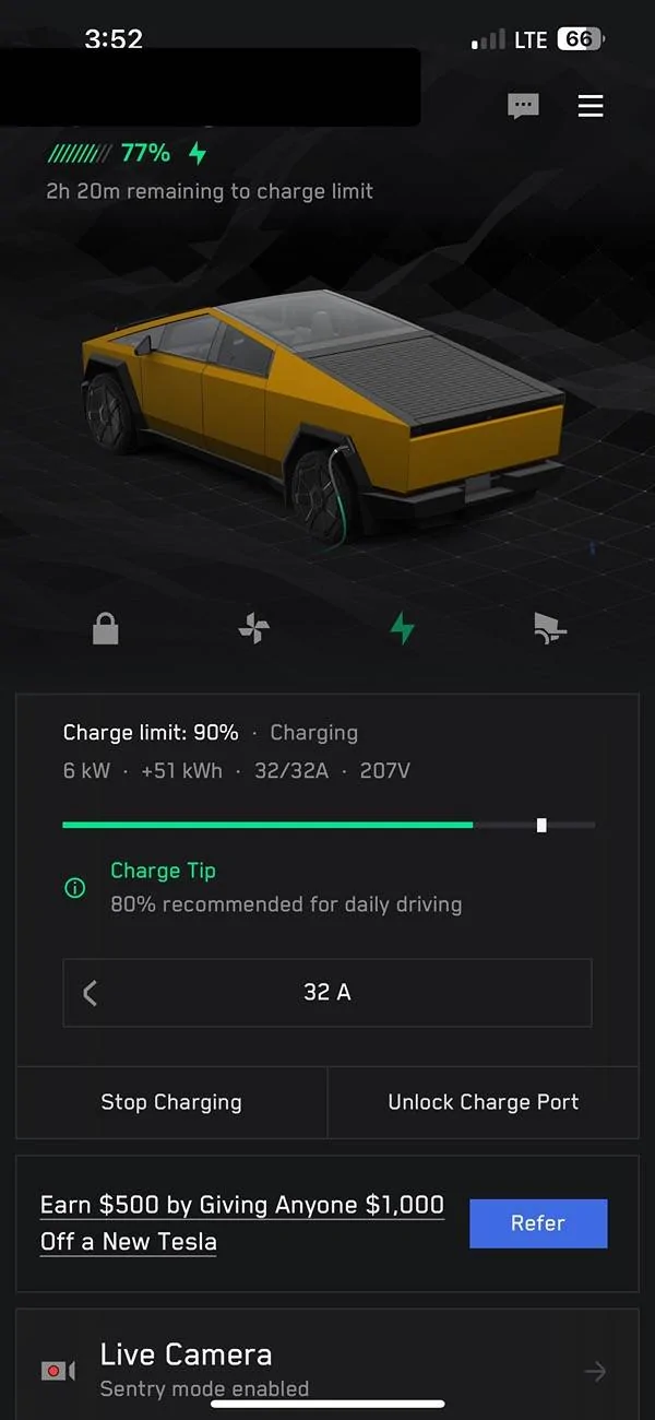

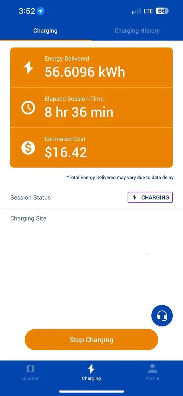

Charged at work yesterday w/ J1772 adapter. Chargepoint App shows 56kwh delivered vs Cybertruck at 51kwh.
10% seems excessive to me. What are others seeing?
Tesla Cybertruck 10% charging transmission loss via J1772? IMG_3999
Tesla Cybertruck 10% charging transmission loss via J1772? IMG_3998

Did you have Sentry Mode on? Cabin overheat protection? In the app it will not show you the juice used for other things like that. Likely just phantom drain. See things like that when parked at the airport.
5kwh / 8.6 hours = 581 Watt loss/ drain
Assuming 95% charging efficency:
56 * 5% = 2.8 kW
2.2 kW / 8.6 = 256 watt other drain
Seems reasonable

Also, the app adjusts the charge energy to the net amount, including any vehicle usage after charging. So the app reported kWh decreases over time.
Not super relevant in this case, but interesting at home with hours of idle time.
