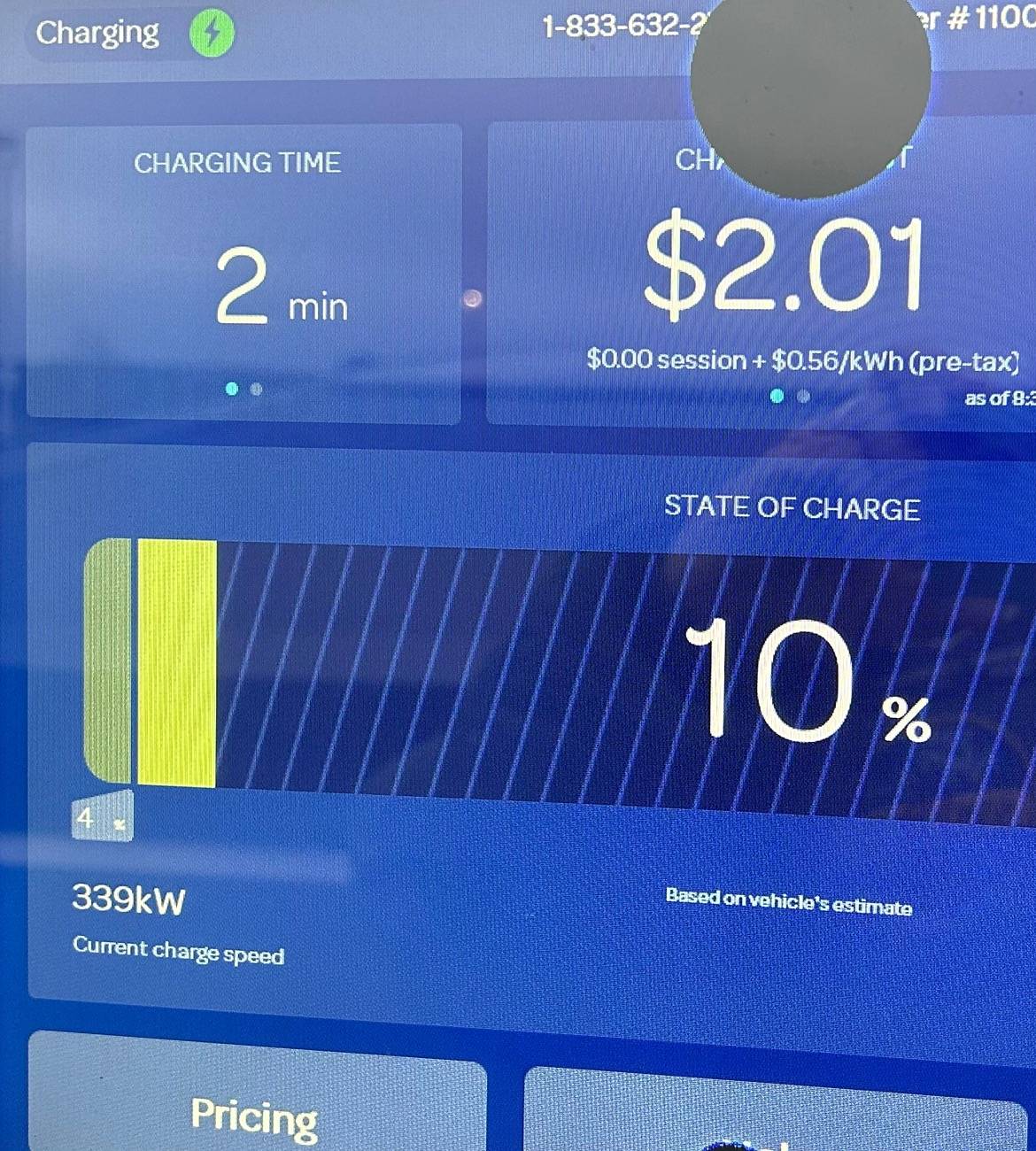

Would be nice to see if anyone can pull 350+ kw from low SOC from any of these adapters. I finally got mine to work at an EA station after having trouble with a chargepoint station but I couldn’t test speed since I was at high SOC.
I tested my A2Z CCS1 to NACS Cybertruck adapter for the second time today. It was 43 degrees F. The battery was preconditioned and I started with a 4% SOC at a 350 kW electrify America charger. Charge quickly went up to 359 kW charge and when very fast. Pictures attached. All worked great.
Nice! Thanks for the report. Where is that charger located?
Gaylord Michigan is where I charge at. I would only recommend the A2Z adapter as it is the only Cybertruck CCS1 adapter that is designed to properly handle up to 1000 volts.
