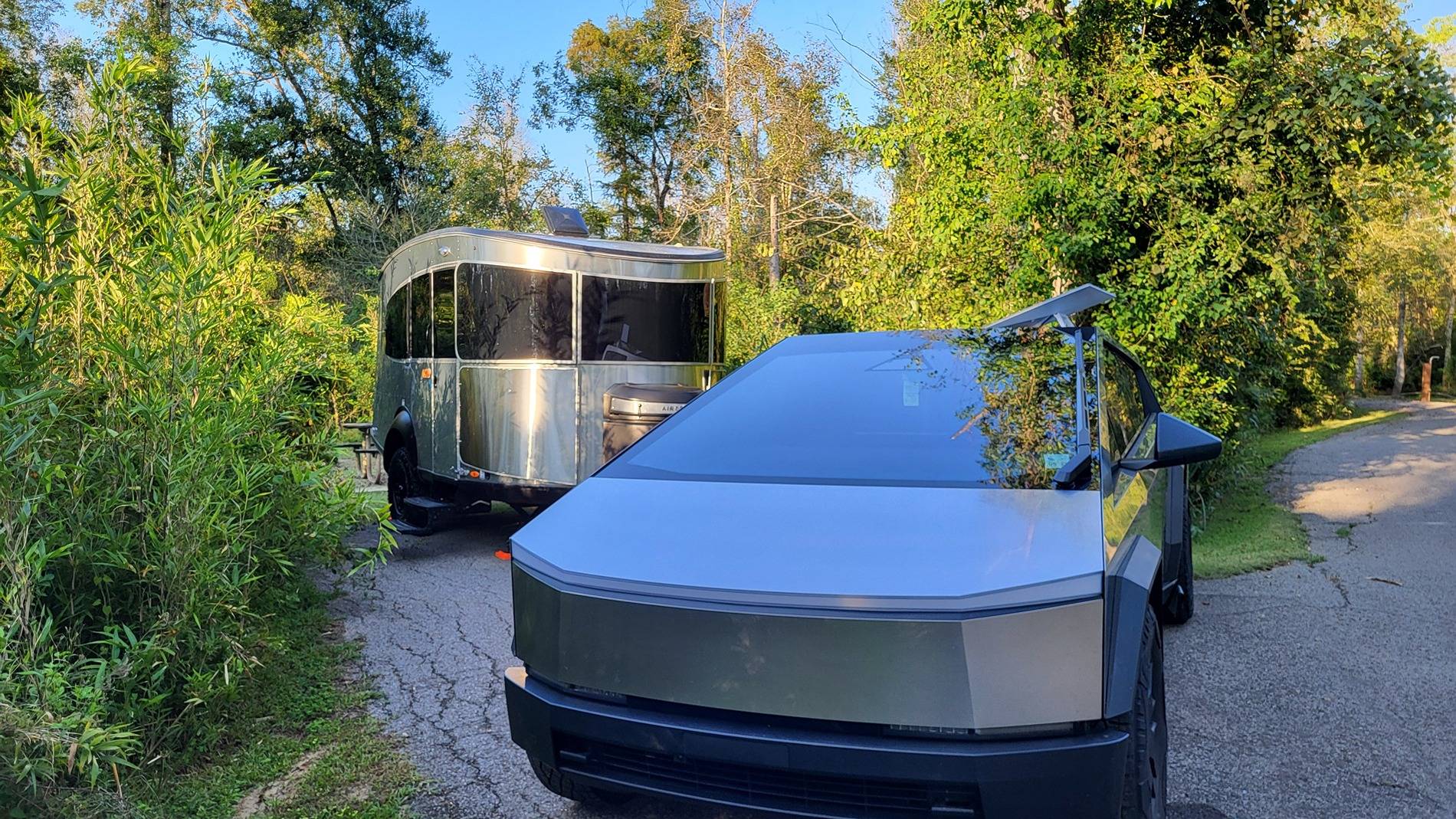

Update: Friday afternoon we took the camper on its maiden voyage to a state park 12 miles from home. Got 609 Wh/mi going 45 to 55mph. Will update with the return details Sunday night.
Decided to see how long we could last using truck for shore power. With max AC we burn about 1% per hour. Based on this, probably want to boondock in winter and do parks and campsites with hookup power in summer.
With the 14-50 adapter I'll pull about 1.5kW with the airconditioning. I can probably safely charge the truck at 10 amps. Total we plan to be pulling about 16 amps of the total 32 amps you could theoretically take from a campsite 50 amp outlet. Gives us 50% margin for extra safety. On paper this would fully charge the truck over 2 or 3 days.
