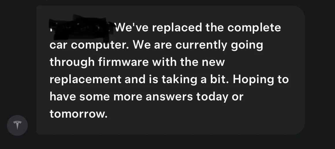

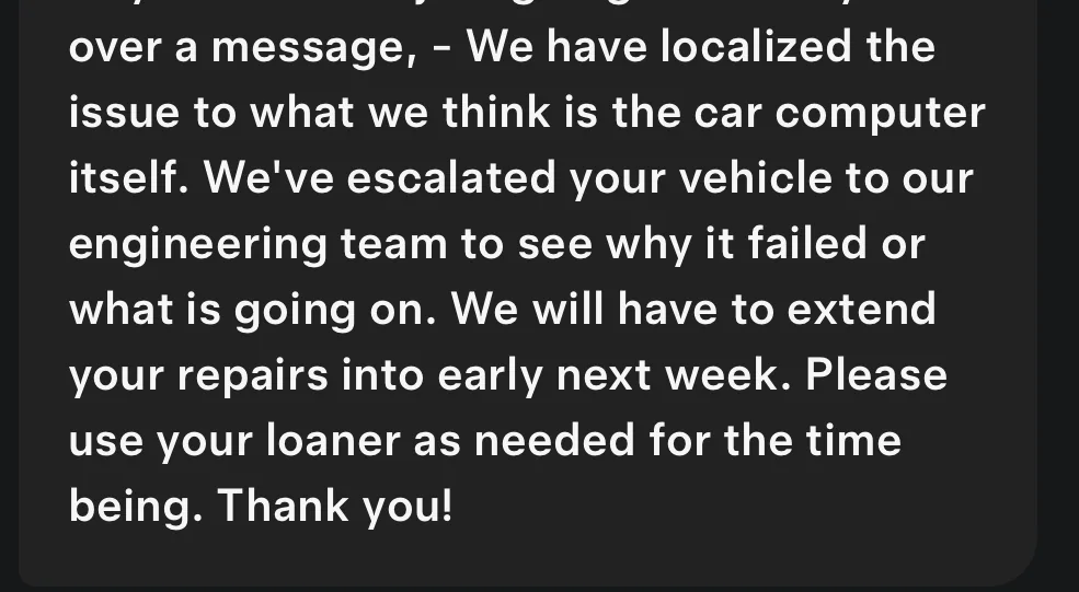

Newest update from service. Computer replaced. So maybe issues are just with my truck 😁

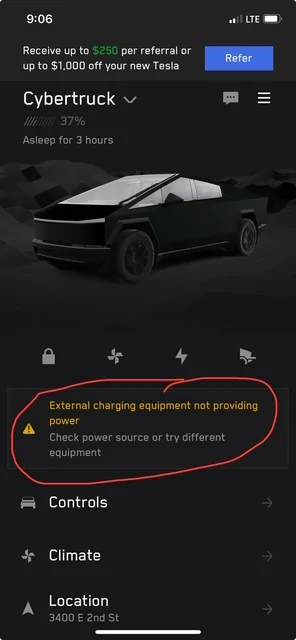

I have the same "park assist degraded" message appearing with 38.3.2 install, AND I have a charging issue that has come up, as well.
"External charging equipment not providing power. Check power source or try different equipment"
This morning, I turned off my wall charger at the breaker and turned it back on, but still got the message when I plugged the CT back in. I took the CT to a supercharging station and had no issue with charging. My son has a 3 so he took it to his house and plugged it in.... he got the same "External charging..." message.
Has anyone else had this issue?
Tesla Cybertruck 2025.38.3 Issues CT_charging_issu
I have an appointment with SC this Thursday.

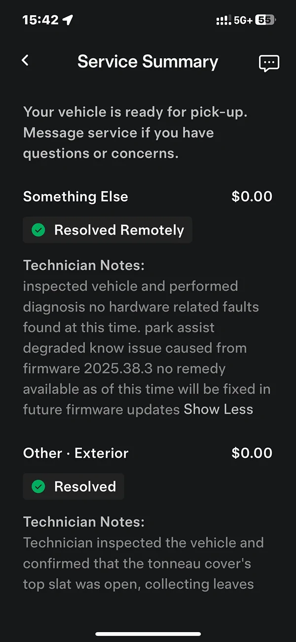

Just got my CT back from service for the park assist issue… and a couple others. Photo attached of the notes.

Any updates on this. Mine still has this same issue. I don’t think rear cross traffic is working bc of this
