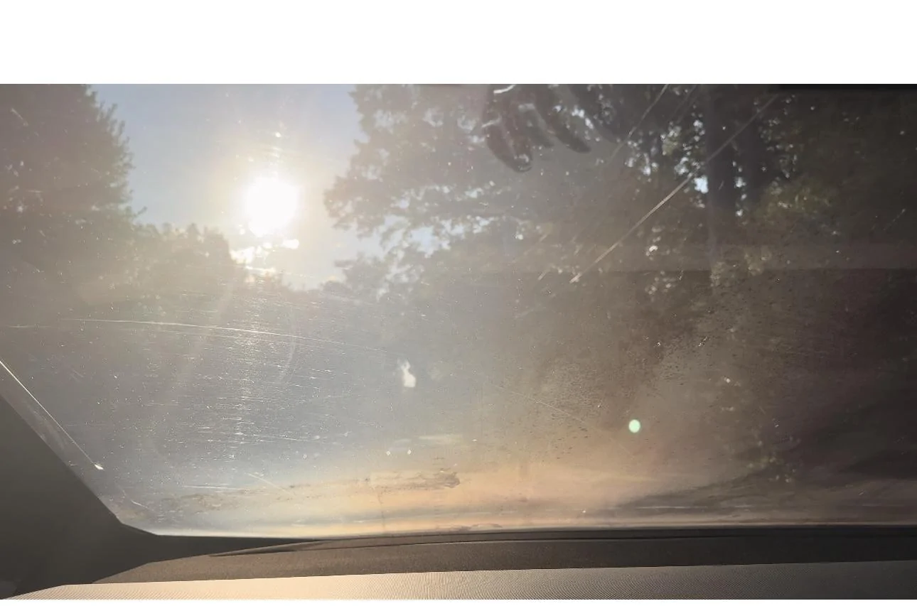

Is anyone else experiencing this ?
The inside of my windshield was filthy when I took delivery and that haze especially with direct sunlight was an issue. I then got the front windshield tinted and they cleaned the inside of the window prior to tinting and now it has completely resolved.
I do get fog/condensation on very bottom of windshield that i just use the front defrost feature and the wiper and it goes way. This is a function of such a large windshield that narrows to a point at the bottom.

The "foggy" look on the windshield? Yes mine had that, I think they said it is the interior materials "off-gassing". I think there are videos that talk about removing this type of haze specifically, however I simply used regular glass cleaner (no amonia) and it seems to have resolved it.

Thanks for the response. I delayed tinting because I didn’t want Tesla to blame the tint. I will now proceed with cleaning and having it tinted.

It's dirty.
Use Invisible Glass with a microfiber cloth, then Invisible Glass with a lint free paper towel. Lint free paper towel is key
Works wonders.
Takes a couple of times.
Get an extension handle with microfiber pad
