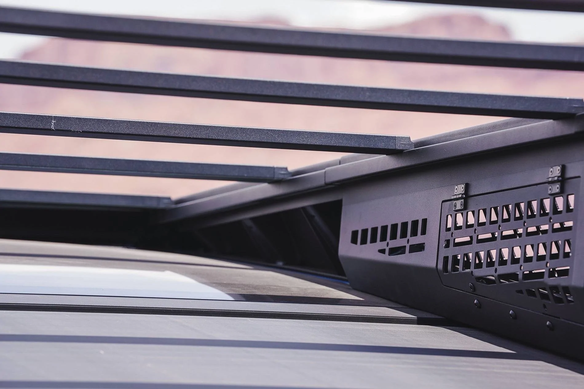

I’ve posted in another thread pictures of the OEM cross bars vs several aftermarket bars. Virtually all aftermarket bars look like amateur high school shop class projects IMO. They stick up vertically (90 degrees to ground) compared with the OEMs being angled flush with the truck’s sides, and have visible bolts and construction that isn’t compatible with the truck’s integrated ethos in my view.
None of the aftermarket bars or rack systems are easy-on easy-off in seconds. I agree with your conclusion on the guy who claimed it takes eight hours, but he swears by it, explained why. I could see a couple hours because you have to be super-careful not to scratch anything and it’s definitely a two-person job. But using your own estimates, it’s still an hour’s work - 16 bolt studs is a bunch to line up and torque properly. There’s no question that the OEM bars both maximize allowable weight on the roof AND are the easiest on/off solution by a wide margin. Maybe if you never intend to take them off, it could make sense to go aftermarket. But then you’re still stuck with the home-made look.
