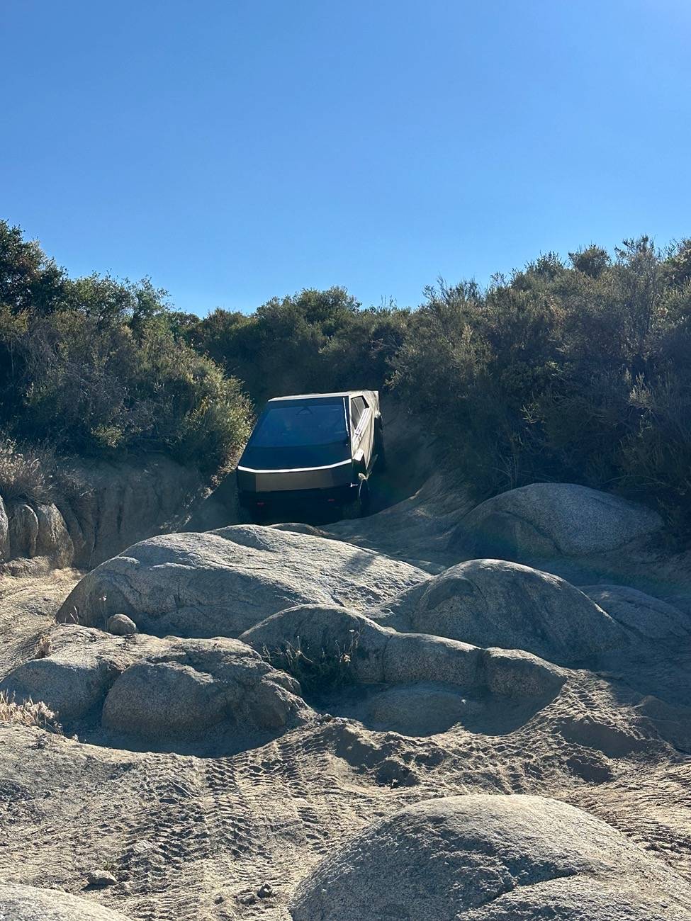

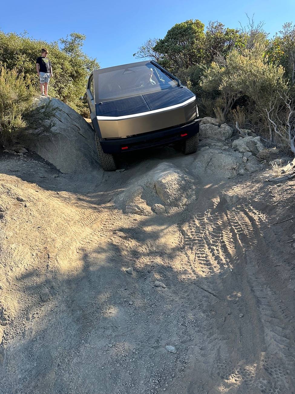

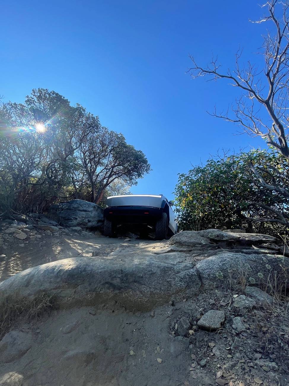

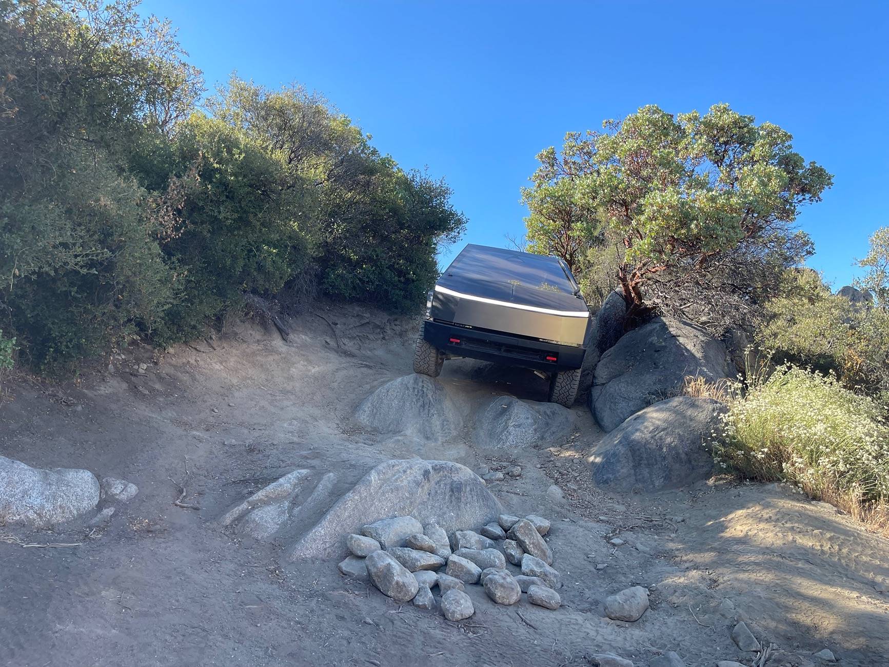

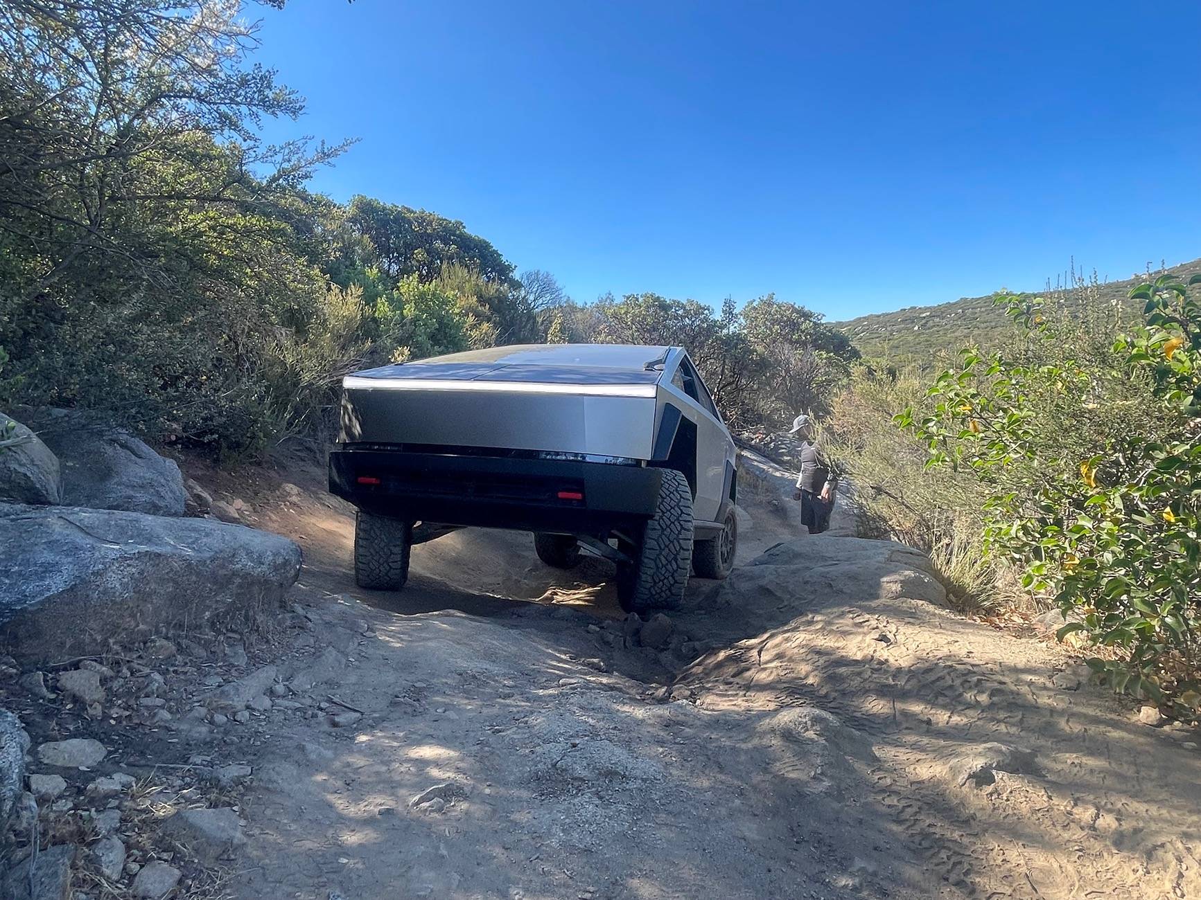

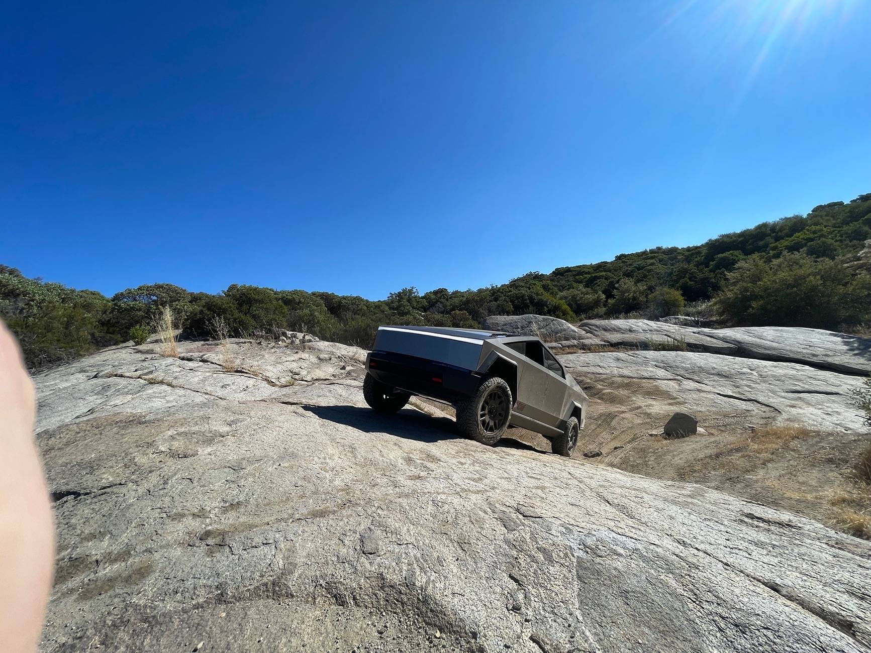

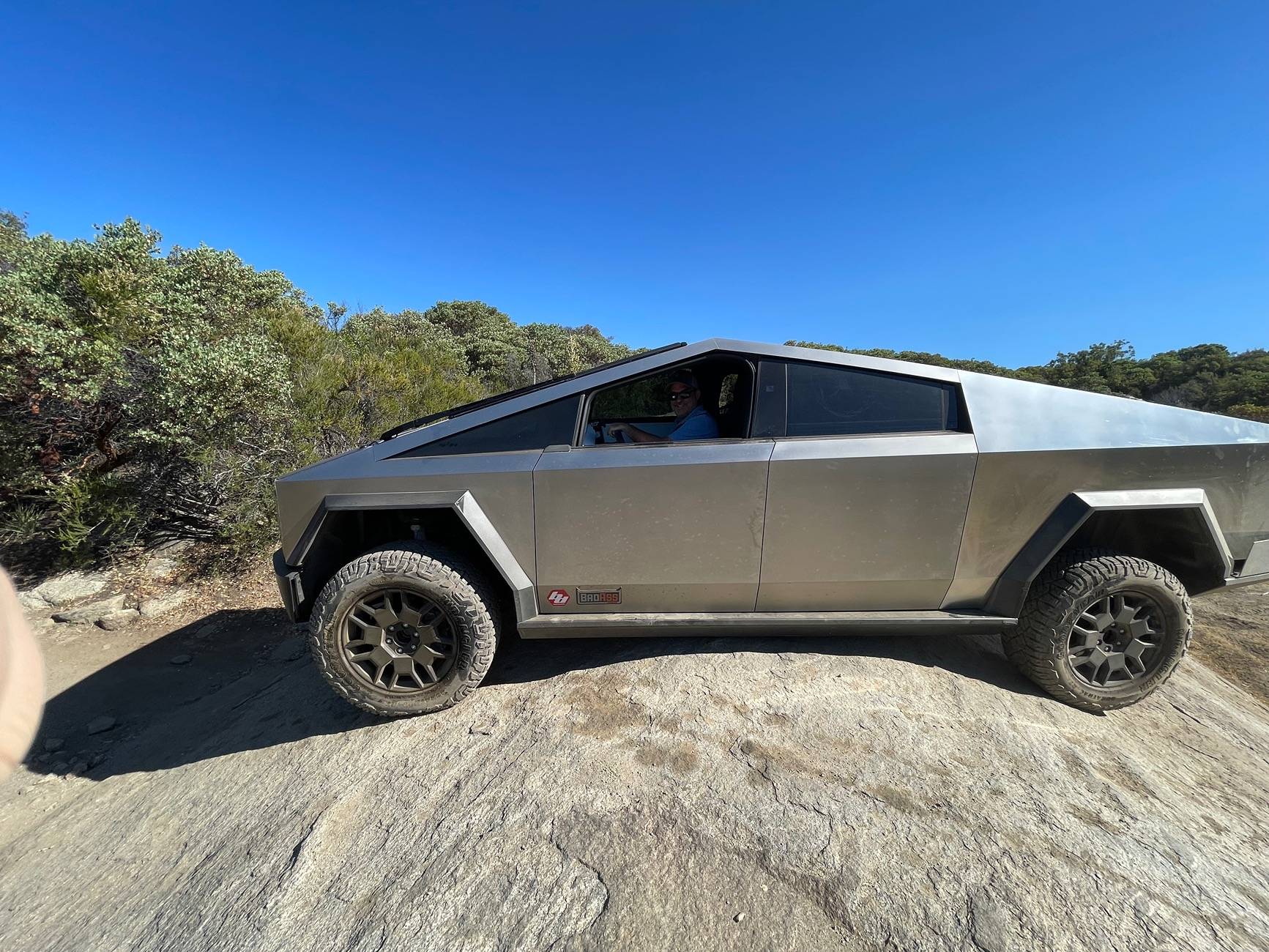

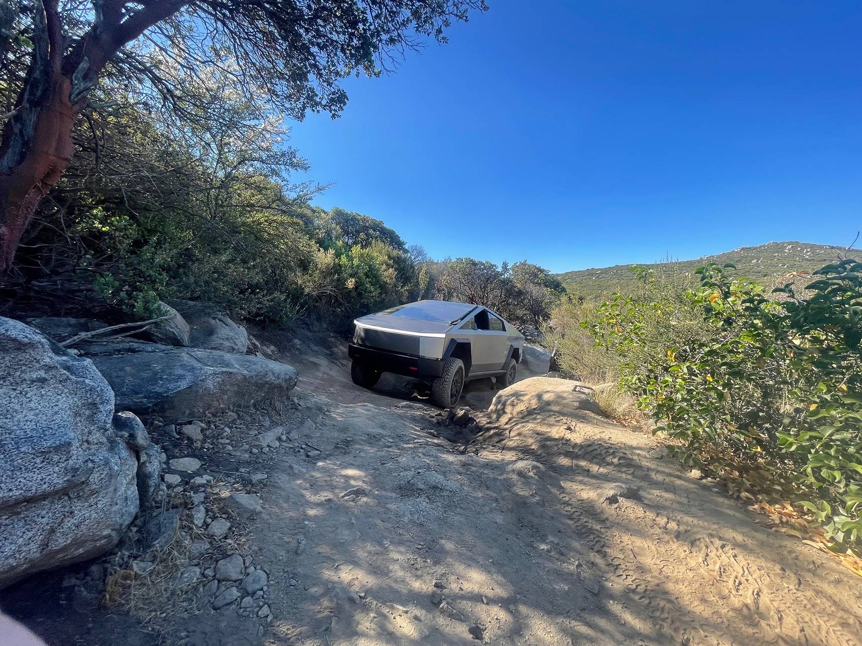

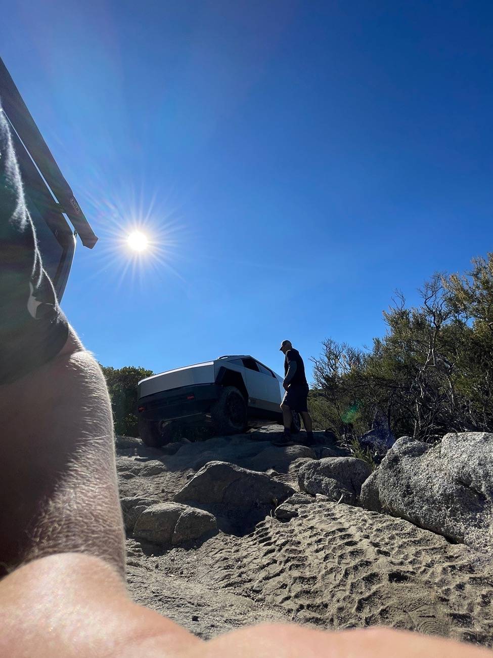

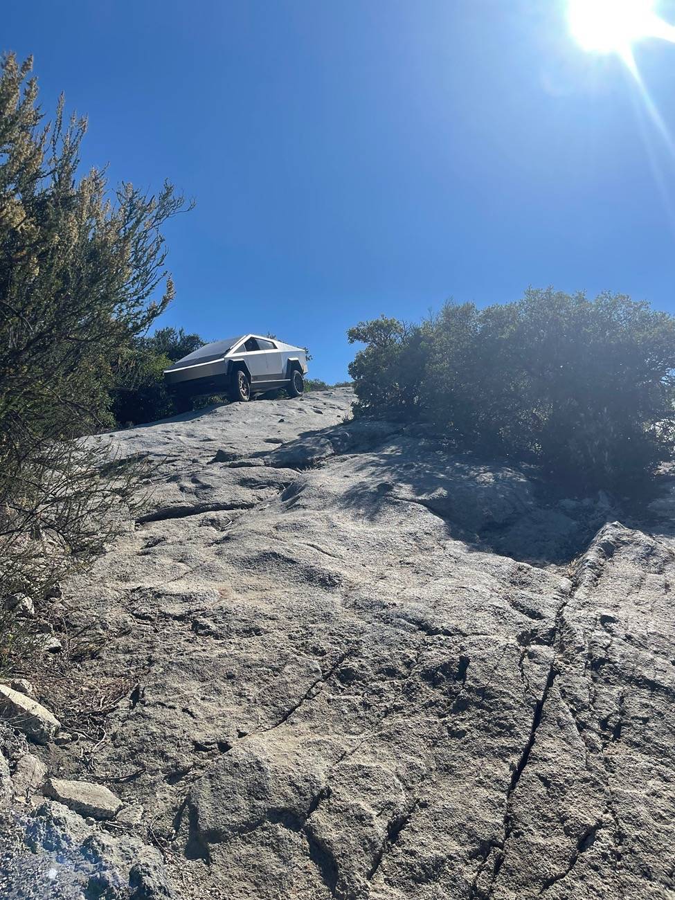

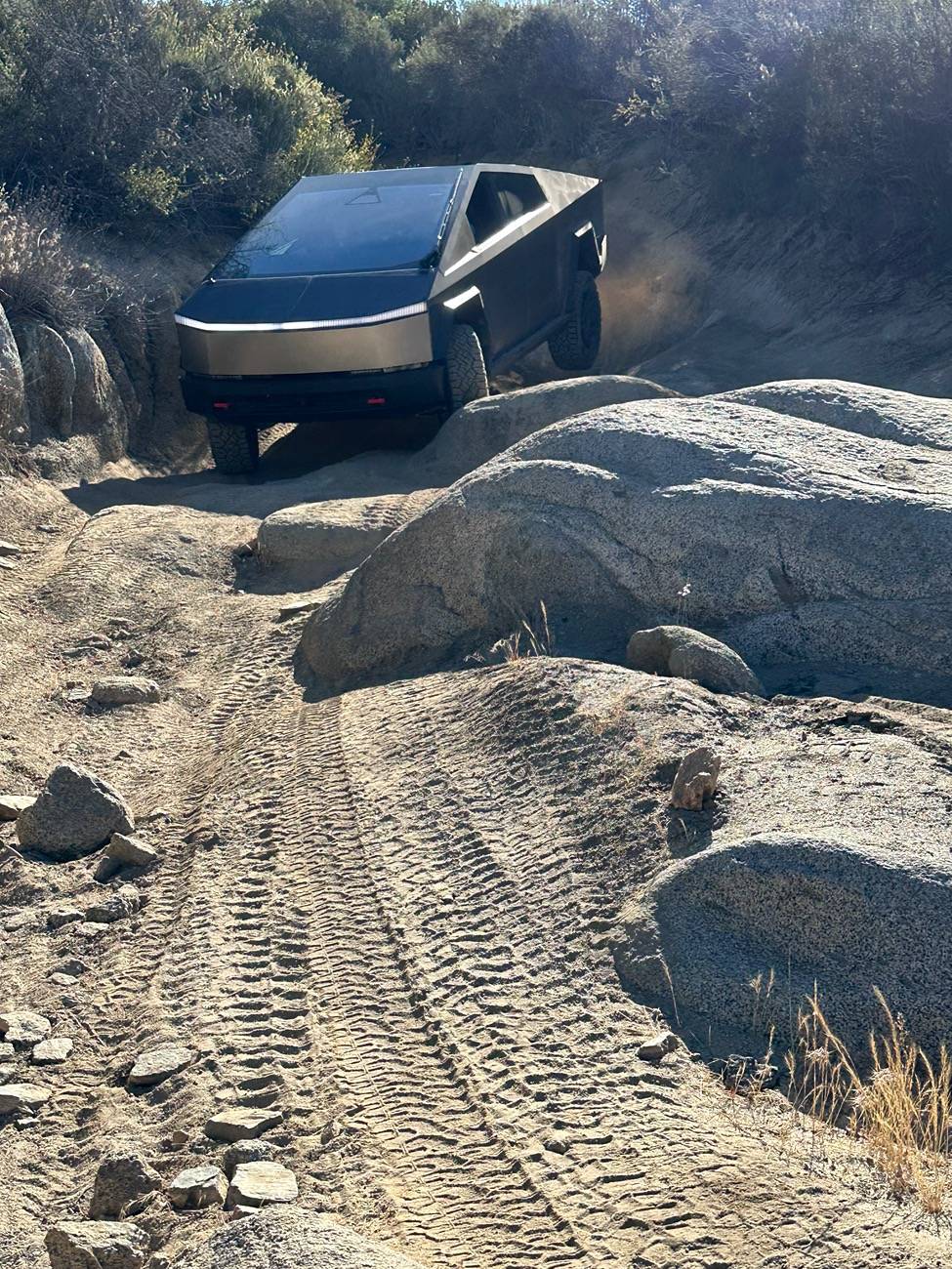

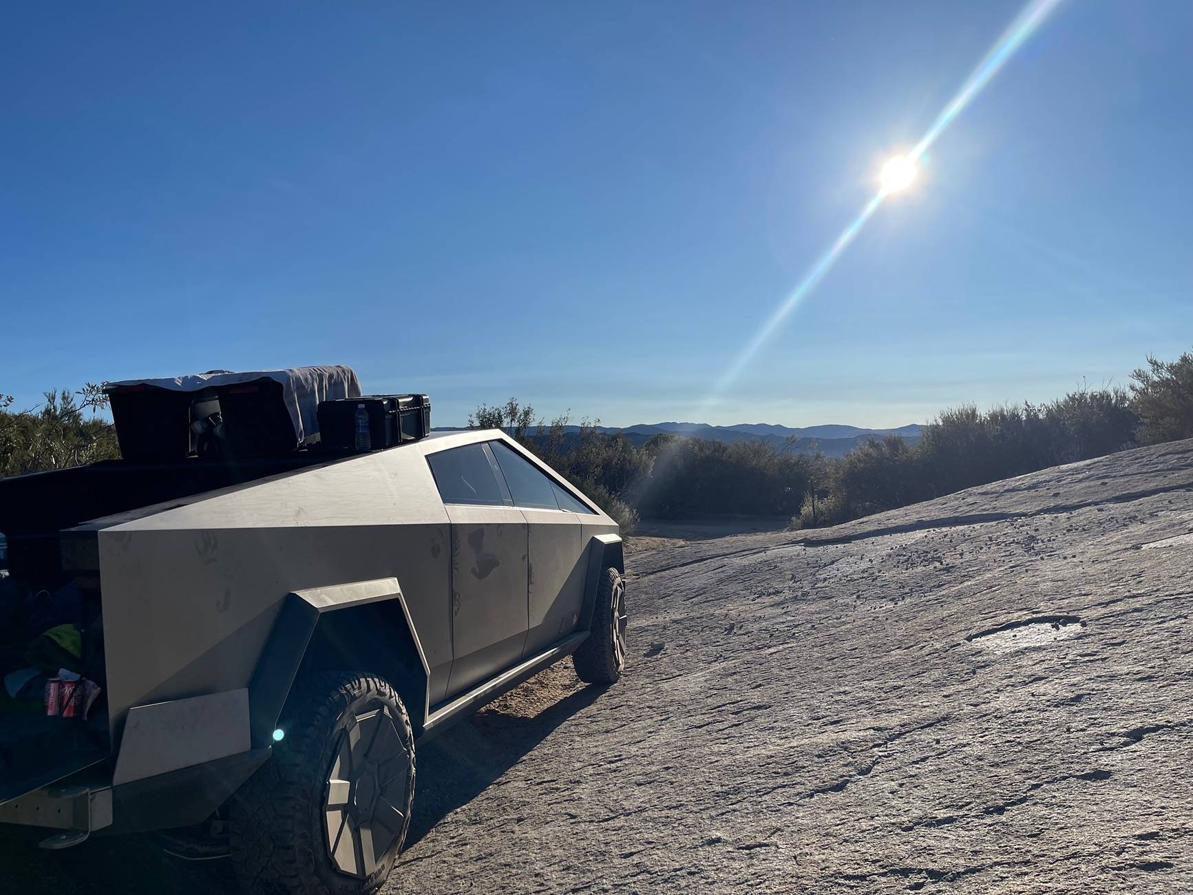

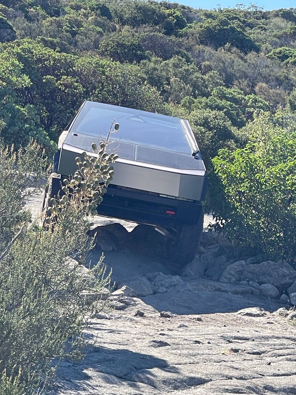

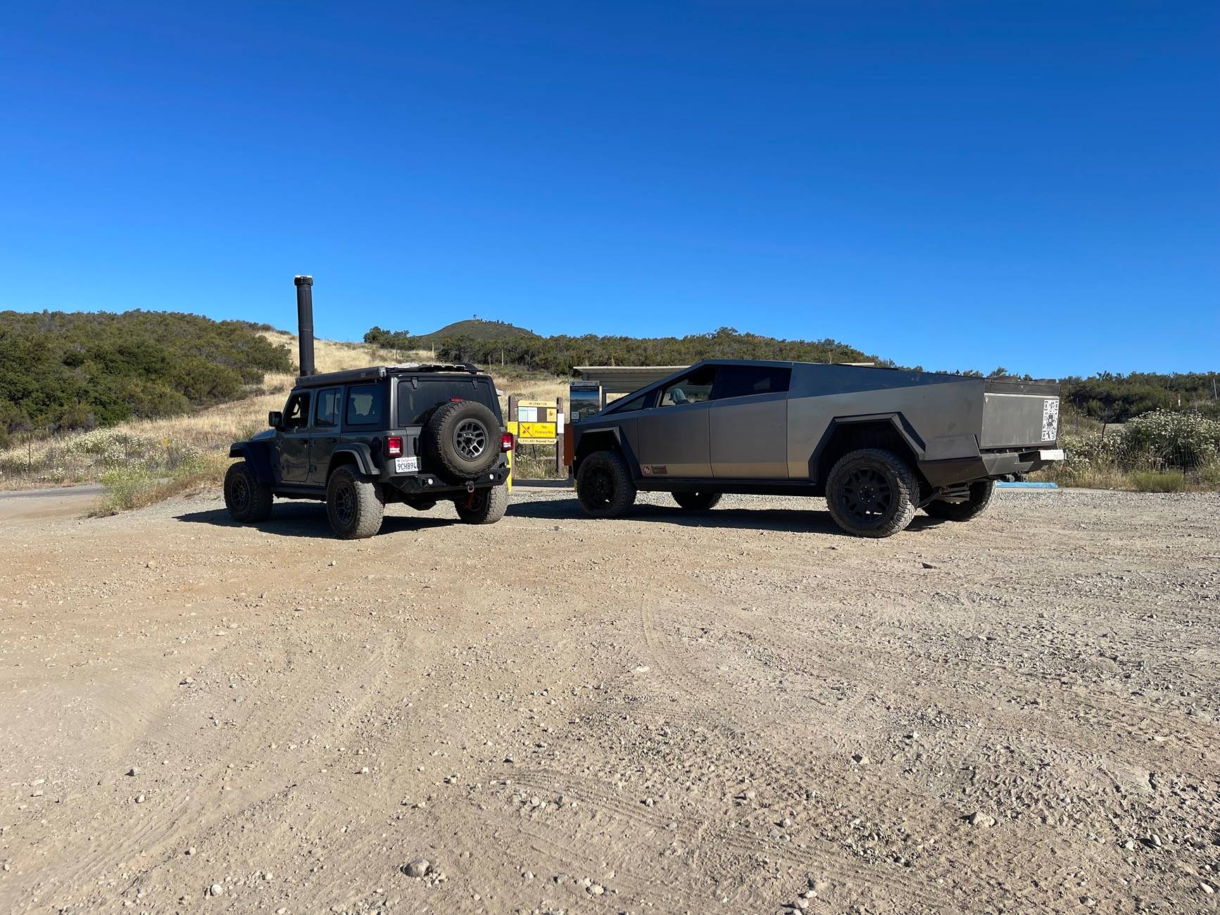

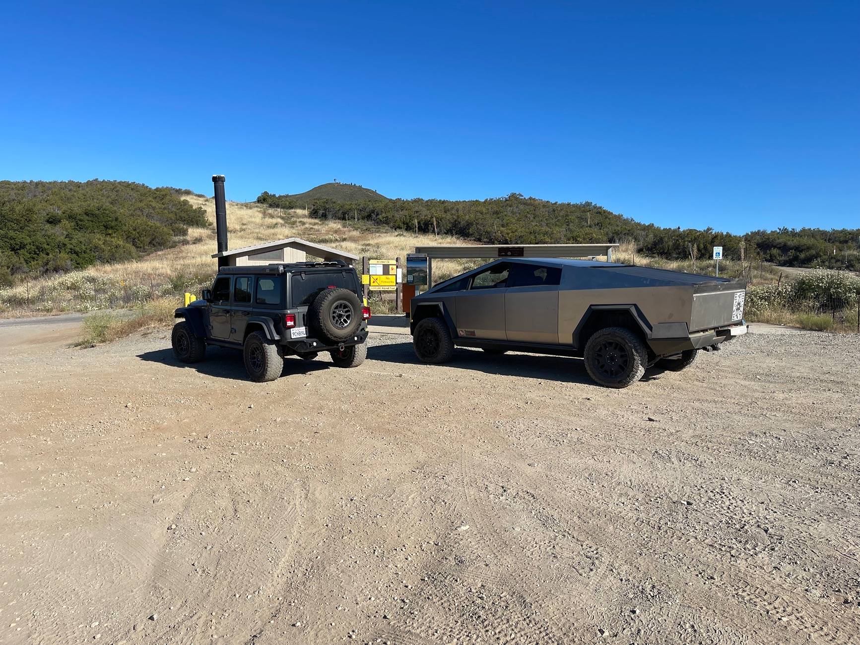

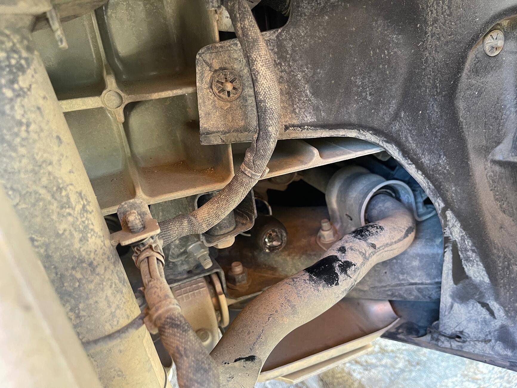

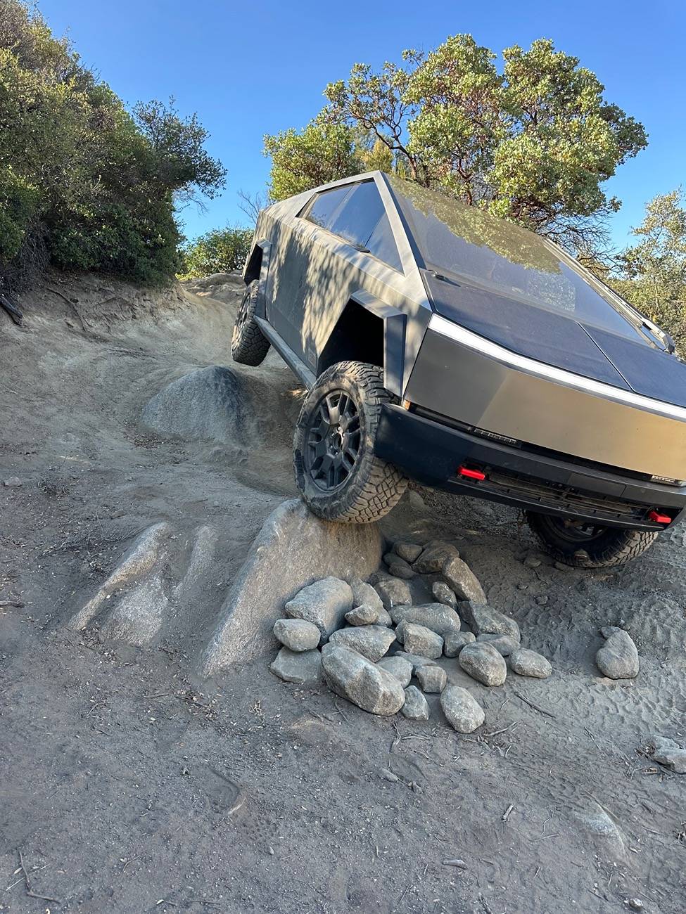

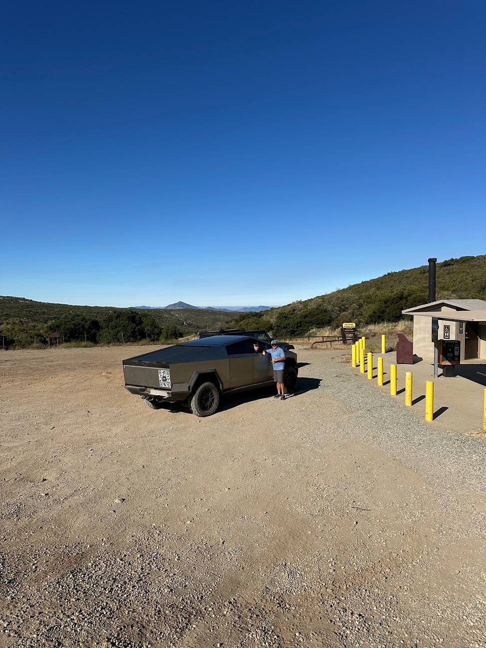

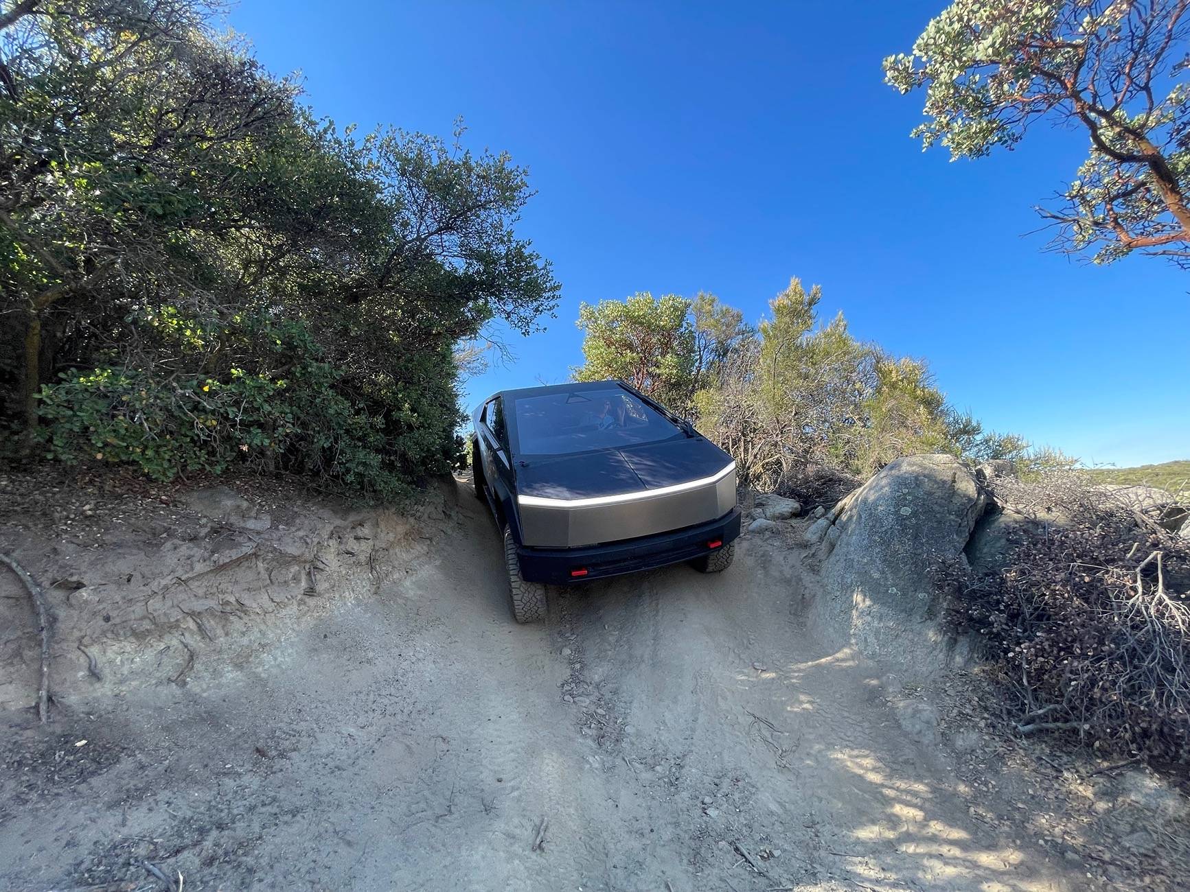

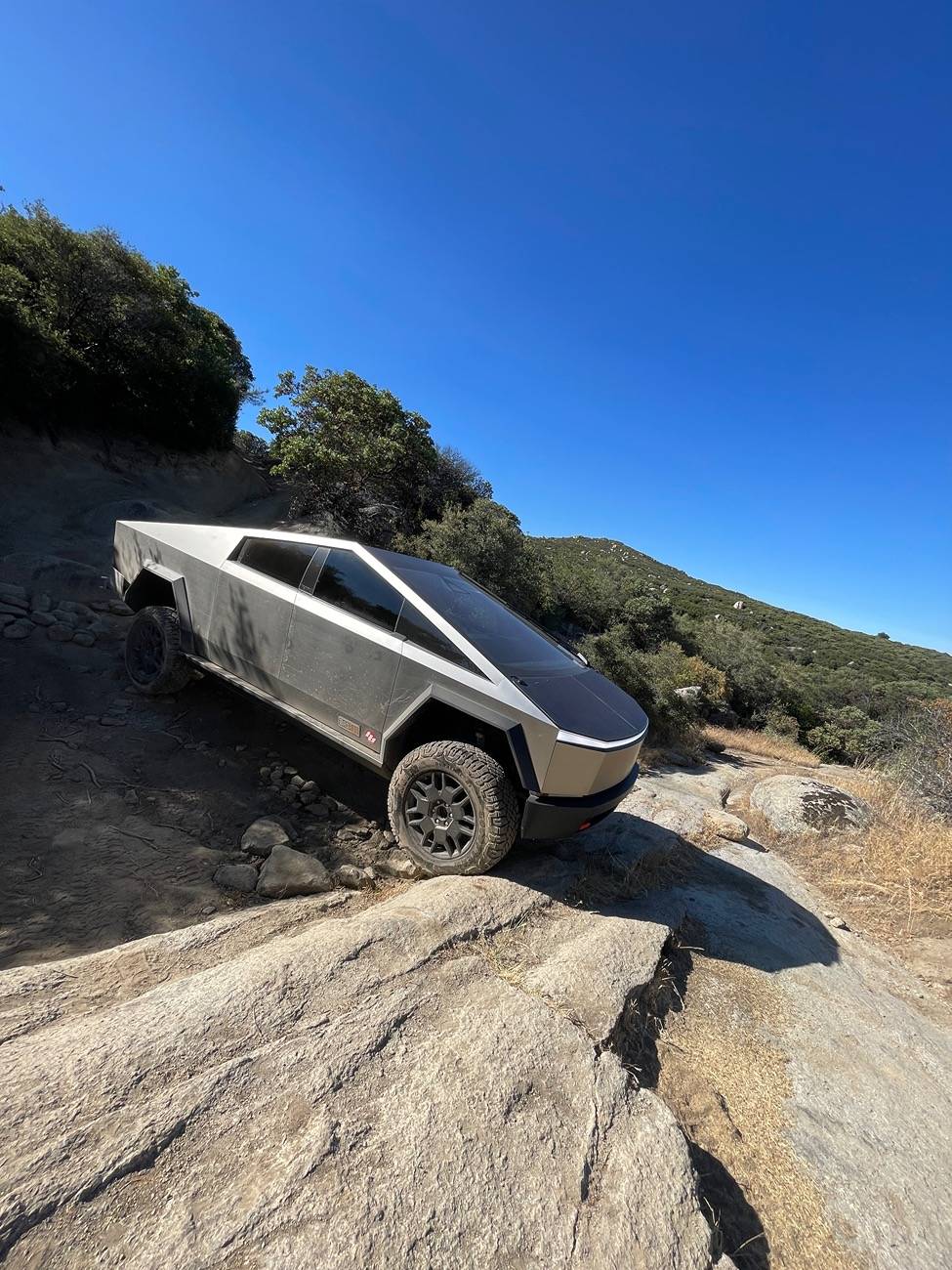

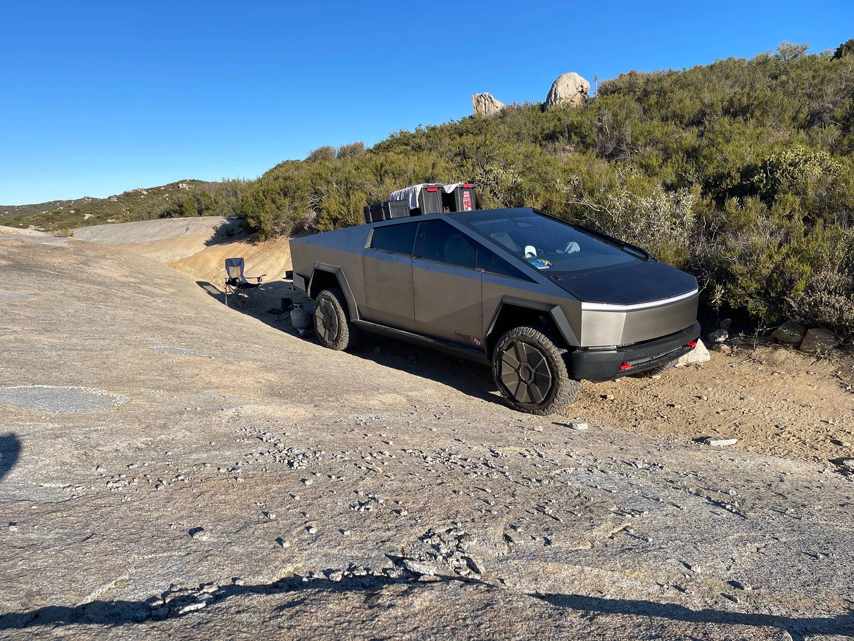

William and I decided to go out and run the Sidewinder trail in the Coral Canyon OHV park located in East San Diego County to test our new underbody armor package. This is a difficult Trail rated a 7/10 by OnX, it’s definitely not a trail that should be taken alone by any vehicle or by any Cybertruck that does not have a full armor package, lift, all terrain tires and tie rod upgrade.
My son and I went out and camped the night before and were able to see some great stars at night. We’re in the process of photographing and making videos for all of our new RS2.0 racks so we ended up sleeping in the bed of the truck, which wasn’t too bad except for we had to take everything out of the bed at night. Really missing my CyberCamper.

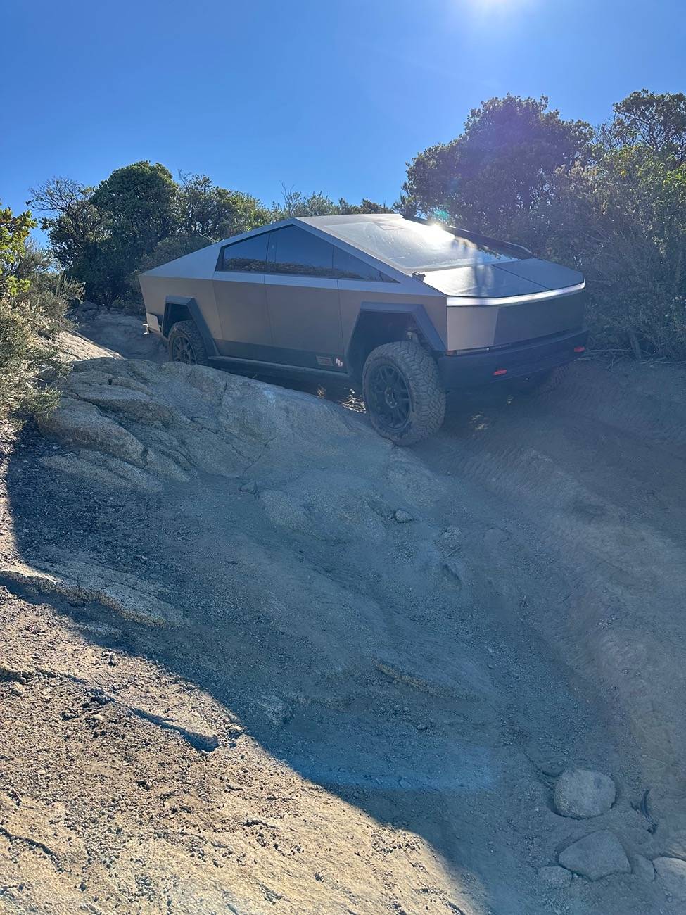

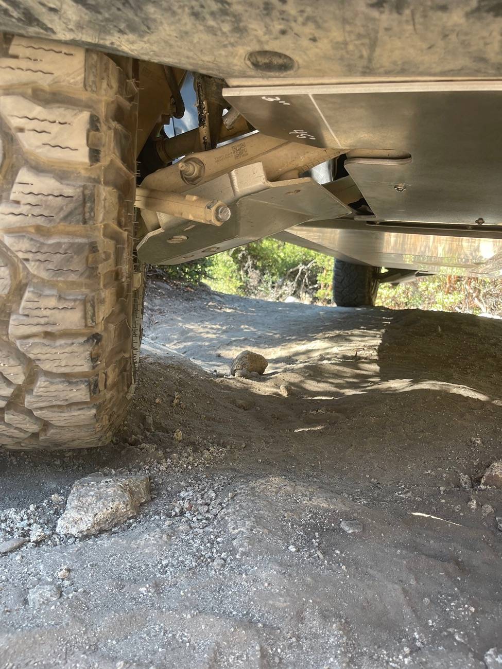

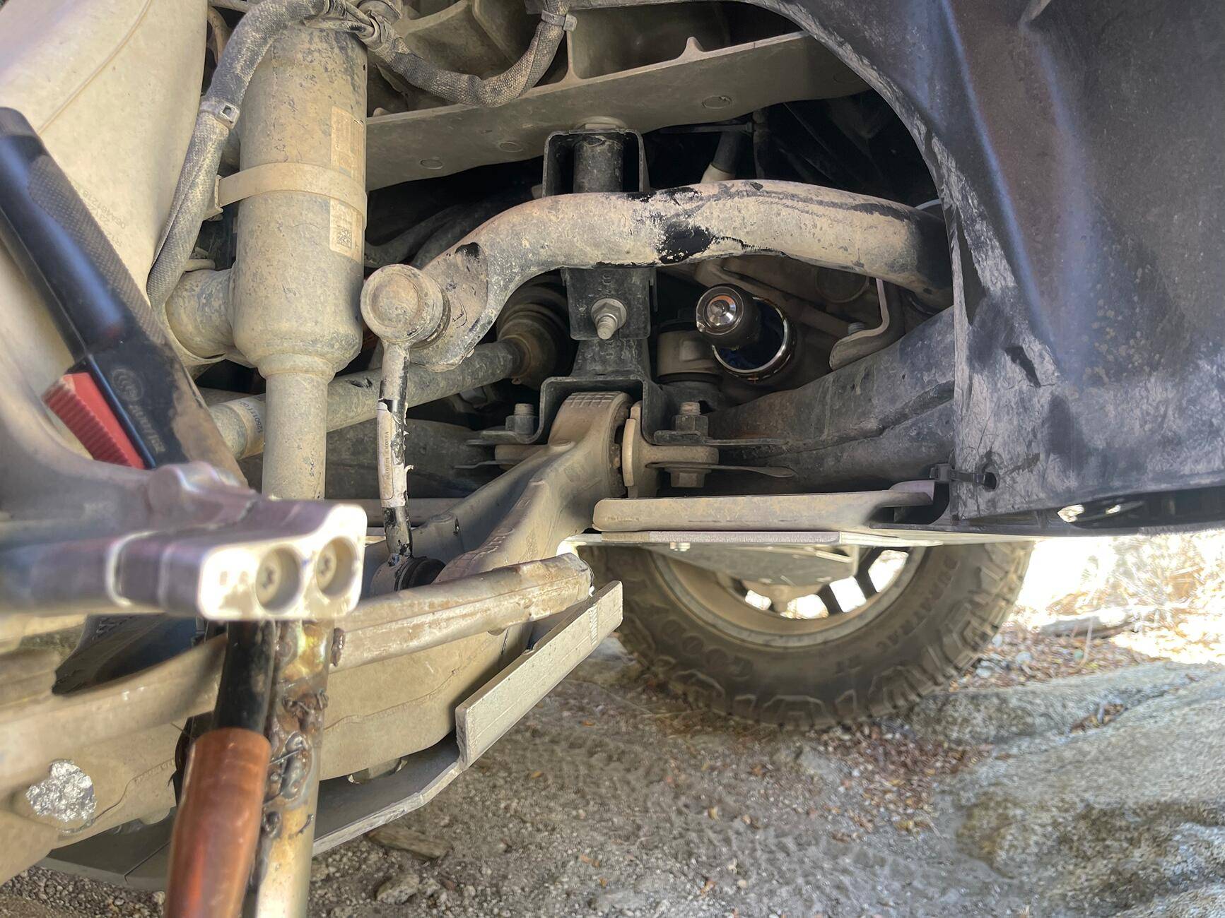

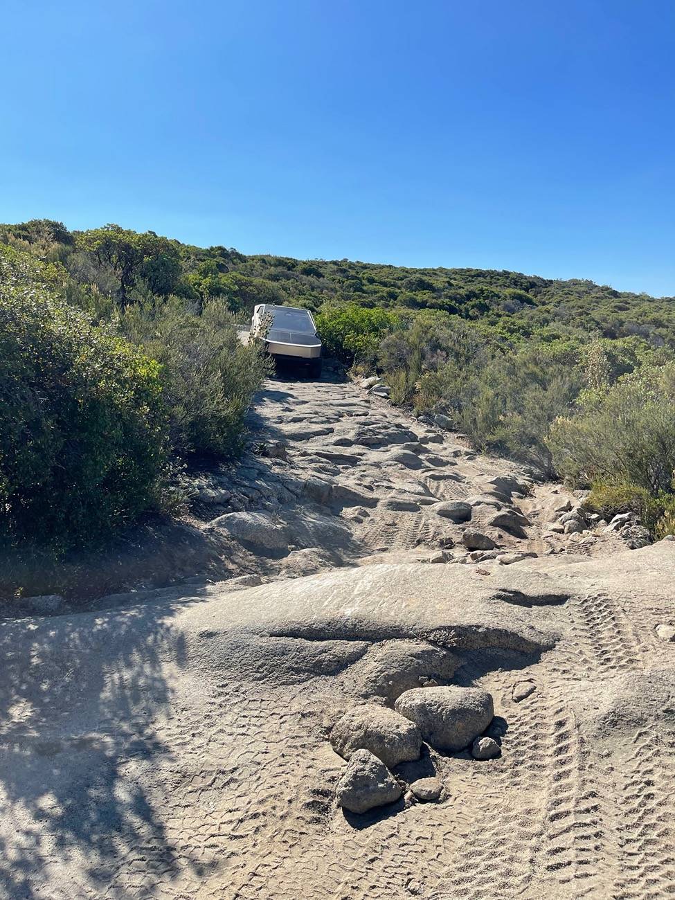

We started at the trailhead at 8:30 and had made it about 1 mile in of the 2 1/2 mile trail by 9:30 before the passenger side front tie rod snapped… we were able to use four ratchet straps to straighten the front wheel and back it off to the side of the trail so she’s not blocking the path.
fixing this will be top priority this week for engineers, and we hope to have something on the Haas by the weekend to solve this weak point. It looks like Tesla used 1500lb tie rod on this truck with only a 1/2” threaded end on it. Compared to the Jeep with a three-quarter inch threaded end on it, I was told had a 2500lb rating. Because of the drive-by wire and the electric rack, this is definitely a week point that needs to be resolved before our Rubicon trip next month.
Other than that.. the entire underside of the armor was used and would’ve no doubt punctured and torn the stock battery cover. We were very happy with the results of the armor as the metal did not bend, or dent, just some nice gouges. Rock Sliders were also used at every turn, and our rear bumper got a few nicks. The front bumper was stock and did get scuffed up, but it’s getting replaced next week so it didn’t really matter.
I do not recommend this Trail to any Cybertruck that is not fully armed and going with a group.

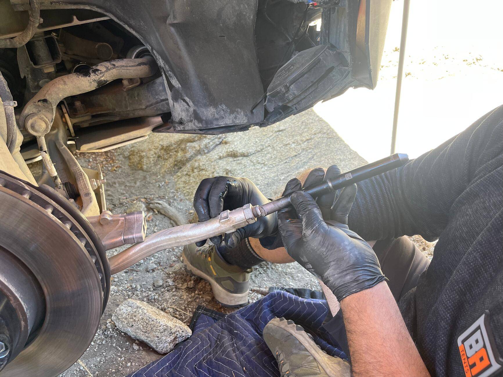

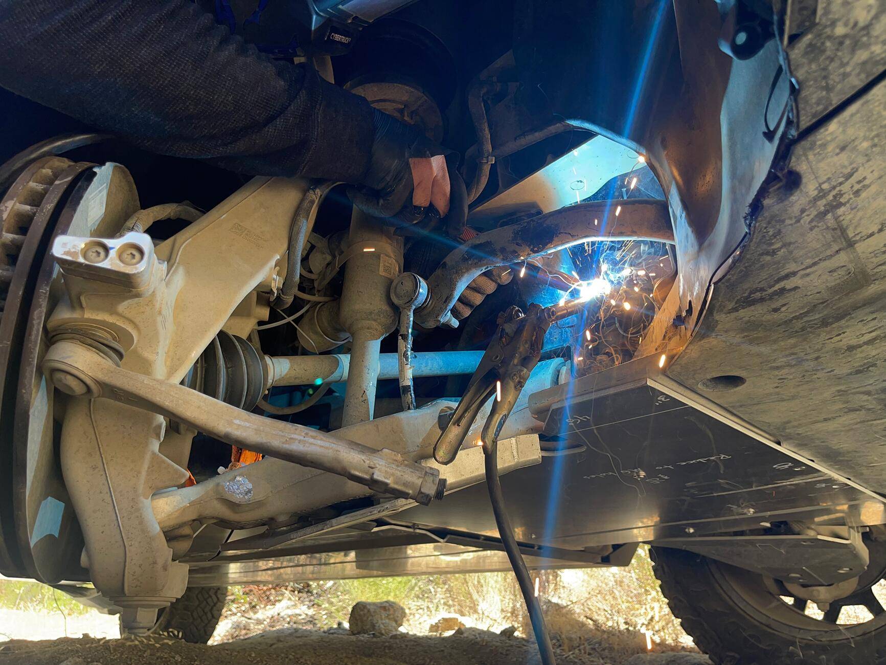

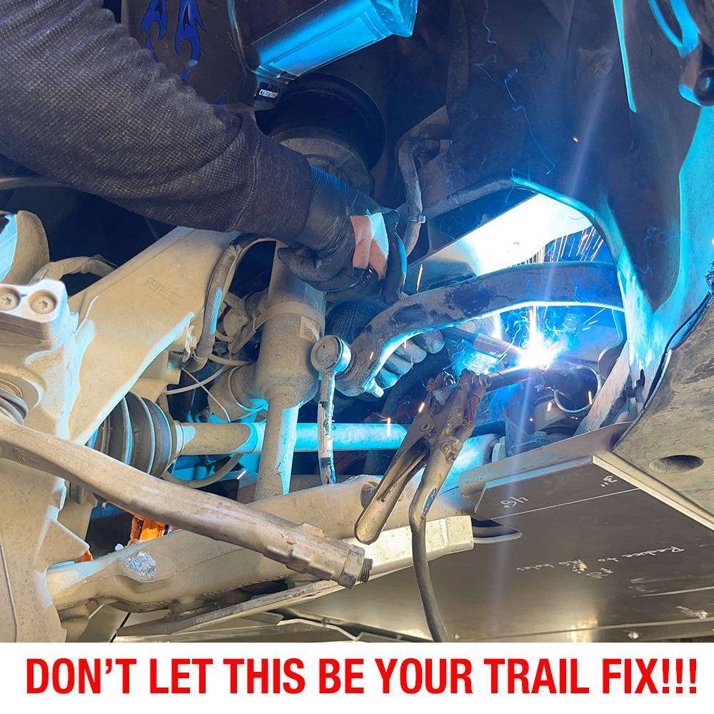

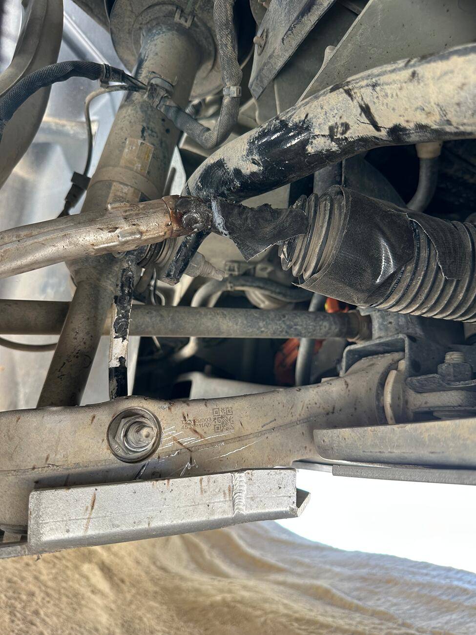

Update... Stopped by Tesla yesterday 7am to buy replacement parts, and they ar not available, they only have the outer tie rods and the entire steering rack for sale at $3300 with 2 week delivery window... so we went back yesterday to weld it on the trail.
Turns out the inner tie rod broke in 2 places, once at the threads and the second at the turned down neck where it connects to the rack. This rod is extremely fragile, the turn down is only .25" thick at the knuckle!
During the trail out, the welded rod bent again, but was stopped by the sway bar from breaking and allowed us to limp it off. So that said, we do not recommend unhooking the sway bar because this saved us from more welding!
Good news coming as we already sourced a heavier duty direct replacement part that will be available on the site the next few days, after we go back to run this trail through, and an then Xpedition Version coming before end of the month.

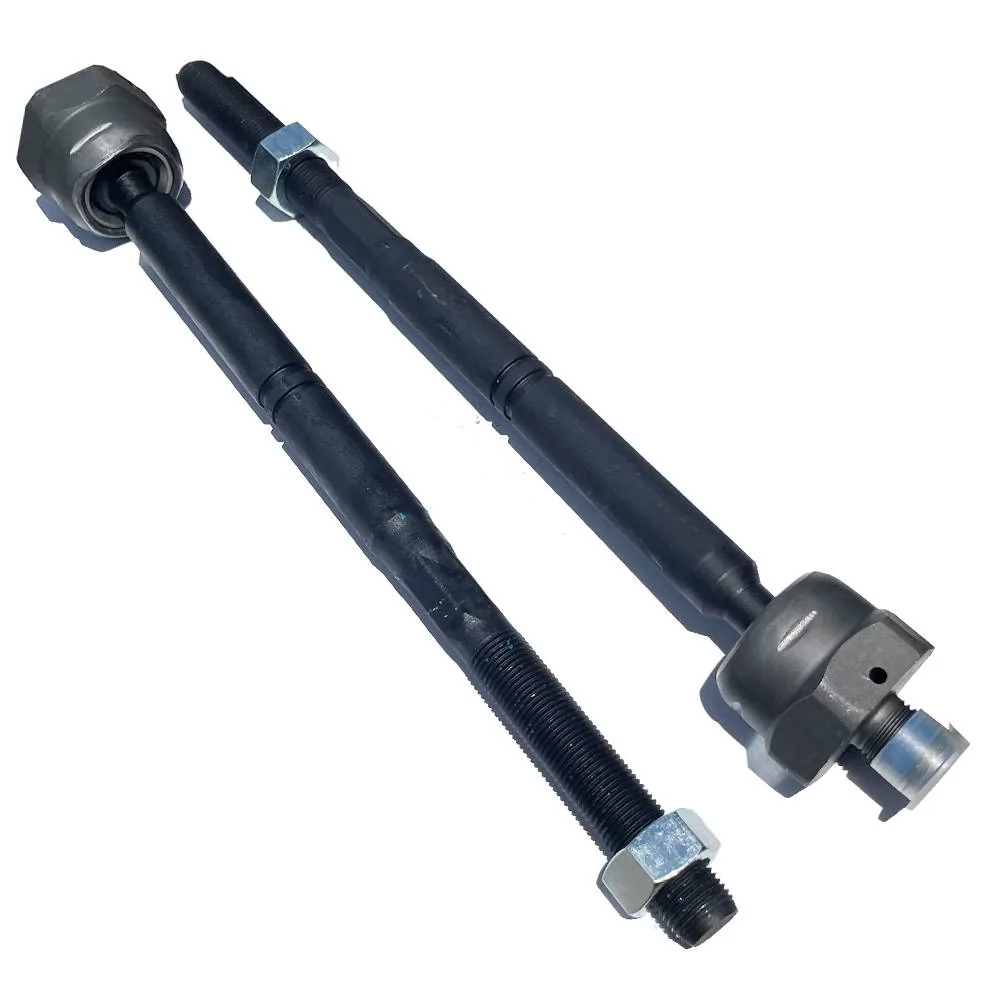

Guys, and Gals!

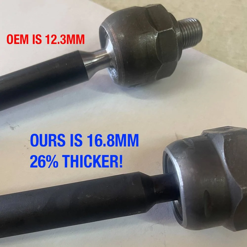

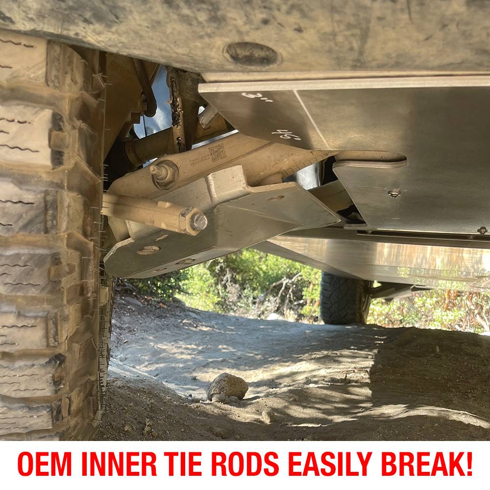

We worked fast and opened over 100 boxes at the Auto Parts distributor to find a Heavy Duty Front Inner Tie Rod Solution!
This is a MUST HAVE for any off-roading as the stock parts are junk! They are cast with an out sleeve, maybe ok for the Model 3, but not for off-roading because the Cybertruck steering rack gives no F's about continuing to steer with a rock against it, it will move the entire truck.
MOST IMPORTANTLY: OEM replacement inner tie rods are NOT currently available from Tesla. if you break yours, you have to buy the entire $3300 Steering rack not covered by warrantee!
Product Details
  • Direct OEM replacement, no modifications
  • Set of 2pcs for front steering rack, interchangeable
  • 27% thicker than the OEM Part at the knuckle, 8% Thicker on the shaft
  • Cast steel part, not sleaved part like OEM.
  • Belleville preload washer helps eliminate spring bind and shattering during shock load
  • Metal-to-metal Gusher Bearing design provides strength and allows grease to flow through bearing surface
  • Ball studs are heat treated to exceed OE requirements to inhibit premature failure and improve fatigue strength.
  • Wrench flats on housing and stud provide easy installation and alignment adjustment.
  • Comprehensive testing throughout design and development processes by engineers for quality you can count on.
  • Pre-applied thread locking compound makes installation easier and prevents self-loosening.
Installation time from a qualified mechanic or shop should be 2hrs + Alignment.
This is an absolute MUST HAVE for off-roading to prevent leaving your truck on the trail to be recovered later, learn from our testing and solve the problem before it becomes yours!

Did the steering control arms break with locked front differential? In extract mode?
Were you against a rock trying to turn into it?
Do you remember the details?
