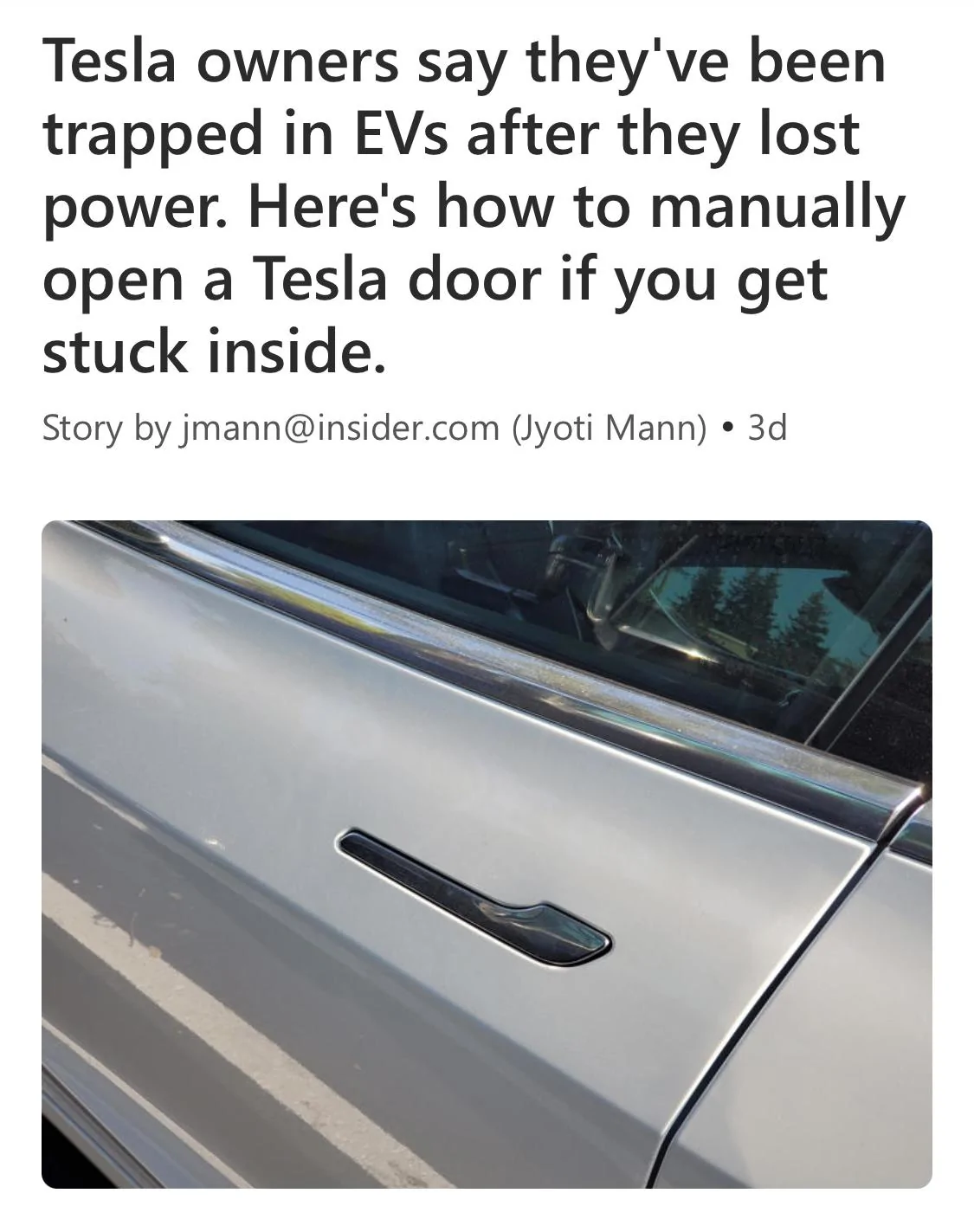

Speaking of coffins, don’t get stuck in there like these non owners manual reading fools. It’s in the book on how to get in and out of a Tesla with dead battery.lol.
Don’t know about the vault?! ???
I would probably go for a small trailer before closing myself up in a hot box. ?
Clearly you haven't read the manual. Battery not needed.
It’s in the book on how to get in and out of a Tesla with dead battery. lol.
?I would probably go for a small trailer before closing myself up in a hot box.?
This a complete BS post.
EVERY Tesla has emergency handles in EVERY compartment that you can get stuck in.
Matter if fact, Tesla has to go through some steps to keep owners from using the emergency handles by accident.
Yes, the Cybertruck has an emergency bed and frunk release. I think that both may even be lighted.
The ONLY slight issue is exit from the rear doors, which is honestly an issue with EVERY vehicle because of back door child locks.

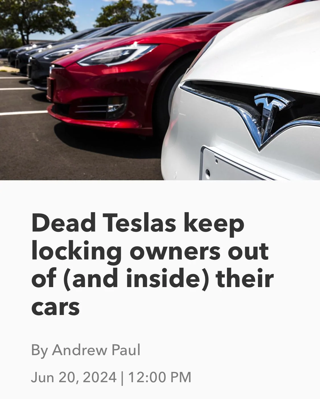

But there are social media folks out there making a LOT of money off of your clicks.
People stuck inside Teslas? I literally have to tell most of my passengers to NOT use the emergency handle. And show them where the correct button is.

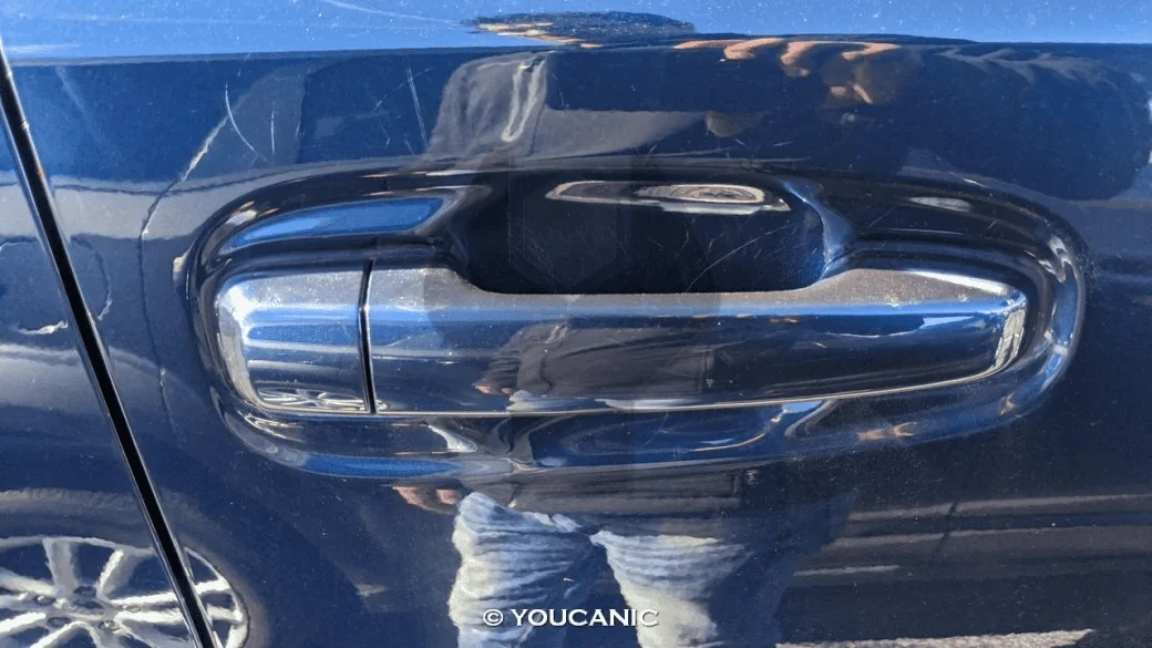

Dead Teslas keep locking owners out? This is a picture of the door handle on a Camry. Where's the key hole to unlock it?

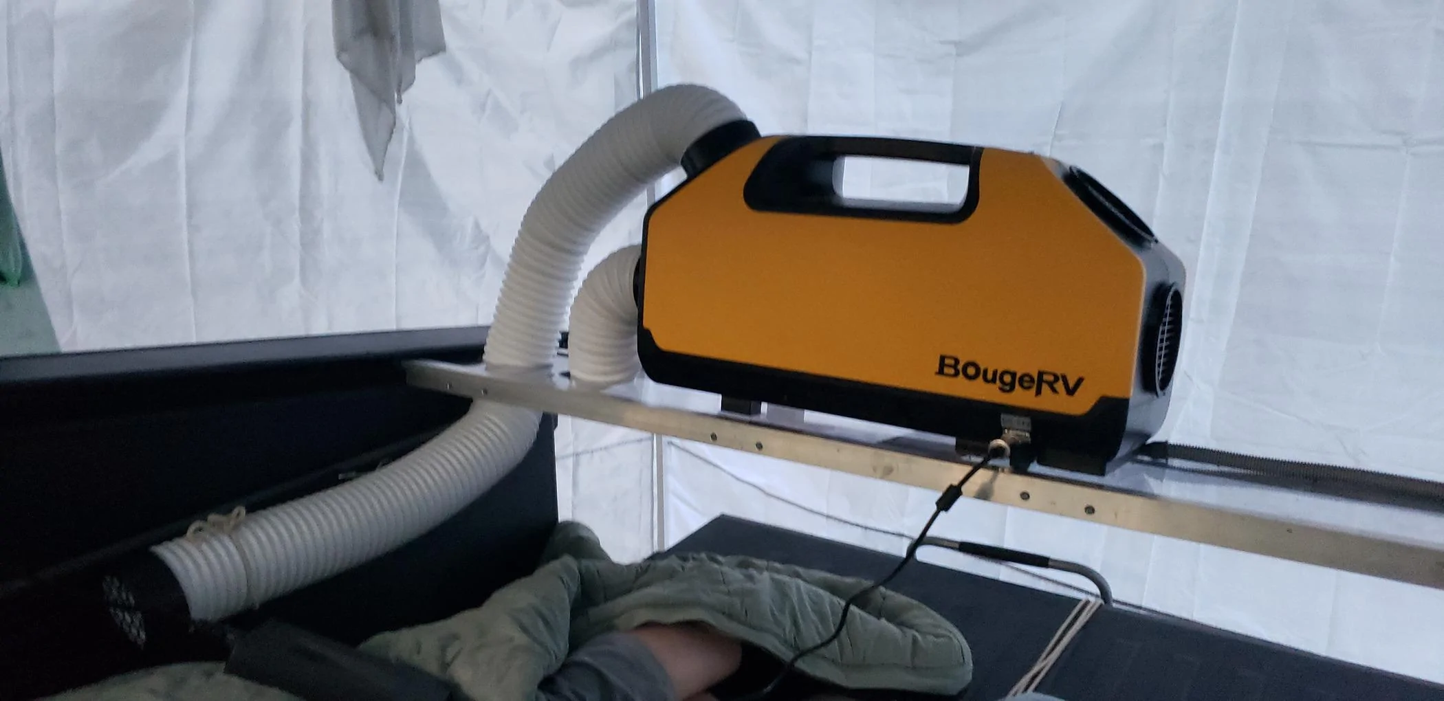

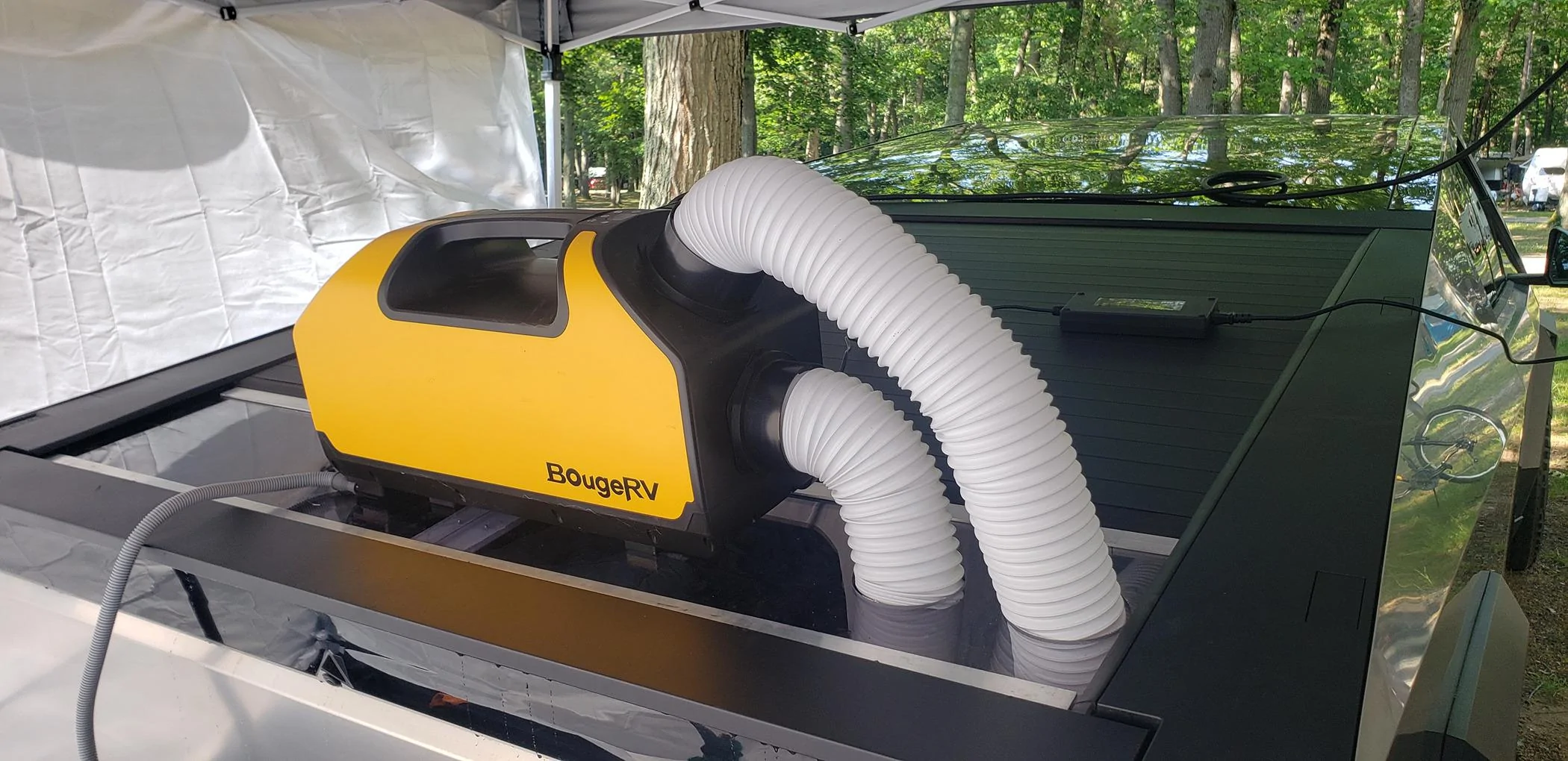

My first inclination was to try to duct the HVAC from the center console through a modified replacement rear window from breezer windows. I'm going to be installing a refrigerator, microwave, and tool shed drawers in the backseat so I didn't want to try to duct via the flooring.
I've also got a couple of induction cooktops which I am planning on cutting a structure for an installing them in the frunk for a flush cooking surface. Alas, I will have to get an extension cord for this, since there is no plug in the front.
