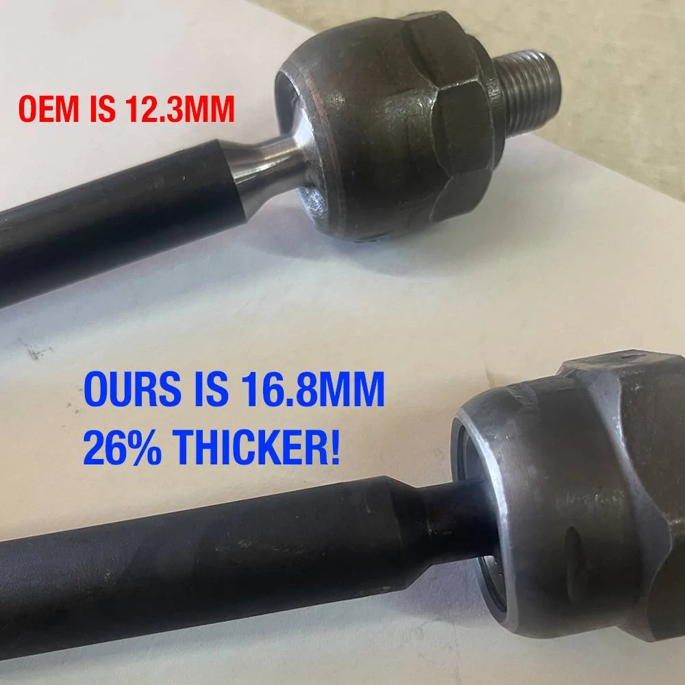

We worked fast and opened over 100 boxes at the Auto Parts distributor to find a Heavy Duty Front Inner Tie Rod Solution!
This is a MUST HAVE for any off-roading as the stock parts are junk! They are cast with an out sleeve, maybe ok for the Model 3, but not for off-roading because the Cybertruck steering rack gives no F's about continuing to steer with a rock against it, it will move the entire truck.

  • Direct OEM replacement, no modifications
  • Set of 2pcs for front steering rack, interchangeable
  • 27% thicker than the OEM Part at the knuckle, 8% Thicker on the shaft
  • Cast steel part, not sleaved part like OEM.
  • Belleville preload washer helps eliminate spring bind and shattering during shock load
  • Metal-to-metal Gusher Bearing design provides strength and allows grease to flow through bearing surface
  • Ball studs are heat treated to exceed OE requirements to inhibit premature failure and improve fatigue strength.
  • Wrench flats on housing and stud provide easy installation and alignment adjustment.
  • Comprehensive testing throughout design and development processes by engineers for quality you can count on.
  • Pre-applied thread locking compound makes installation easier and prevents self-loosening.

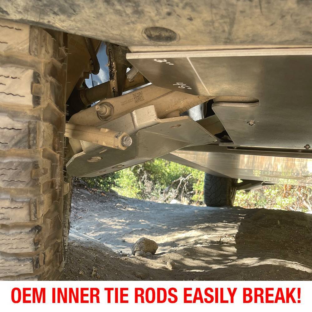

I remember seeing a video of a Rivian broke a tie rod on hells gate, different truck I know, but that Cybertruck in that video got lucky based on how ours broke on a less extreme obstacle. or google and see other Cybertrucks breaking them on the street with big rims.
Is the rack strong enough? In our opinion YES. The steering rack looks pretty tough, the bushings holding it will blow up first.
BUT, even more important than "is this part going to cause issues further down the line" by being 26% stronger is mute IMHO, because Tesla DOES NOT SELL INNER TIE RODS YET. They sell the outer ties rods for $90 and they sell the rack for $3300. So if and when you do break this part on the trail, you will be welding your truck on the trail and/or asking us to overnight to you on a Saturday when we are closed.
I would personally rather invest $200 everyday of the week to keep these under the seat to not have to weld in the dirt blocking a trail. Everybody off-roading this truck other than on a dirt road will find out sooner than later.

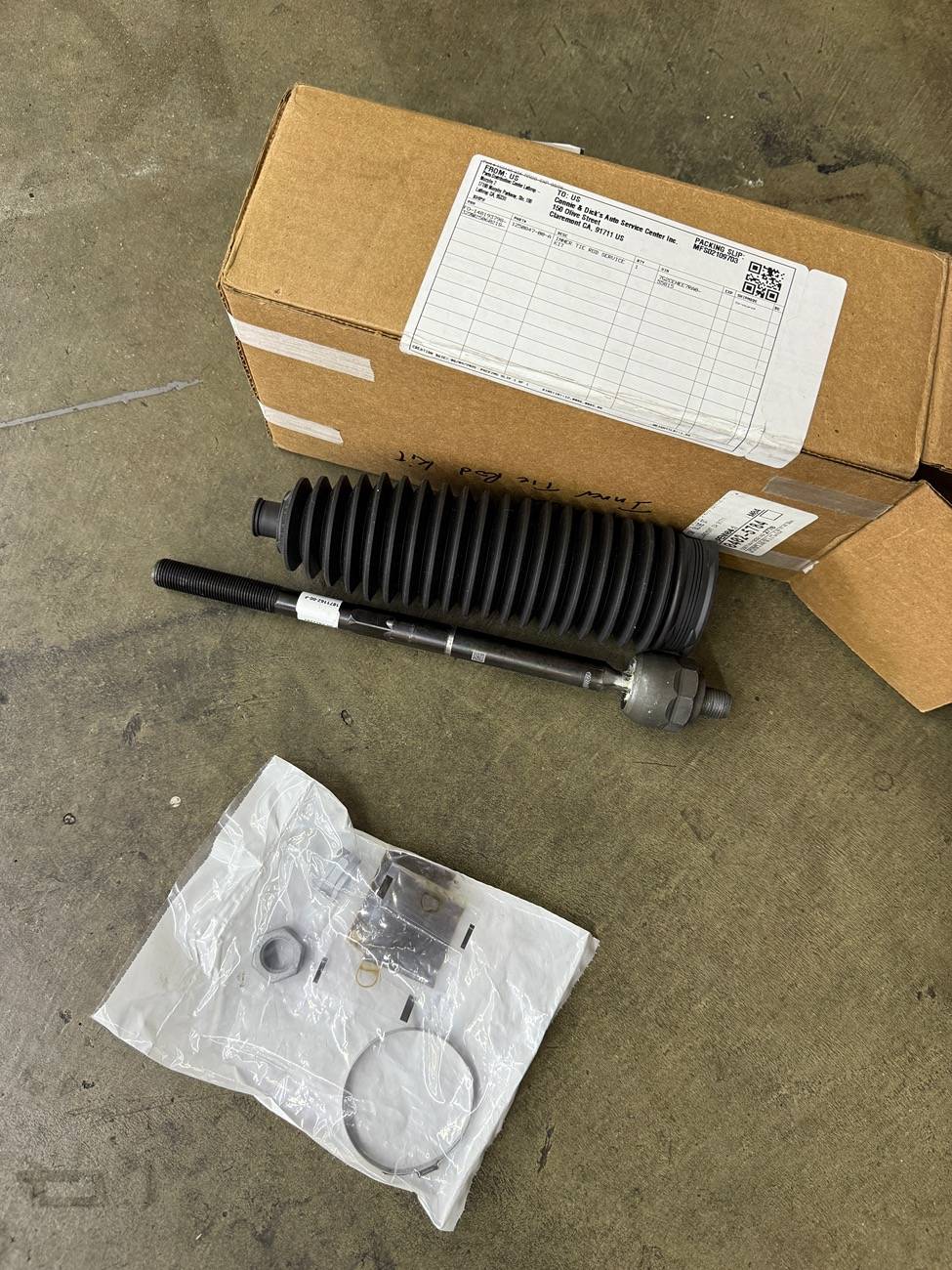

Fyi, they don't list them in the parts graphic but if you scroll through the parts list you'll an inner kit. We ordered one a while back and it took about 2 weeks for it to arrive. Comes with a boot, & clamps.
Thats great news for guys who don't want to upgrade the part till it's broken and have the OEM spare. I 100% support this for most owners. If you have that Tesla part number, can you please share it here so people can order a spare now and not wait 2 weeks if a problem ever happens?
