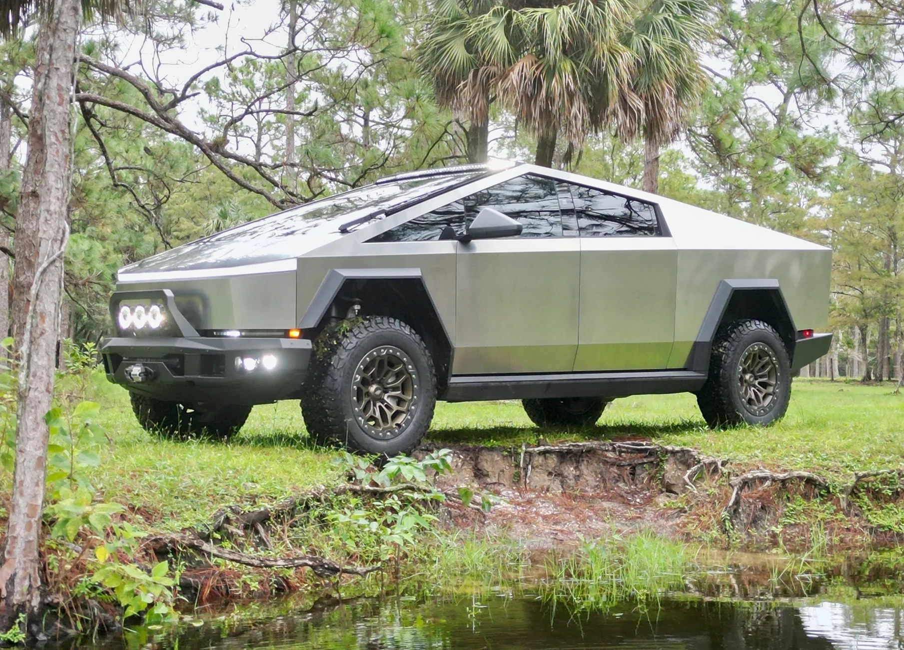

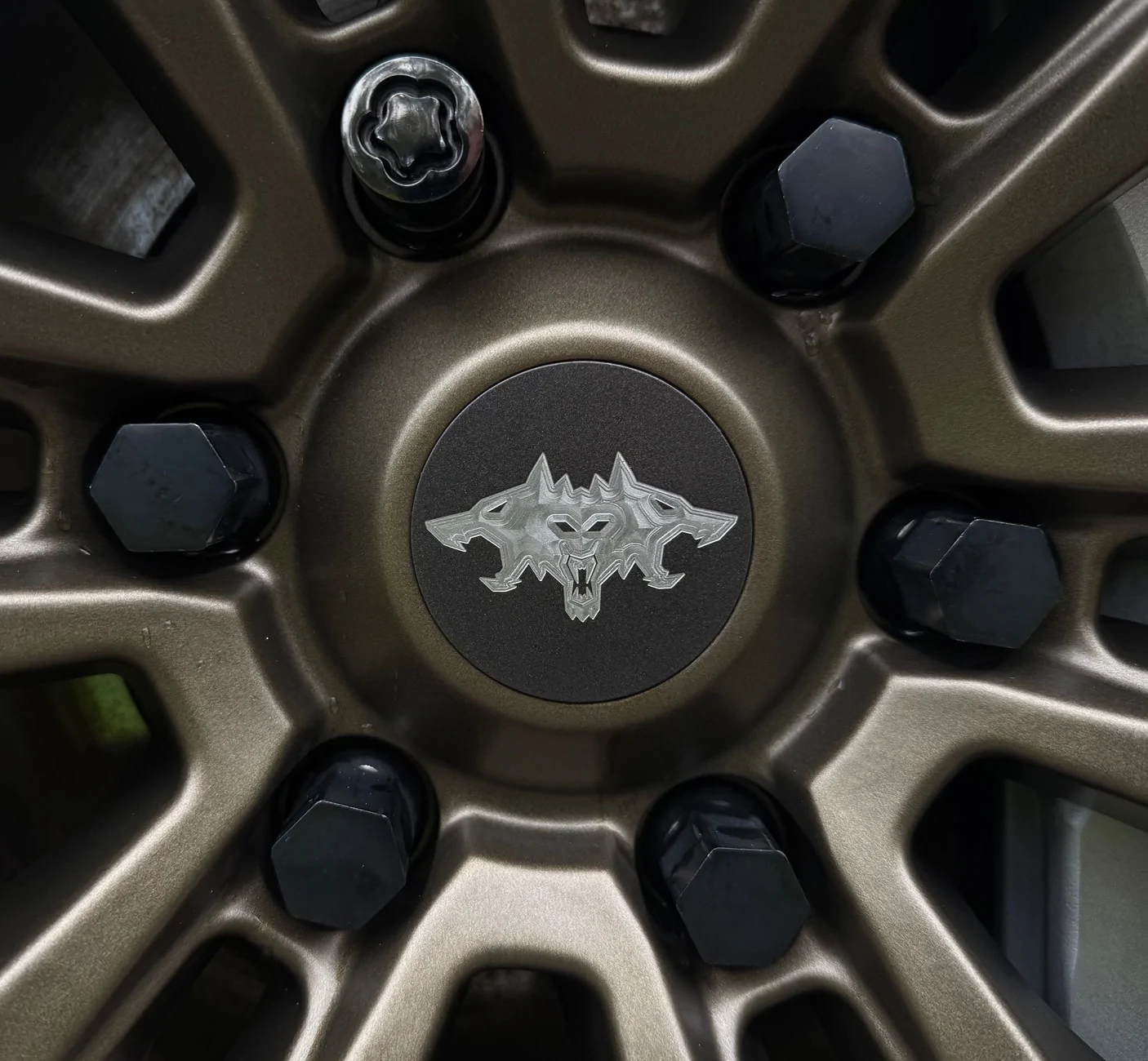

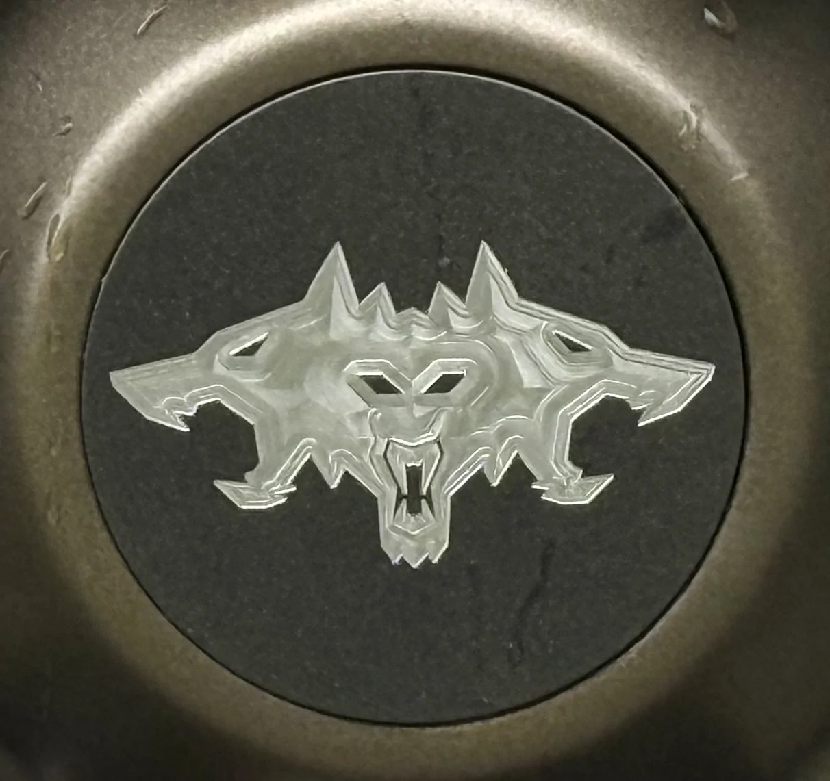

A couple members have asked about my trucks new wheels. They are 20” Cyber Rovers (by Martian Wheels). As is usual for me, they were not exactly what I was looking for, so I ended up tweaking them a bit more to my liking. The style is very similar (if not identical) to what is on the Dodge TRX. I wanted them in dark bronze, but they were offered in a much lighter Satin Bronze (also in Satin Black and Satin Gunmetal). When they came in, I immediately disassembled and sent the actual rim portions out for aluminum oxide media blasting. These were then re-powder coated using Prismatic Colors CT Bronze powder. I left the actual bead locks in the as ordered color (Satin Gunmetal). I replaced all the black coated carbon bead lock bolts with new brushed stainless steel bolts. I also made custom CyberBeast (Cerberus) logos that were milled onto stainless steel disks (these were powder coated prior to machining). Once finished, these were then powder coated in the same satin clear as the wheels. I removed the Martian Wheels logo from the inserts and replaced them with the new custom ones (using methacrylate adhesive). I completed them by mounting a set of BF Goodrich KO3’s tires onto them.
I think they turned out really good, and were exactly the look I was going for! They have completely changed the aesthetic of the truck.
