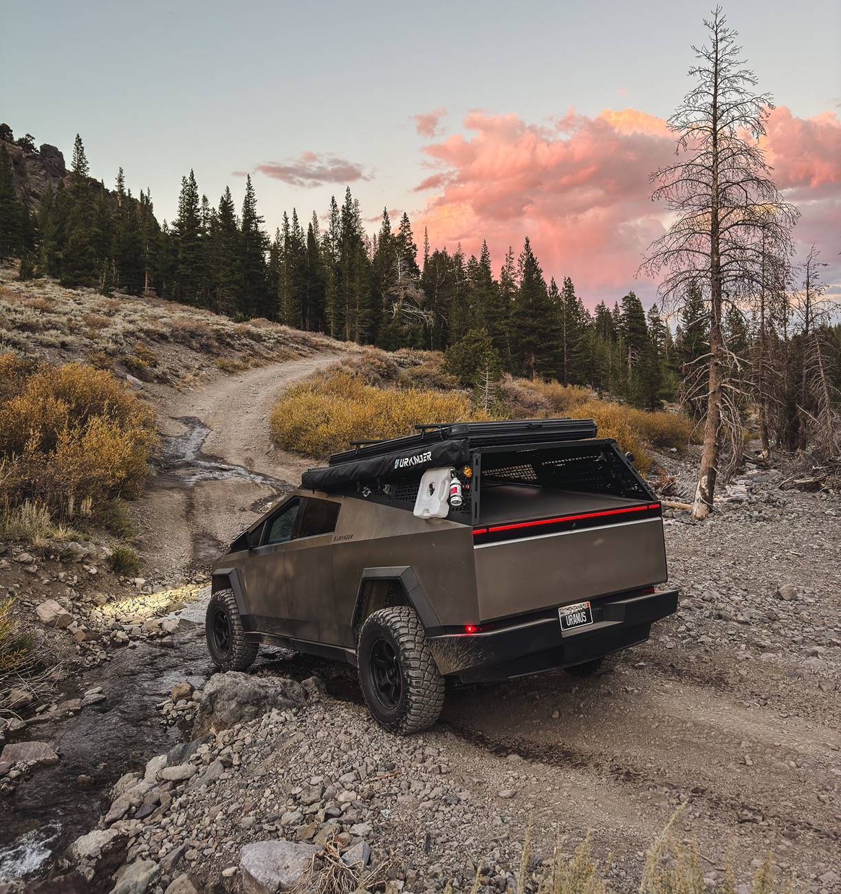

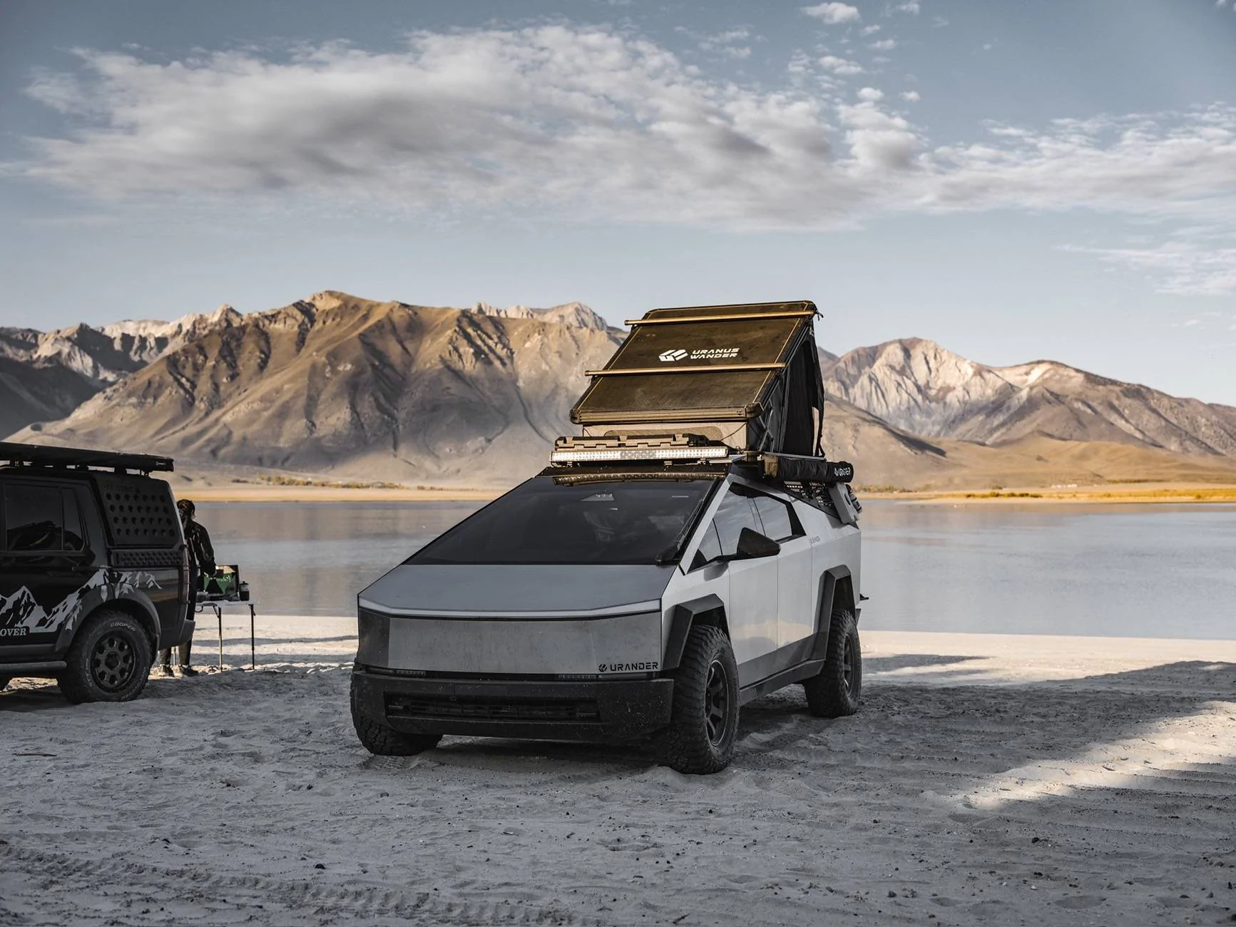

This is the first set of aftermarket wheels that looks better than OE covers. Well done.
super excited about it. So far not a sizeable range loss. Tracking and will report back after a few hundred miles.

Hell yes. This is the 200+ IQ tire / wheel choice. Imagine how this thing will crawl over rocks and sand at 20psi with lockers on. I suppose the only thing better would be beadlock 18 “ wheels . Then we can get down real , real low in tire psi, basically caterpillar tracks.

Wheels: Fuel Rush 18x9”, +20mm offset
Tires: Toyo Open Country AT3 35”X12.5”
Fitment: removed harmonic extension and other than a very light rubbing on the backside wheel well at full lock it needed no modification. Little heat gun and press was all that was needed.
Range: TBD
That looks really good, great combination
