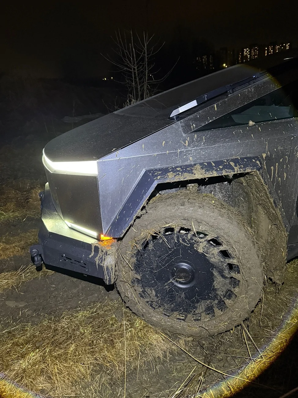

Will this fit my summer wheels?
Tesla Cybertruck Powder Coated Brake Calipers DIY! JxkCd
