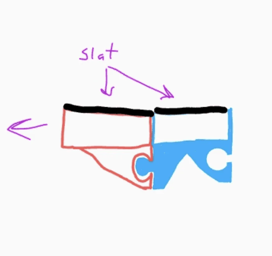

Yeah, hopefully, Tesla doesn't go with a slat stack like Rivian though it would eliminate hinges. My current cover, while covered with a soft looking vinyl, has the hinges below the surface so the top surface is completely flat. The CT will do this as well. Hinges go kind of like this:
Well, even if they don't, it only needs to expand, not contract, or stack like the Rivian one. All the way through hinges reduce the problem of one side getting ahead of the other.

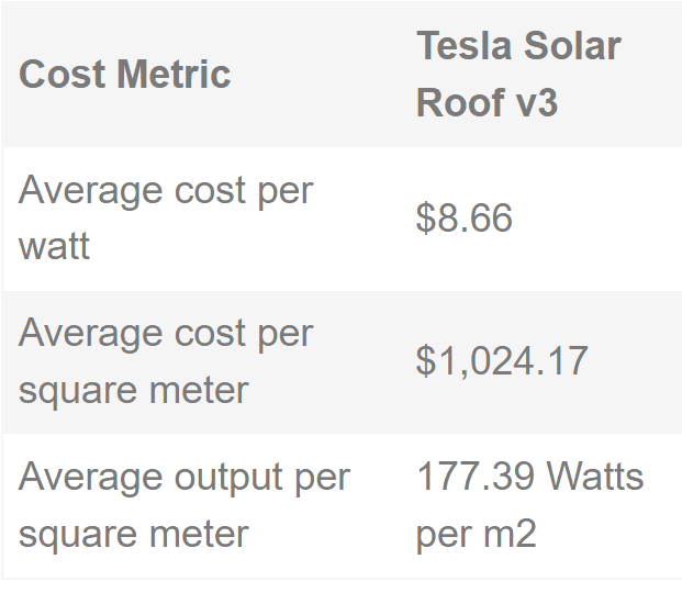

I think cover may be constructed using Tesla roof tech.
My estimate 59" x 71" 150cm x 180cm = 2.7 sqm
2.7sqm x 177.39watts = 478.9 watts
That would generate roughly 4 kWh/ day. That would be about 10 - 15 miles/ day depending on efficiency so it’s a good ballpark.
