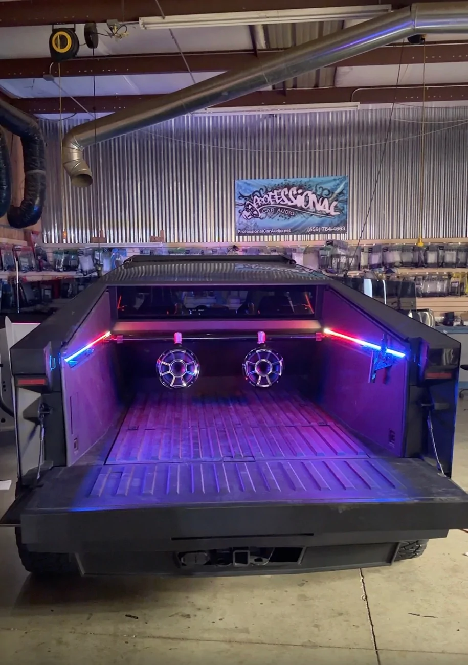

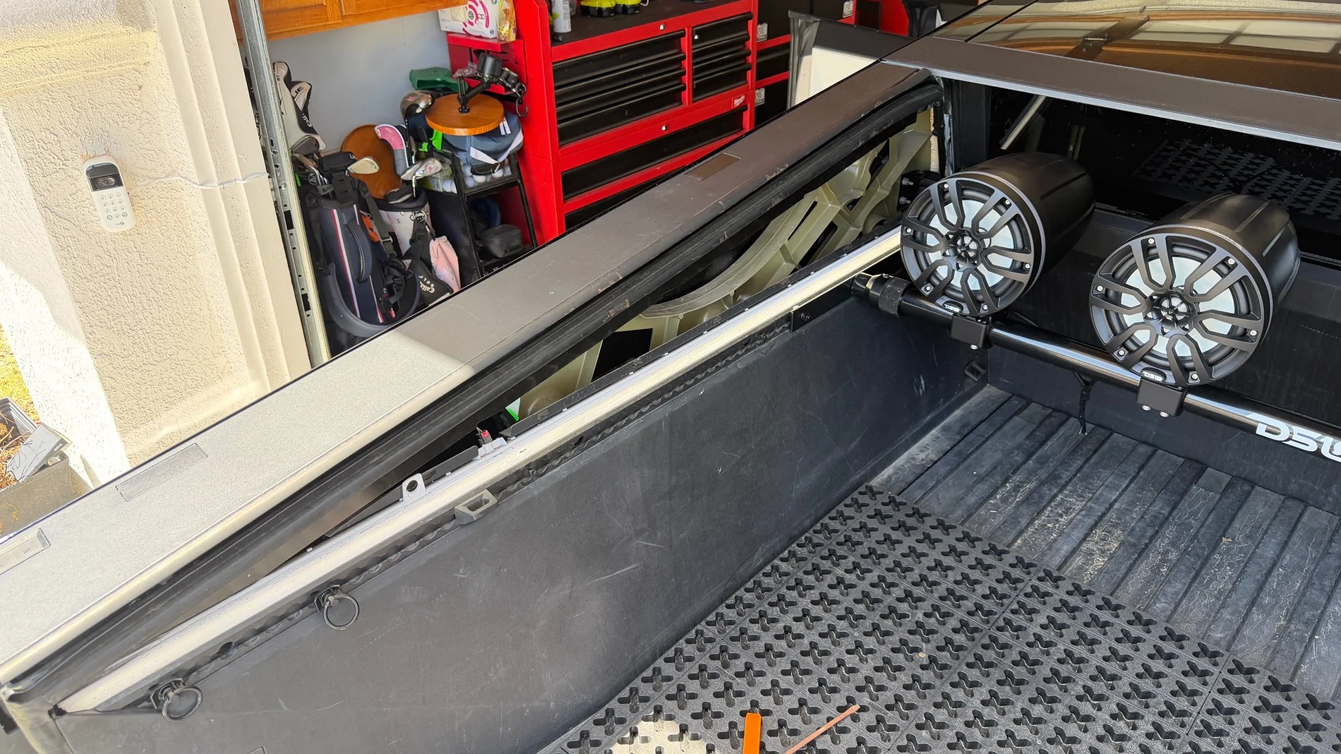

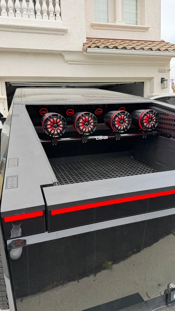

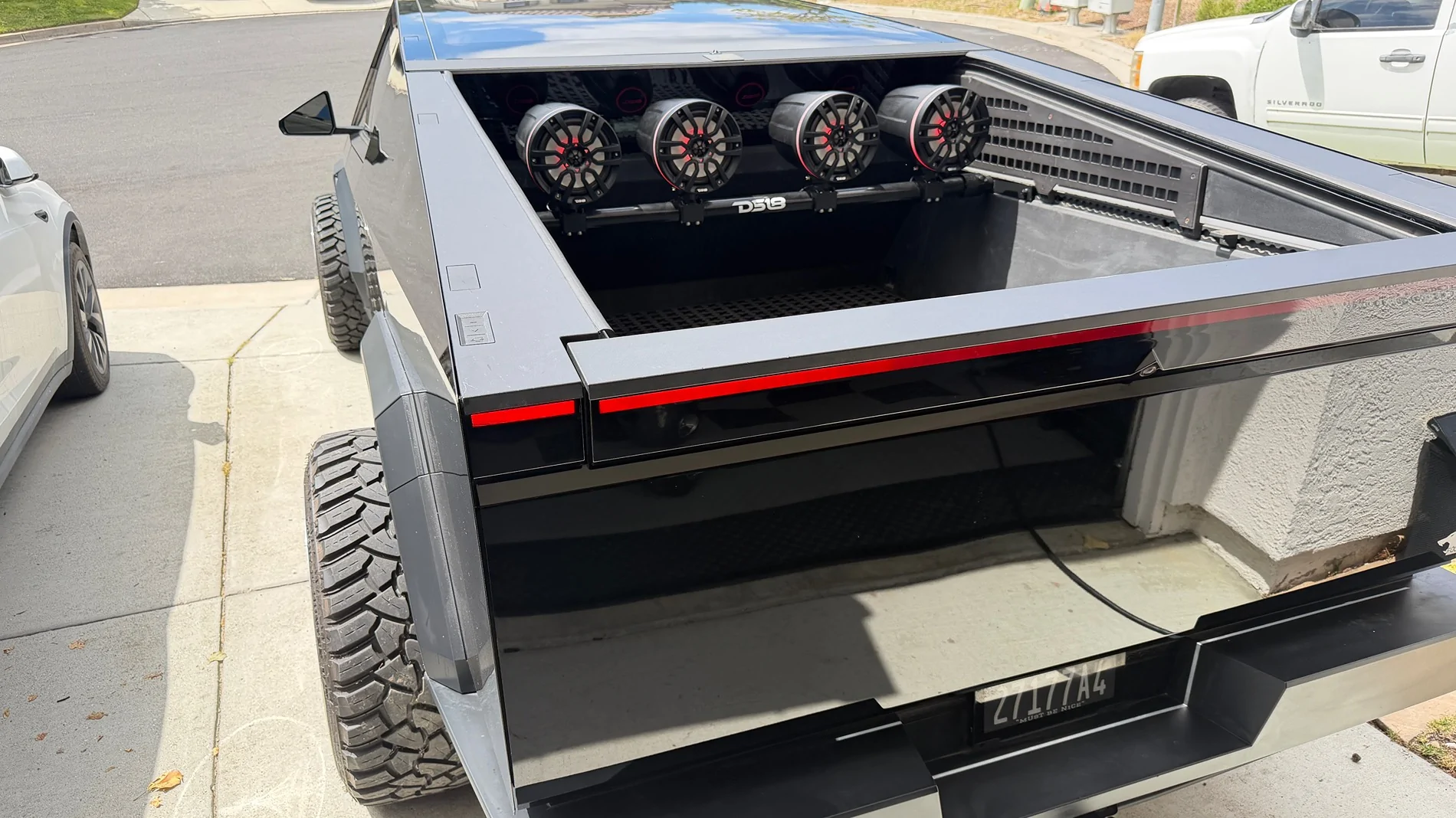

(4) DS18 RGB marine 8’s, powered by 1,000w Bluetooth amp. Independent of the interior sound system. May tap the boombox speaker feed in future and also add a marine subwoofer.
Tonneau clears the tower speakers and closes in last video

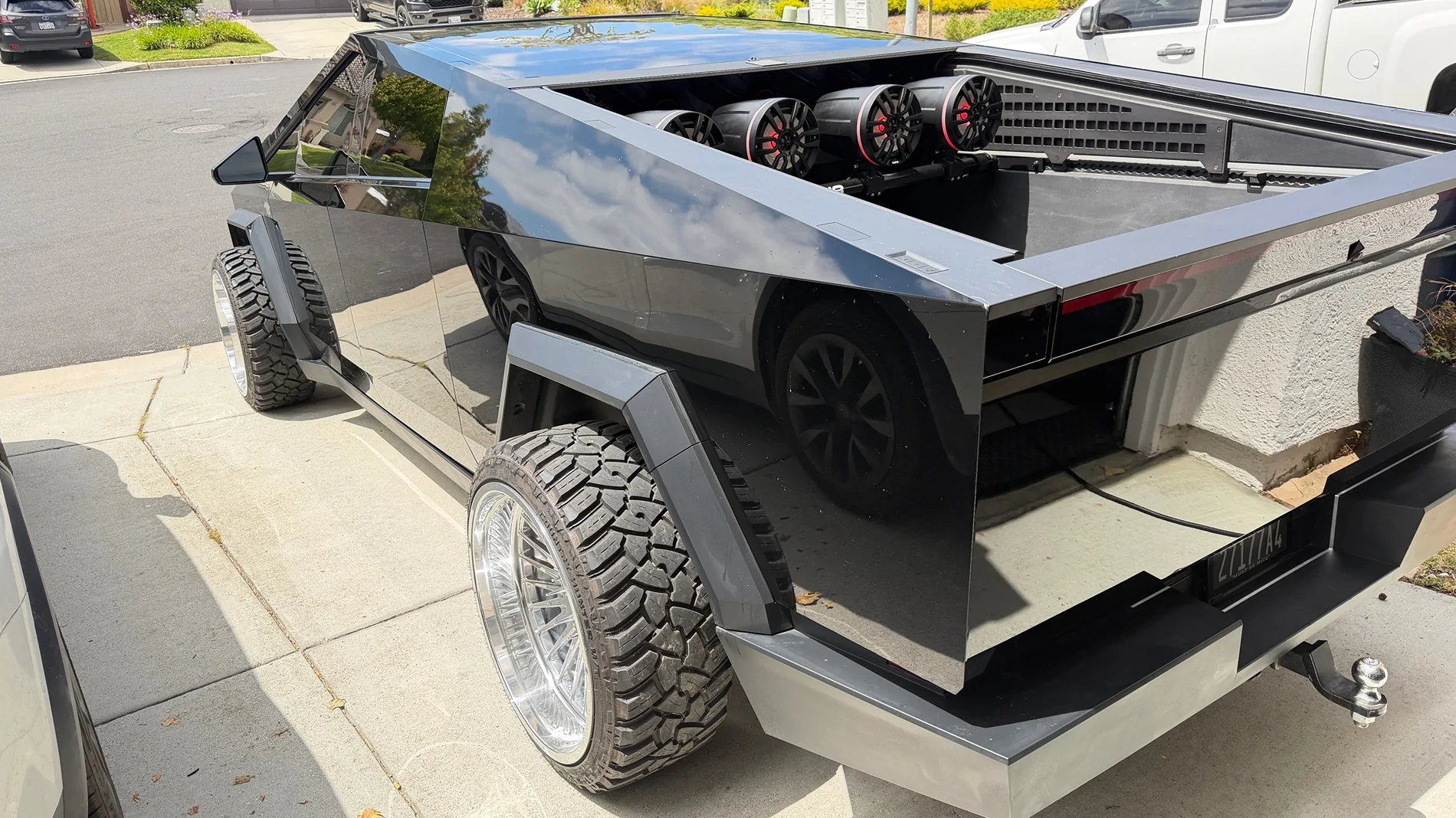

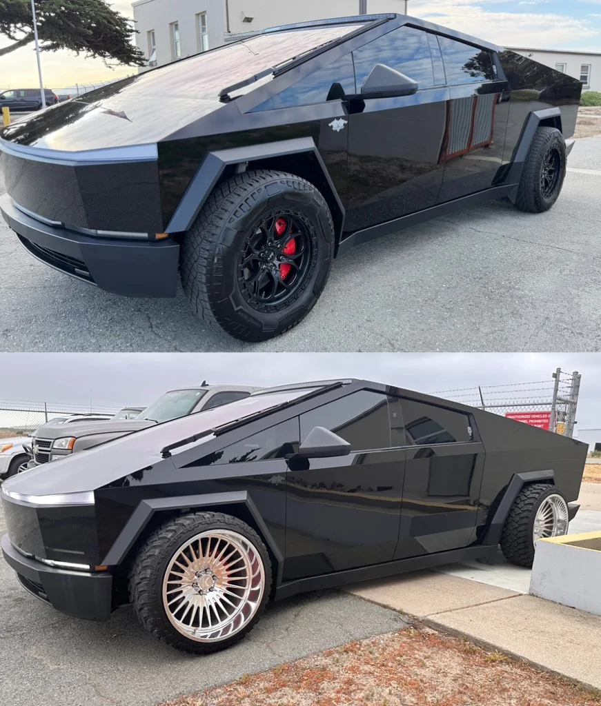

What tire/wheel size is that and how did you get it to clear on full turns?
24x12 on 33x12.5 -44 offset. Slight rubbing at full crank. Less rubbing when in Low setting. I’ve got a set of 20x10 on 35 for winter/towing

Gonna need you to tow someone on a wakeboard so I can see it in use :)

O hey twins 😎 Looks dope man my Rev10’s where too big to flip like that unfortunately.
That is a bummer! I was concerned 10’s would hit the tonneau and opted for 8’s and they are close. I’m sure the 10s do hit the tonneau if up.
I wanted to do rev8s but with 4 speakers, it was gonna be kinda stupid $. I didn’t like how rev8s had no lighting either

Really nice setups Cyberbully & CyberRN! Can you give information on power supply source and wire routing?
CyberRN, how about details on the RGB light strips?

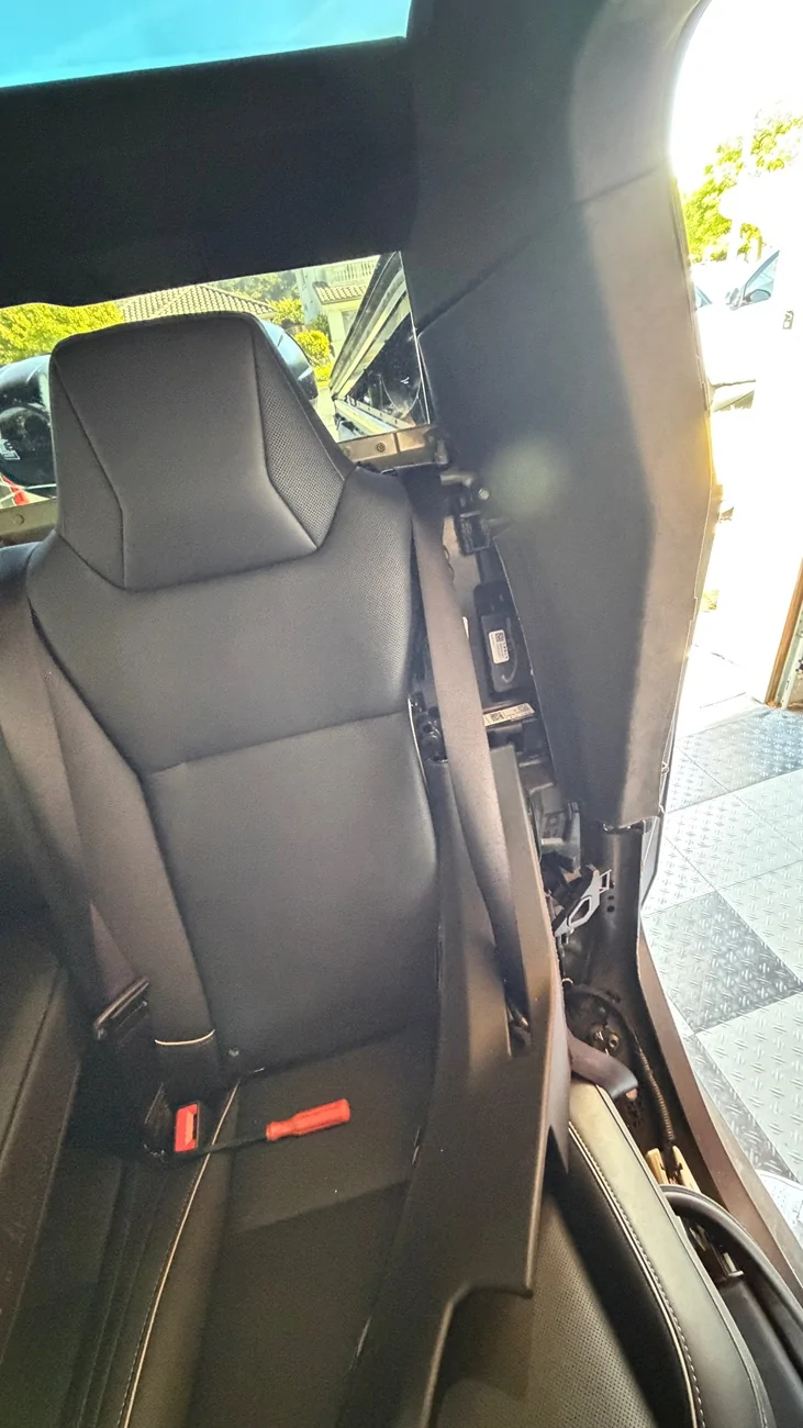

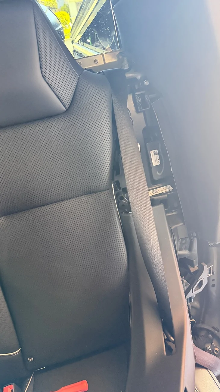

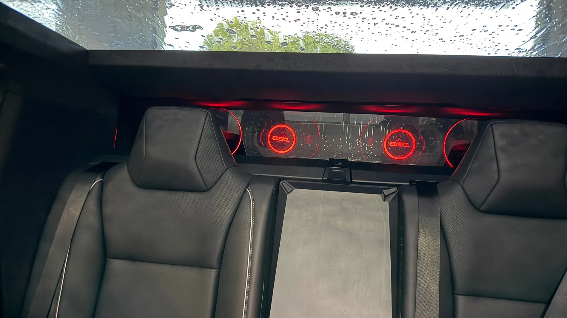

Thank you. For power source I had to use the 120v rear outlet and a 120v to 12v converter. Then power my amp off that. The 120v outlet has much higher wattage than the frunk power feed. And the outlet can be controlled by Tesla app or set to turn on outlets when truck is powered on/off. Like running an ignition controlled wire.
For wiring, I removed interior bed sail panel. It just pops off with clips. Then fished the wires into the cab at rear seat on drivers dude. Above rear seat shoulder area. Then ran wiring down behind seat to under seat storage box where my amp and 120v converter are inside

Thanks for sharing your process. You definitely found a great way to put it together.
