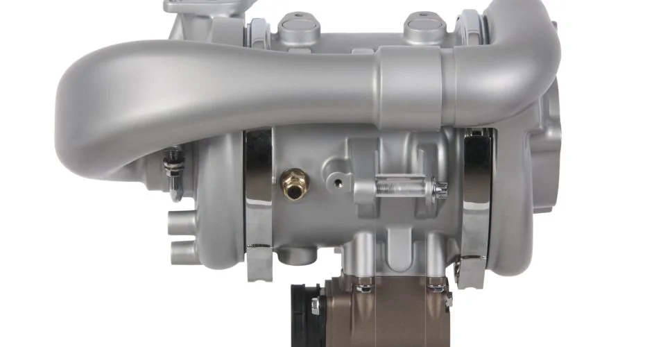

Two Stage Electric Compressor for Fuel Cell Electric Vehicles
Key Features
Garrett’s design innovations have helped reduce the size of hydrogen fuel cell stacks by 40 percent over predecessor systems, simultaneously generating significant gains in constant power ratings.
Our Two-Stage compressor can operate up to 20kW continuously and supply air at over 4 bar, helping to increase in stack power density.
Proprietary airfoil bearings result in a dramatic reduction in compressor noise, and run without oil, eliminating the risk of fuel cell stack contamination.
Tesla Cybertruck A Turbocharged Hydrogen Fuel Cell Honeywell_TwoStage_Electric_Compressor_V475324-930x500
INCREASED POWER & EFFICIENCY IN A COMPACT DESIGN
Two Stage Electric Compressor for Fuel Cell Electric Vehicles Benefits
Our Two-Stage electric compressor boosts fuel cell stacks to higher pressures and flows, significantly improving efficiency and power density and enabling downsized packaging to fit and drive the electric powertrains of regular-sized vehicles.
The result is improved driving performance – and a major step on the pathway to a zero-emissions future

The idea is that higher pressure operation means more specific power. For the same amount of power out a smaller fuel cell stack + turbine is smaller/lighter/less expensive that the larger stack that would be required sans turbine. If that does not turn out to be the case then they aren't going to sell many.
IMO hydrogen cars are dead so the application for this would be in trucks, maritime etc.
