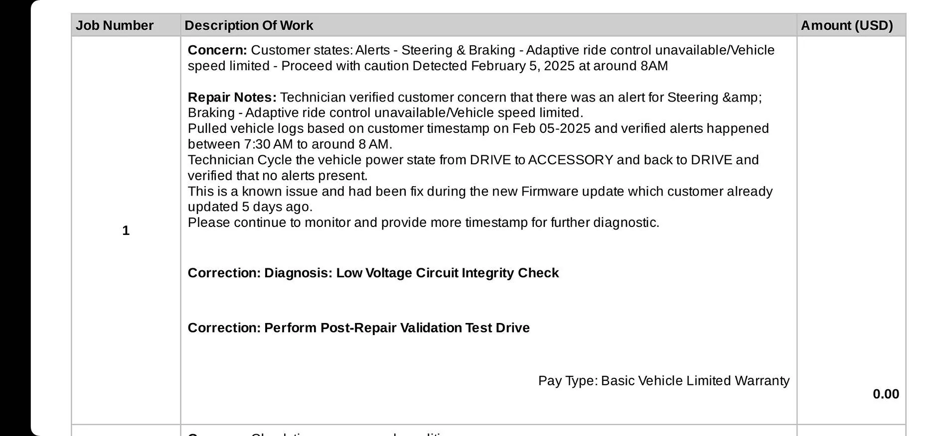

I got this alert again on Feb 5th and took it in. They claim it was fixed in the latest software update 2024.45.32.15.
Tesla Cybertruck Adaptive ride control alerts - Dl_a250 and TAS_a314 Screenshot_20250217_125205_Adobe Acrobat
