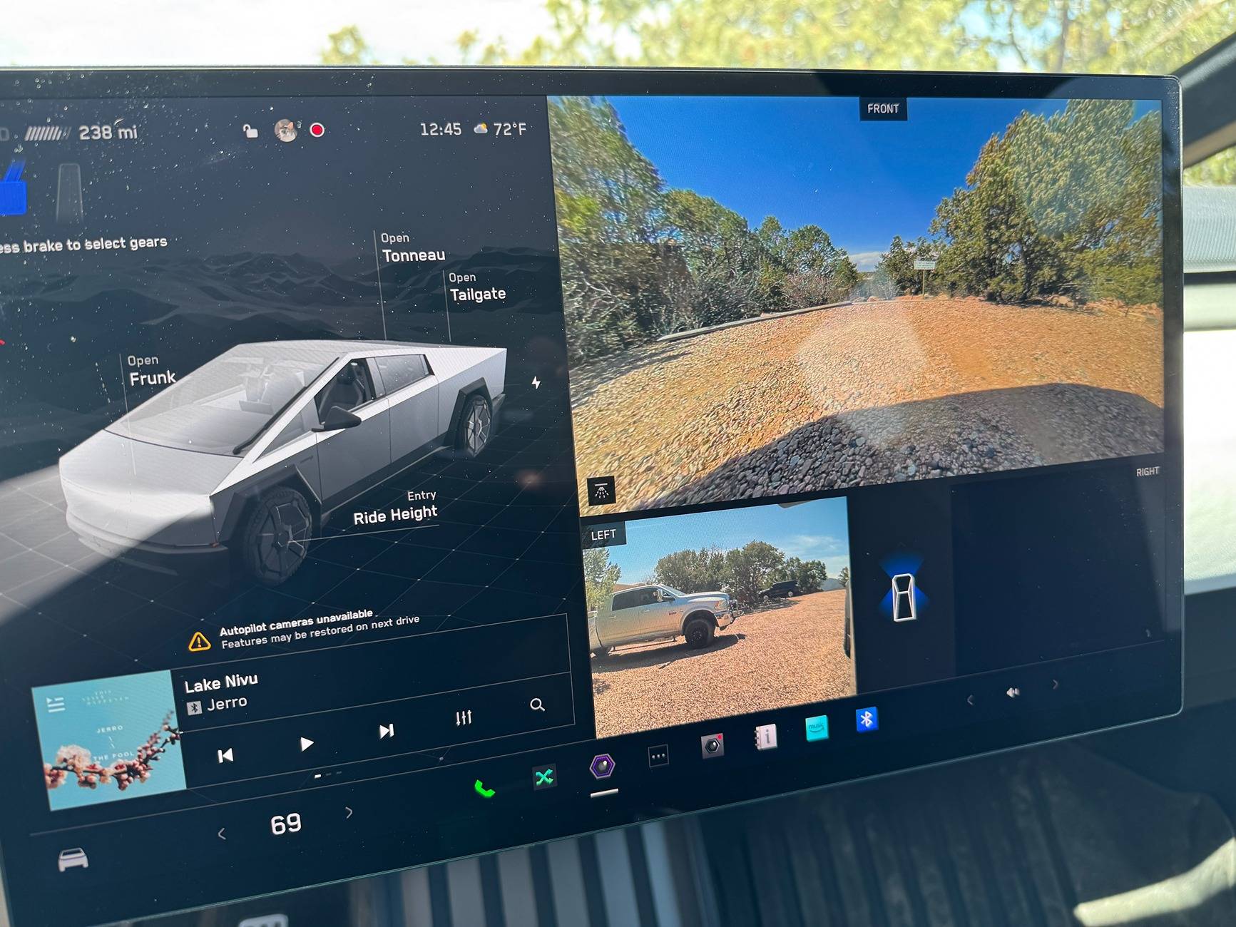

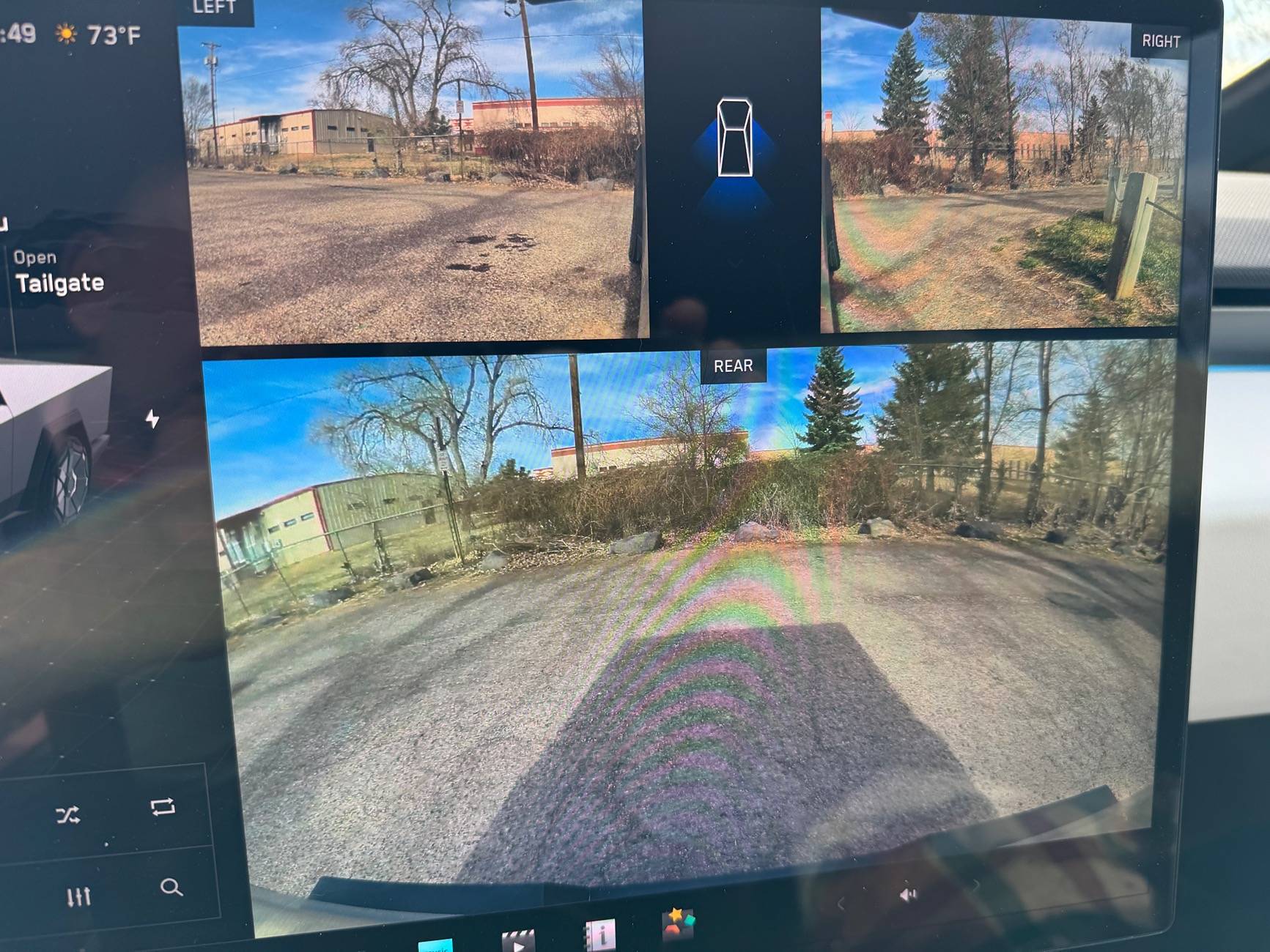

anyone else have this issue?
was wondering if this was a software issue or just coincidence. i did reboot the truck several times and drove a few miles but to no avail.
I do have a service appointment in a 4 days but concerned about sentry mode not working on that side due to all the crazy vandals.

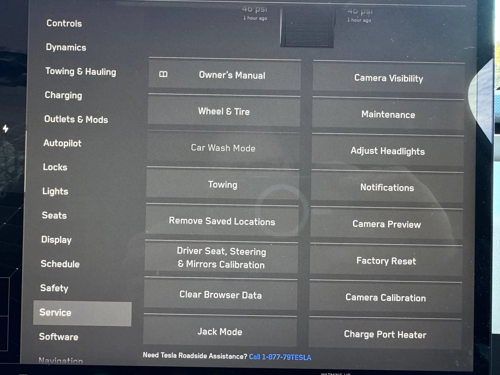

i don’t see that option
That's not Service Mode, that's the Service menu.
Go to Software > Tap and hold the Cybertruck logo for a few seconds > this should show a password prompt > type "service" (without the quotes) > This will put you in Service Mode
