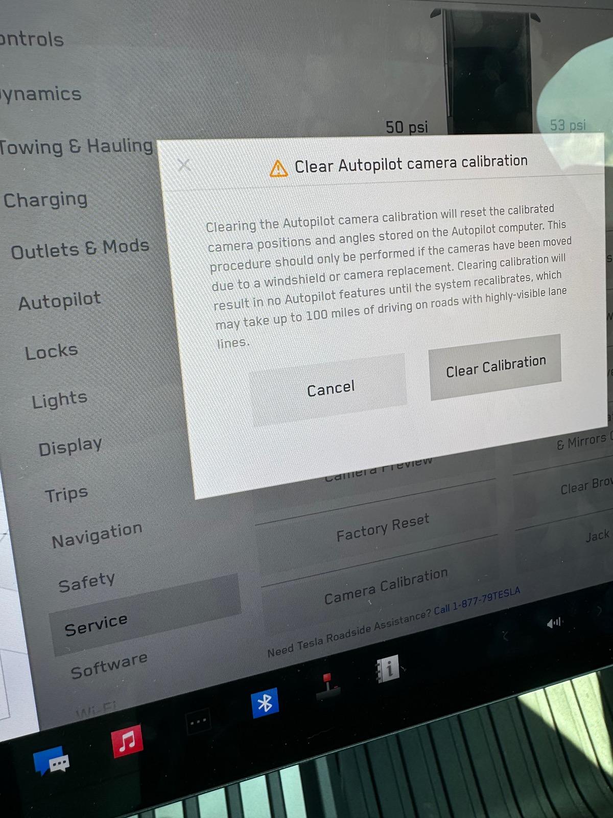

Tesla Cybertruck My cameras stopped working :( IMG_0095
You can also force a camera calibration from the main menu without using Service Mode, but IDK if this is the same thing.
