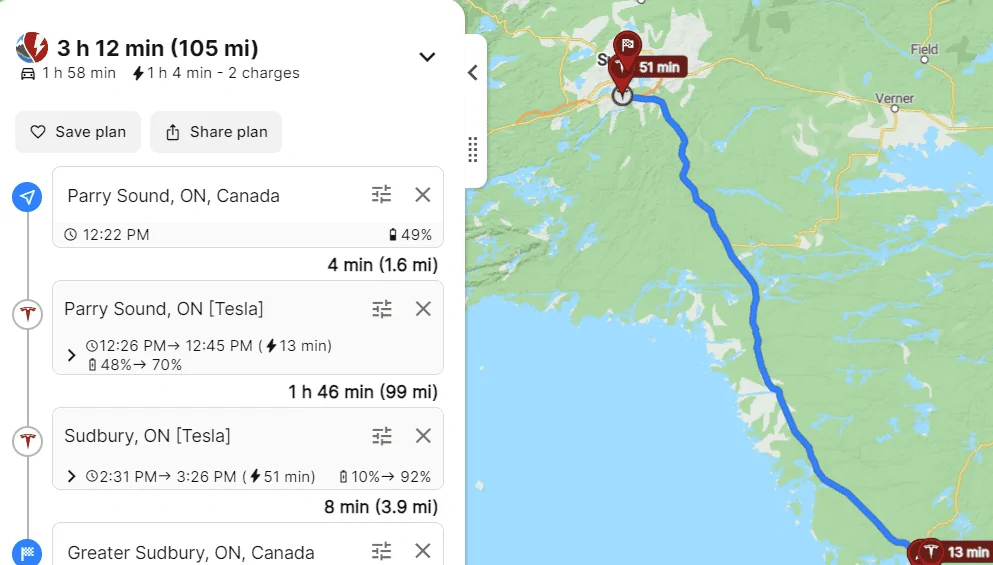

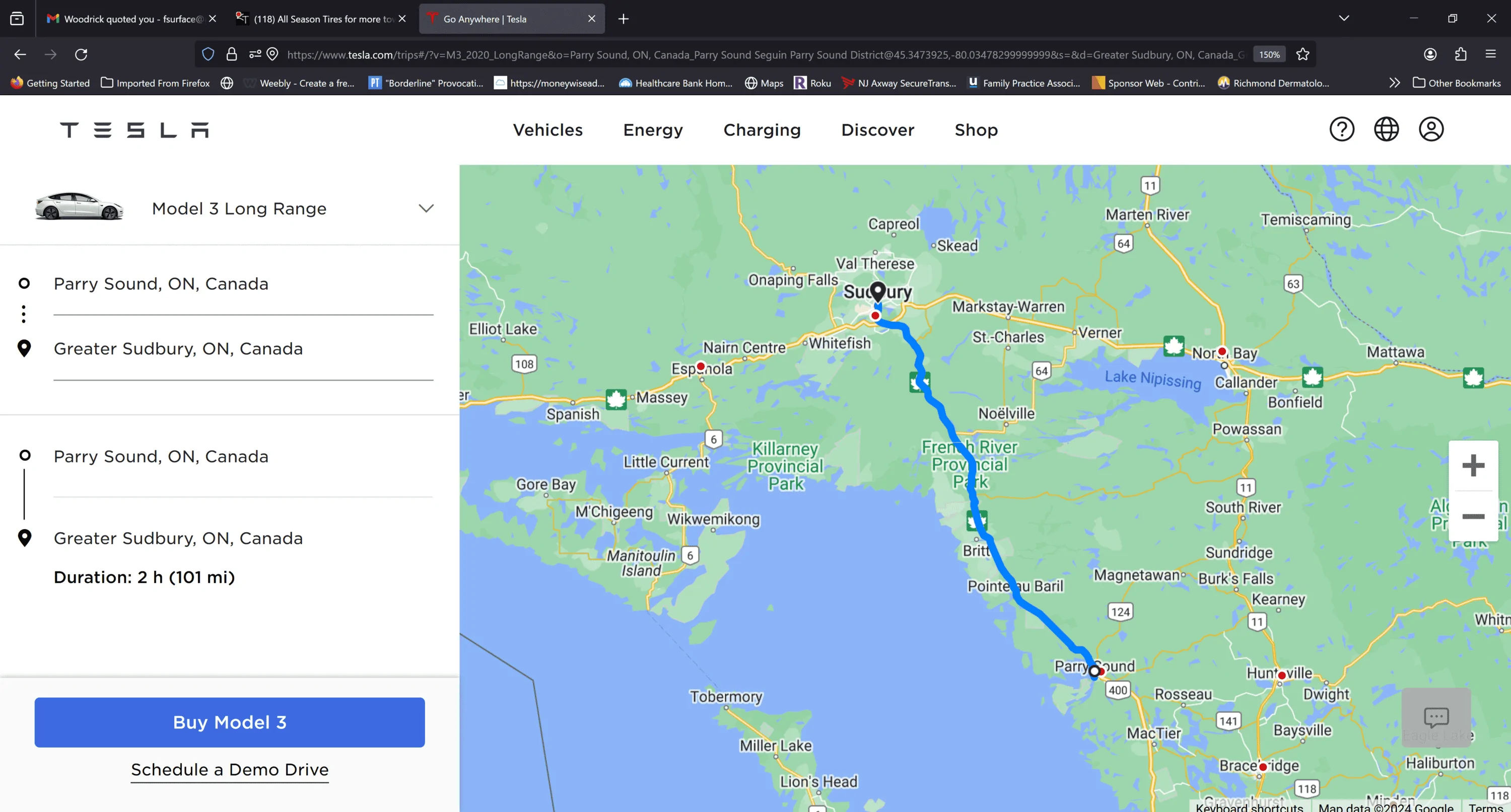

Well, it is across Canada first then back across the northern tier, probably not until next year though. These two look to be the furthest apart now on what will be our route. 101 Miles. We understand that we may be stopping at every one and we do have our aero styled hotel with us.

Making that long leg between Parry sound and GS you will need to make sure you have a full charge to make it with a trailer. Not a big deal if you live in Parry
Then if your numbers are correct, tire type may only represent a difference in fuel costs.
