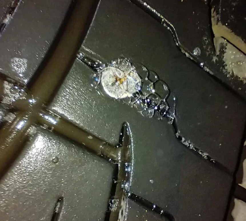

Got an alert that a tire was low, looked over it, found a screw (great).
BUT it was pretty much dead center of the tire, contemplated putting a plug in it myself but for $30 decided to take it to Tire Kingdom as they do Tesla/Rivian tires daily. Know how to properly lift an EV, foam lined tires etc.
Got a call 3 hours later that they tried two patches, and both failed. Suggested a new $555 tire, although suggested I buy it from Tire Rack as they did not stock it, so no real financial motivation on their end?
Anyway, anyone had an issue getting a tire patched? Service guy says he buffed inside down to clean rubber, did all usual steps, has been plugging tires for 15 years but this "is an odd tire and no idea why it is still leaking, maybe the patch nipple will fatten up and stop the leak"
Pics of the before below.

Just a data point for other owners out there.
ONE new Core wheel from Tesla is over $600
Dodge those nails in the road and watch FSD closely for curbs

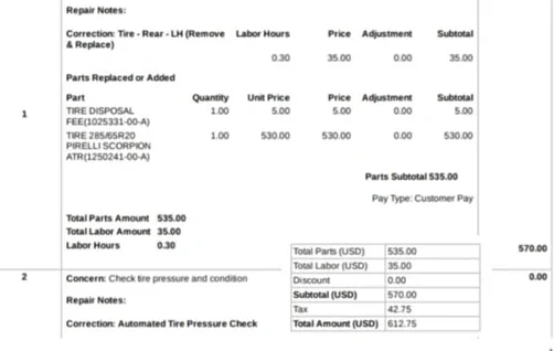

Supposedly with EV tires (lots of torque) patches with a plug component are the way to go, unfortunately didn't work and had to cough up $600 for a new tire.
Gigahorse
Gigahorse
Dec 19, 2023
2,828
3,186
AWD
Final cost was $612 for a new tire, after having a screw dead center in the tread on a newish tire with less than 2k miles on it that stung.
Most concerning was the lack of availability of the standard cybertruck (core) tire from any shop other than Tesla.
