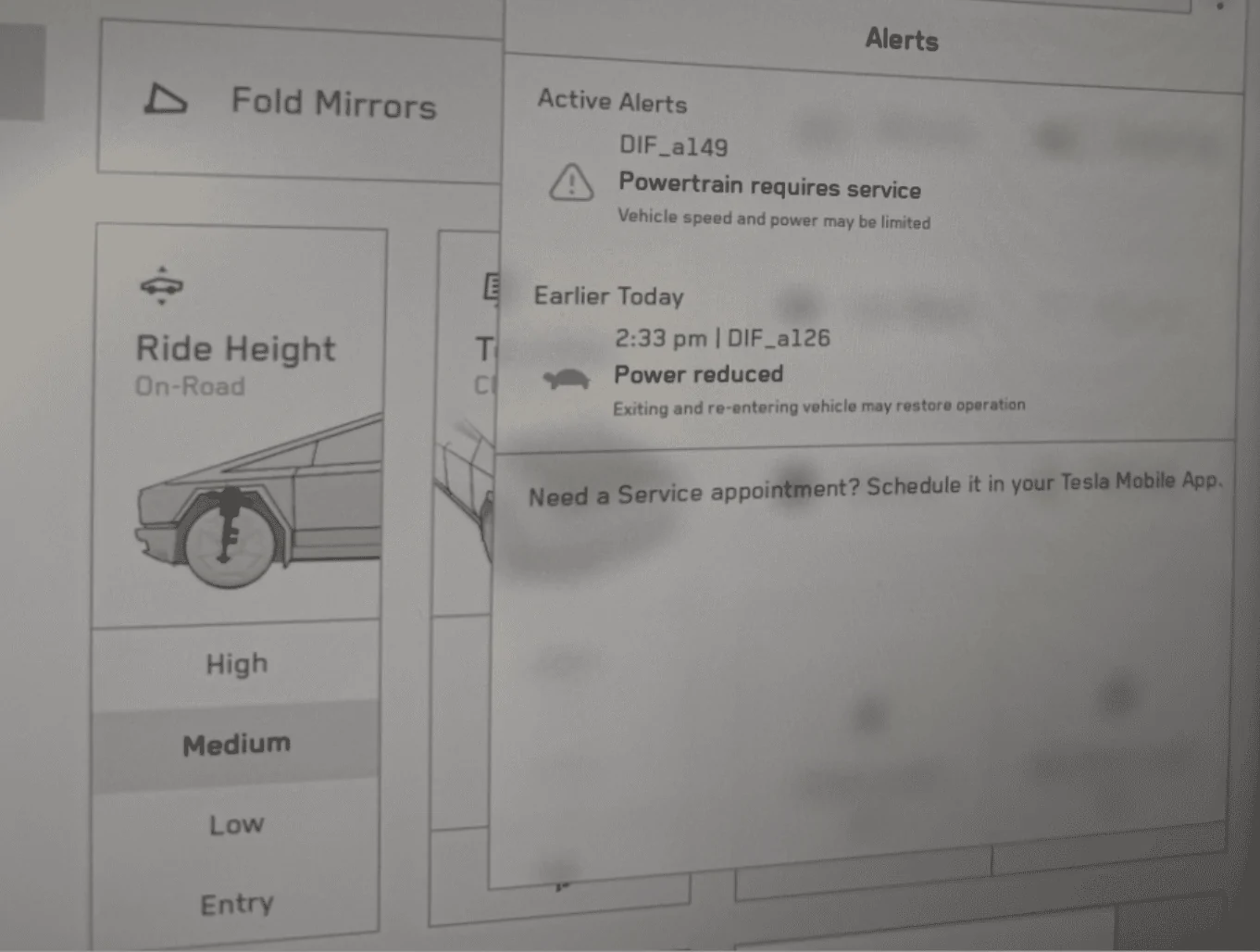

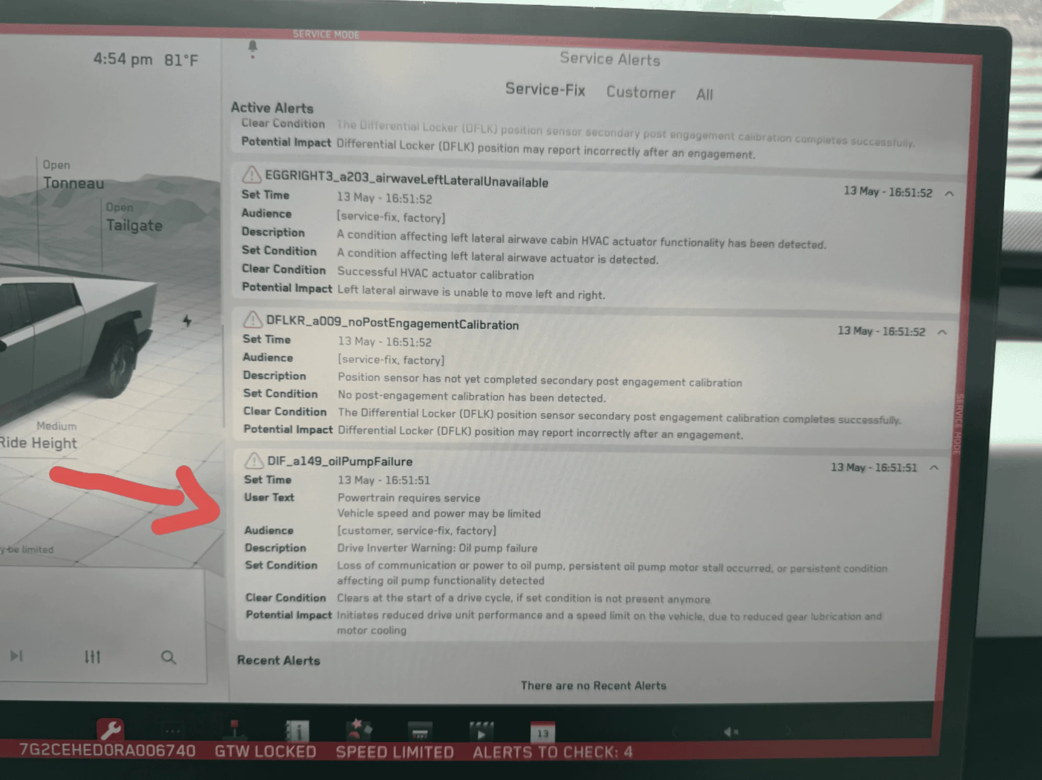

I think we have the same problem, alert code 'dif_a149'?
My truck has been in service since May 20th and will be kept there throughout this week too as I was told today. So, it is expected to spend half of the first month ownership in the service center.
I picked up my truck early this month after the accelerator recall AND some 'unknown' delay and drove it about 2 weeks and 800 miles. This alert occurred twice and resolved itself both times. It seemed to me that it happened every time I washed the truck with a pressure washer at home, but the service center said it's not the car wash.
So far, the service center staffs have been helpful and responsive. I just hope that I can get the truck back soon.
I just had a Fluid warning. They are saying they have to replace my oil pump in my front motor. I have just started to go to a car wash once or twice a week now that there is salt on the road in the midwest. I am wondering if it is the same thing you are experiencing. How did yours work out?
Car wash at home with a regular electric pressure washer caused this issue on my truck.
SC replaced the oil pump, and the problem has never resurfaced in the last 7 months after the service work.
Good Luck!
