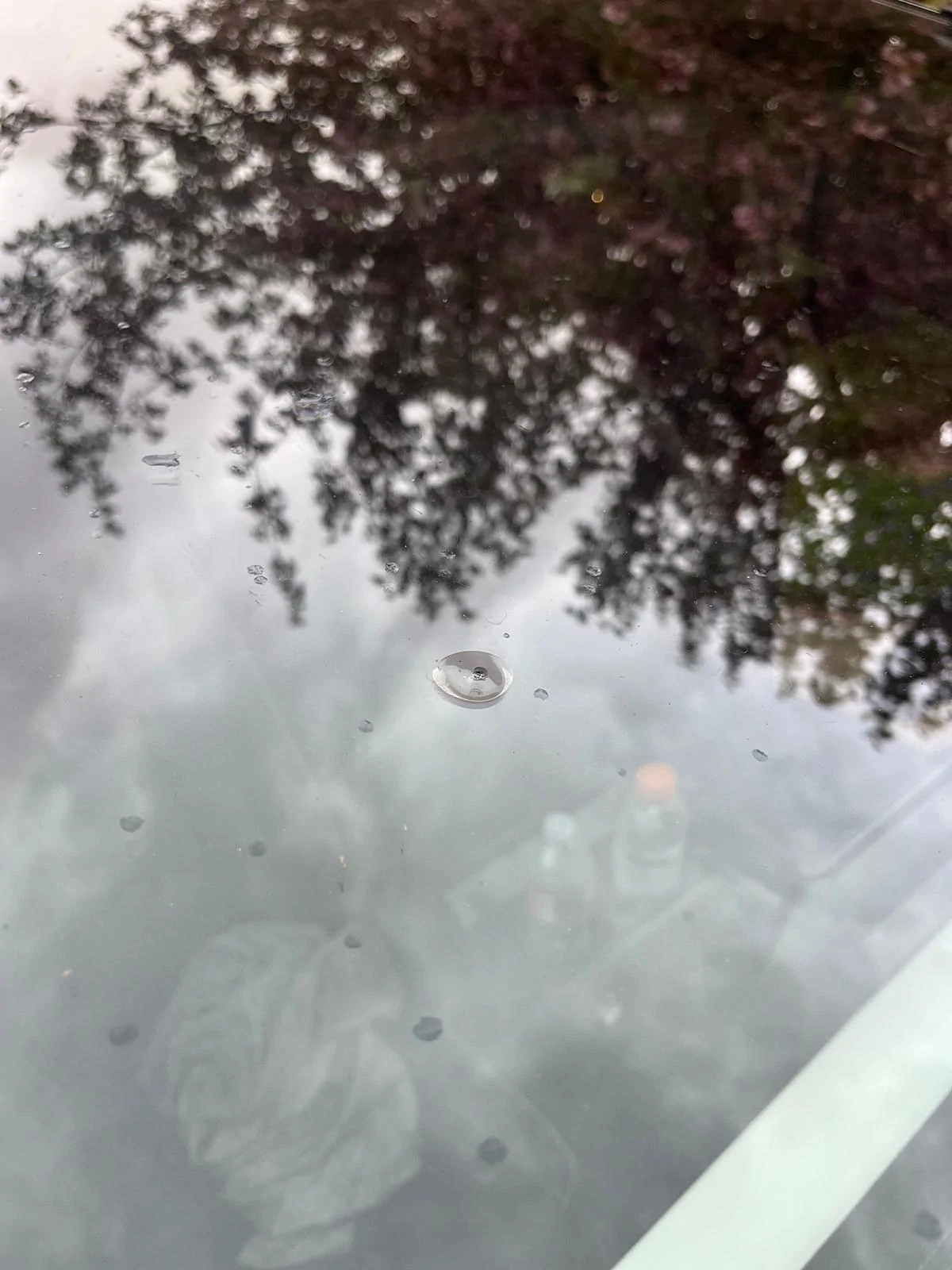

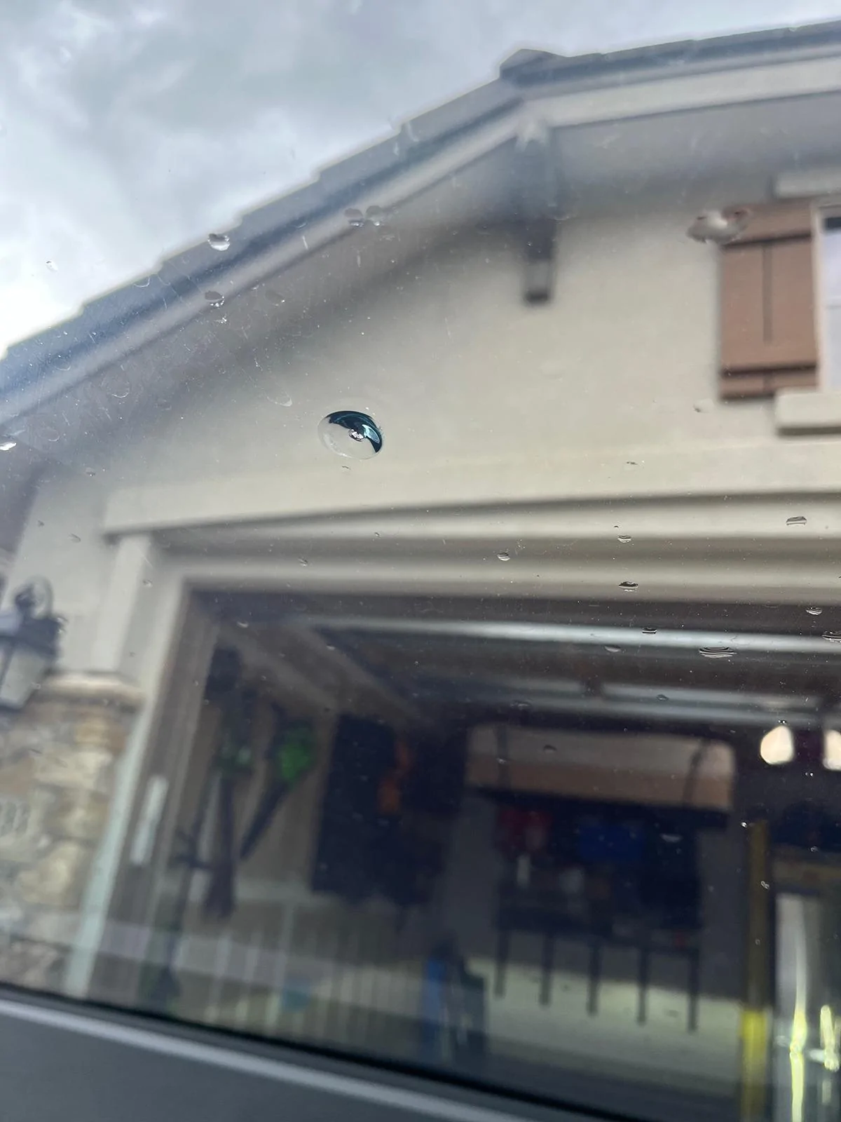

I had hoped the windshield was a little stronger!!!
A small rock caused a chip. My baby!!! She is only three weeks old.
No, it wasn't a steel ball rolling down the highway from Franz. Has anyone replaced a windshield yet? Any advice?

I'm curious if a normal auto glass resin repair kit that uses a small syringe will fix it. They sell for under $15.
The borosilicate infused windshield glass in supposedly a lot stronger than normal automotive windshields. Tesla also installs them on the Semi.

Definitely doesn’t need to be replaced just get it filled

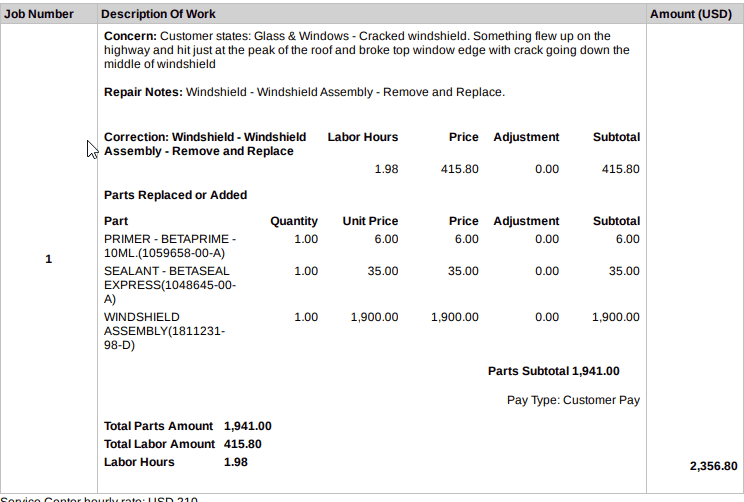

I just scheduled a replacement windshield. Not sure what flew up, but it hit right at the top edge and shattered the very edge with a single crack down the middle.
