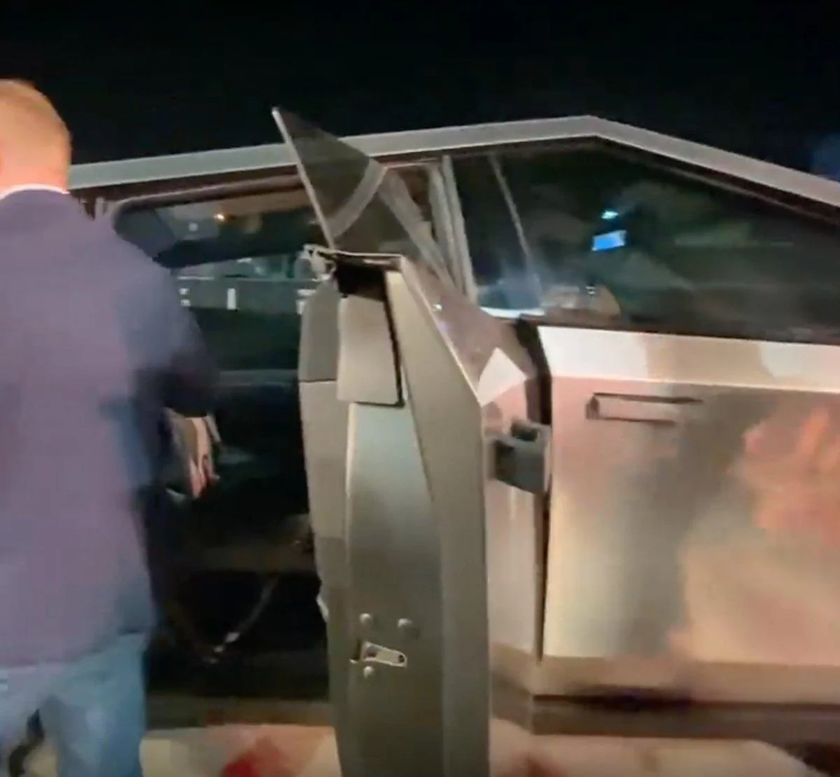

I assume the retractable door handles will not be manufactured entirely from stainless steel. They would be extremely hot (and expensive) to the touch if parked outside during the hot summer months. Maybe just the outer skin will be laser cut from 3mm stainless steel sheets to perfectly match the 3mm thick exoskeleton. It’s hard to tell from this low resolution night time photo. Being that the CT is a production vehicle they are probably a plastic composite that’s simply painted to match the exterior.
