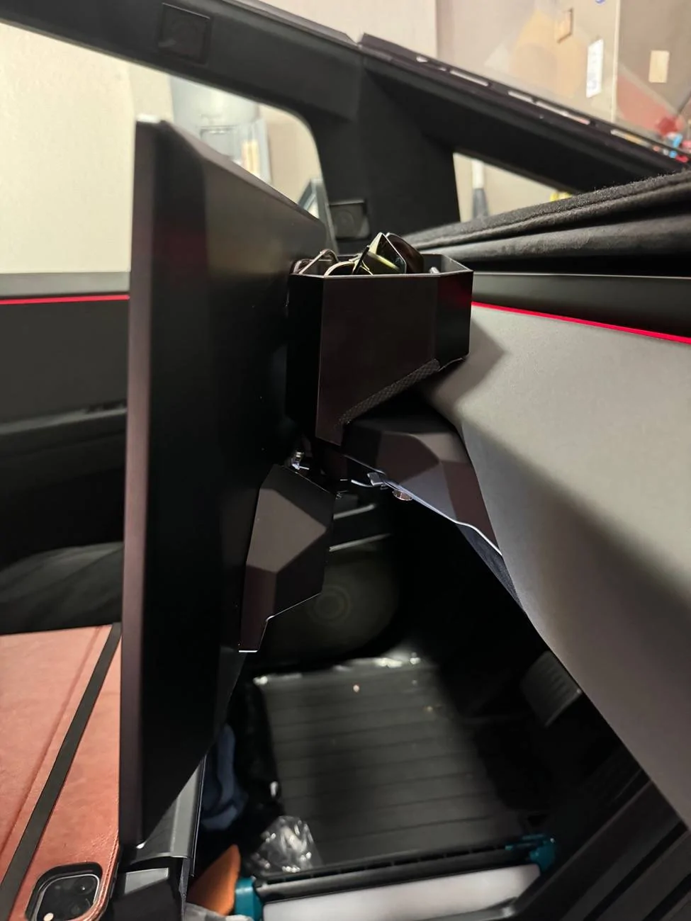

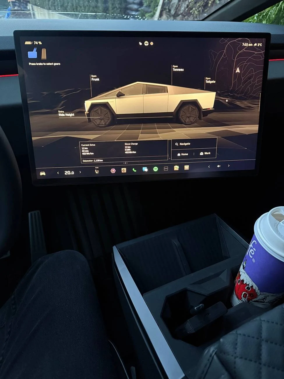

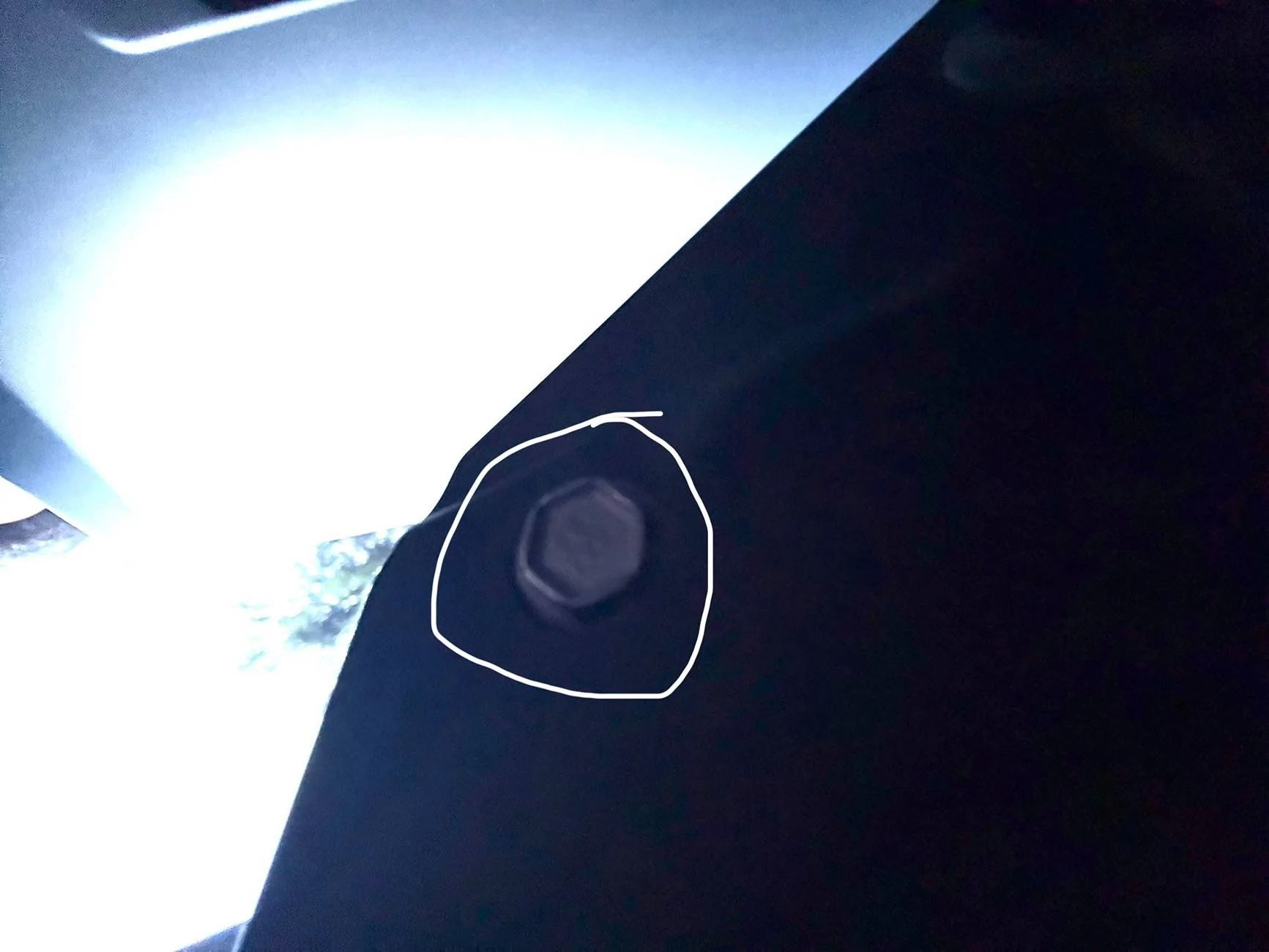

Hey guys,
I just got the @Anysix swivel display package installed yesterday and it's awesome. However, there is a change to the newer CTs that are coming out. The tool, an Alan key, @Anysix provides to remove the OEM bolts from the screen and fixture does not work. I guess my newer revised CT now only accepts a 10mm socket tool to remove. The original CT used to accept both 10mm and the bolt surface was indented enough for the larger included tool to fit. Just wanted to bring this to any CT owners who have their production date after 10/2024.
My model: 2024 CT AWD, Canadian, Built in the month of 10/2024.
Hope this helps.
