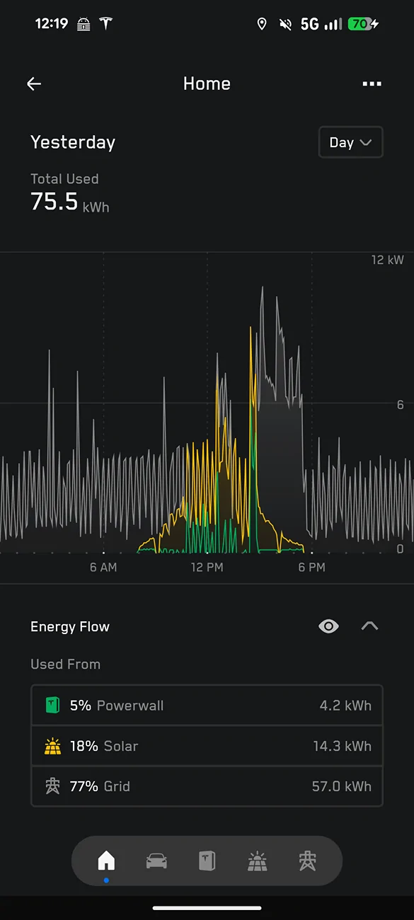

Obvious peak at 3pm when I start charging.

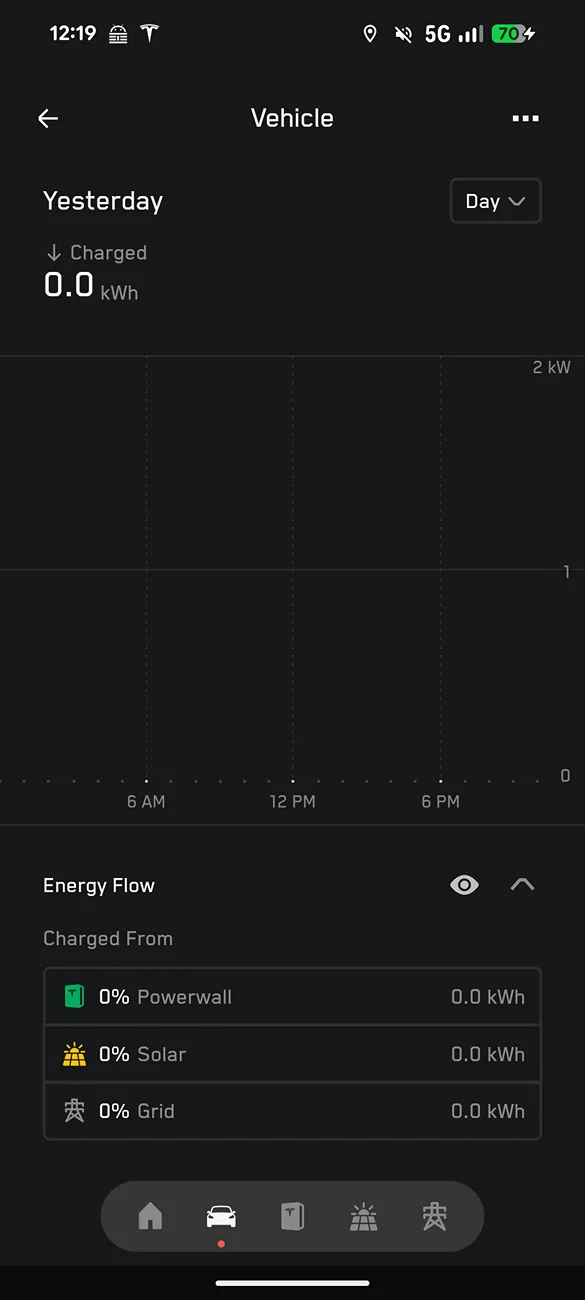

All I see on the vehicle tab.

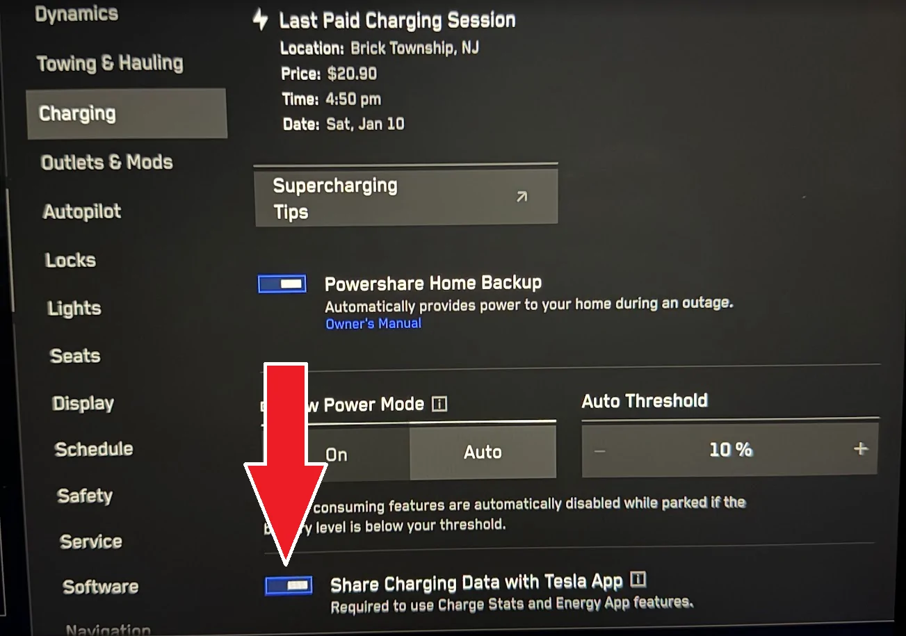

There is a toggle at the bottom of the Charging page in the car called "Share Charging Data with Tesla App" If off, turn on. If on, toggle off and back onto try to force the sync again.
Might also trying logging out and back in of the mobile app for good measure afterwords.

That seems to have done it. It was already on but I toggled it and now it seems to be recording properly. Weird that it stopped though.
