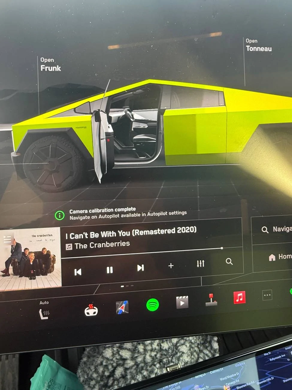

I have a 2024 AWD Cybertruck. Just got it back from service last week for the front and rear drive inverter recall replacement. It had no issues but just a preventative measure. They did it in 24 hour and I got it back no problem. Then a week later I drove on FSD 13.2.4 for about 50 miles, parked and came back to start it up. Had every error imaginable like a christmas tree, said the following and more were disabled: autopilot, fsd, regen brakes, blind spot, lane departure, etc. Truck was driveable and so I pulled over, did a soft reset and a camera calibration for good measure.
No issues and all errors were done, however I had to do the usual drive for a while to calibrate cameras until it was done. I received a Calibration Complete message and FSD was available again. Truck drives fine and now issue now. When I go to use Auto Park it completes into the parking spot and shows a message saying "Camera Calibration Complete, Navigate on Autopilot available in Autopilot settings". I have to then manually turn FSD back on. This is repetitive and does it everytime and there are not issues or errors with the truck at all. Just the message and the fact that it turns of FSD(without warning) when it Auto Parks.
Tesla has it in for inspection for this and they said they could not get it go away and to do a camera calibration again. I did that when I drove out and completed calibration and issue is back. In the Notes of the Service Summary it said to wait for next firmware update to resolve it.
Anyone else ran into this at all and any suggestions other than guessing and waiting for an update? I want to see if this is specific to my truck or something someone else has experience and/or resolved. Thanks!!!

You're not the only one. Some of us also reported this (FSD turning off) happening upon autopark a week or two ago.
Just gotta wait for a fix.

Okay, thanks as I searched and did not see it coming up. Thanks for the heads up!

My truck has been doing this since i got it a few days ago. Must be a bug in the software. No issues if i dont use autopark.

The service center told me that it will be a firmware update that fixes it in an upcoming update. I’m curious if anybody with the most recent 2025.2.8 update has this resolved, The issue is that FSD and Auto Park are on a different software stacks..
Likely when the “upcoming features” come out then it will be resolved is my prediction.

I have been experiencing the same issue. Took delivery two weeks ago. I remember reading that brand new Teslas are kept on whatever version shipped with it for some time before it gets any update. Might be some longer wait for me I guess.

Mine started for me when I did a calibration of the cameras. Prior to that, I did not get that error message.

Update on things. I’ve just upgraded to Software 2025.14.7 and FSD 13.2.9. When using Auto Park, I no longer encounter the Camera Calibration error. However, it still disconnects me from FSD, and I have to manually accept the Terms “Yes” to reactivate it.
This indicates that Tesla is making some progress in integrating these features gradually and working on them. I’m certain that the upcoming Robotaxi demonstration in Austin in June will further focus on this aspect!
