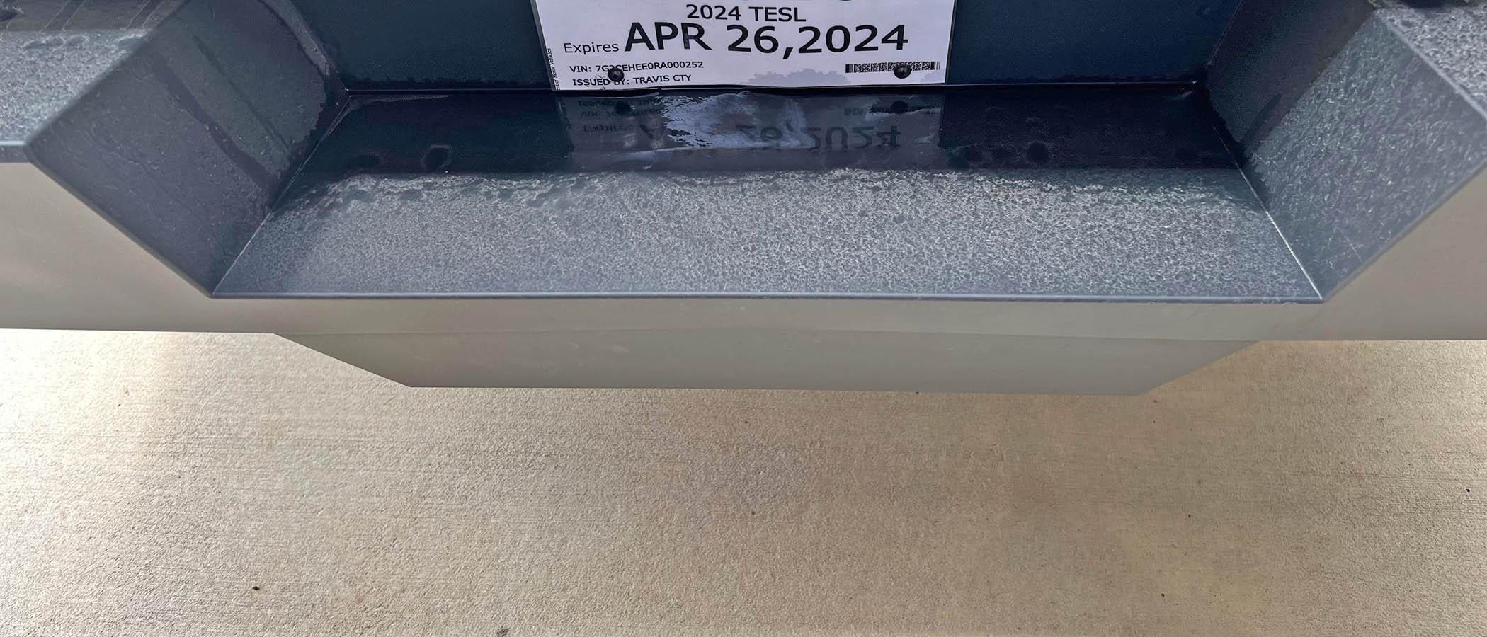

When parked on a grade/driveway, water does not have a way of draining as indicated above after a very short shower.
I wonder if we could drill holes in the plastic to give water an escape.

Couple 1/4" holes in each corner should fix that

Yea just look underneath first to make sure there is not anything back there, think that whole diaper is empty for future battery packs but make sure before you overdrill, or at least put a stopper on drill bit so you don't go through something.

That's what I did on the same spot of my F-150. Otherwise it turns green with algae if not washed every week. I used about a 3/16" drill bit, and it works, but I shouldn't have held back. I would probably use a 5/16" bit if I were to do it again.

Wouldn't holes up there just drain water into the hitch cover?

The hitch cover is designed to drain any water that finds itself in, regardless of whether the truck is pointed uphill or downhill. The Cybertruck's bumper cover is designed just like the one on my F-150. It holds water in the same spot above the hitch area if not parked facing uphill. I just drilled two holes in it to let the water drain. I haven't bothered doing this on my Cybertruck yet but I probably will before the winter rains arrive again.
