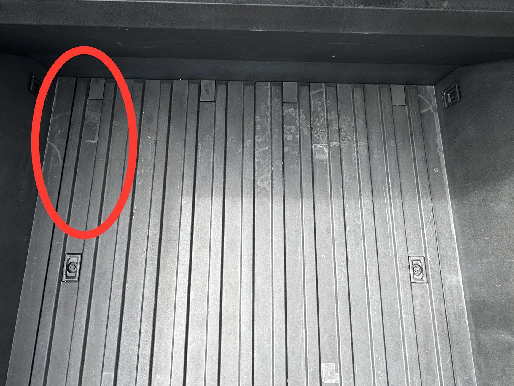

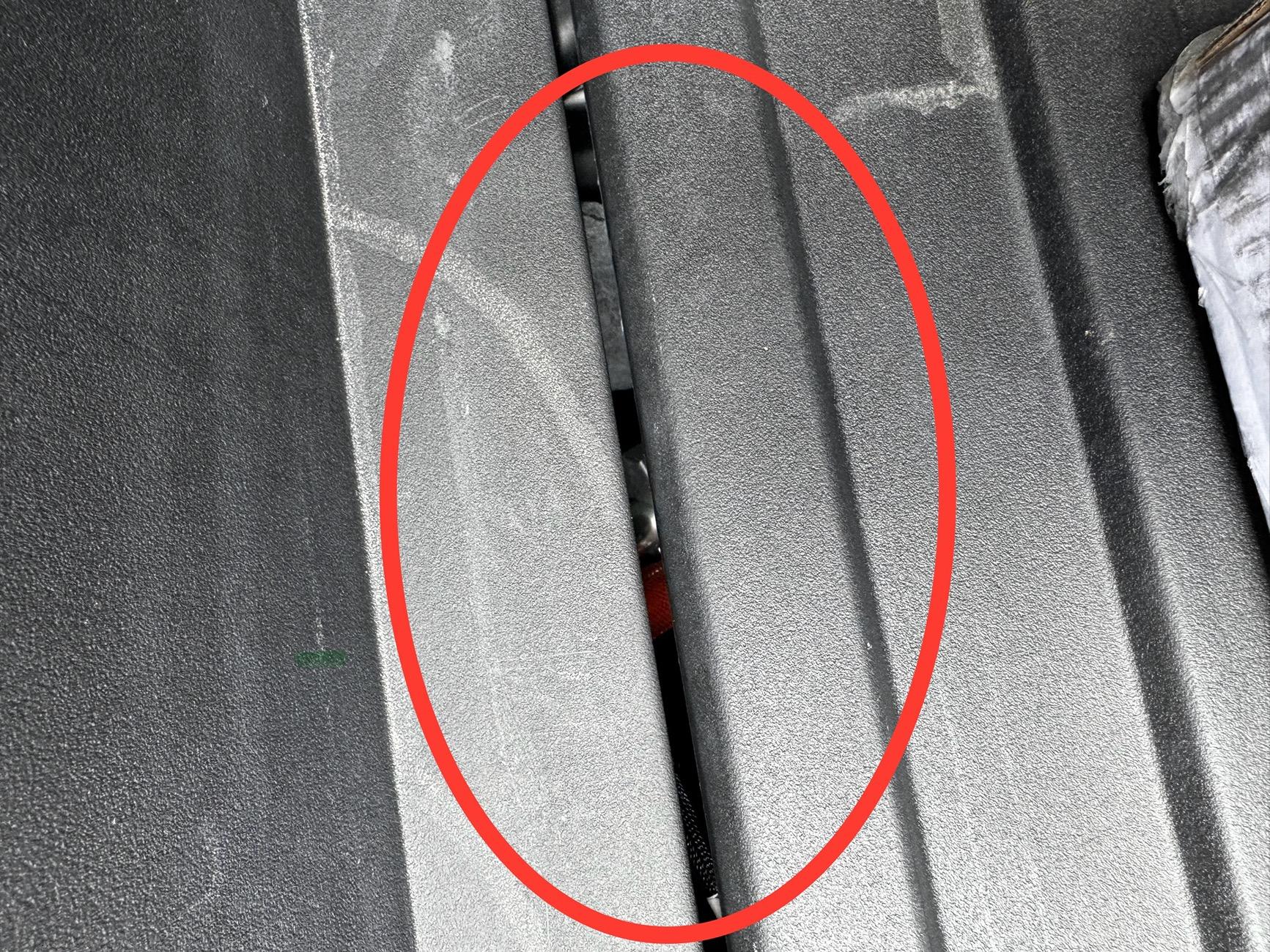

I’ve had my CT since May 31st and just now noticing the gap on the floor bed (upper driver side under glass) This can’t be good, I see exposed wire below. Thoughts? Setting up a service appointment as we speak, curious if anyone else has seen this. Thx.

Its normal and most CTs have it to varying degrees. The only solution is a bed mat, there are a lot of them out there.
The dirt and debris that gathers underneath there does not remove itself easily. it might become part of routine maintenance to remove the bed and clean underneath.

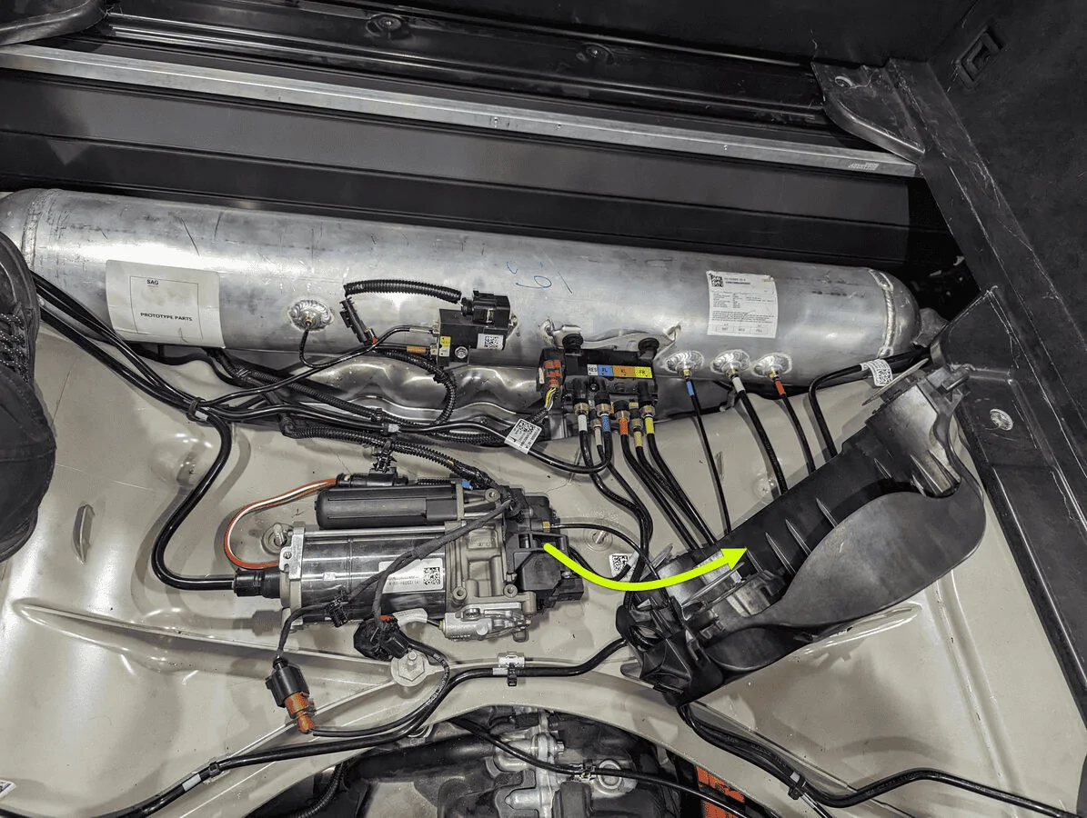

Here is what is under there. It looks water protected for the most part. Its just dirt, mice and leaves that will collect down there. The compressor air intake might also get gummed up.
