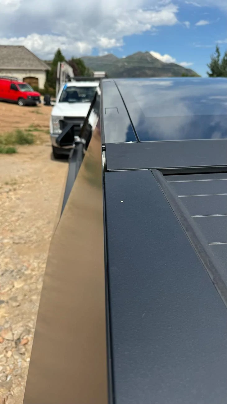

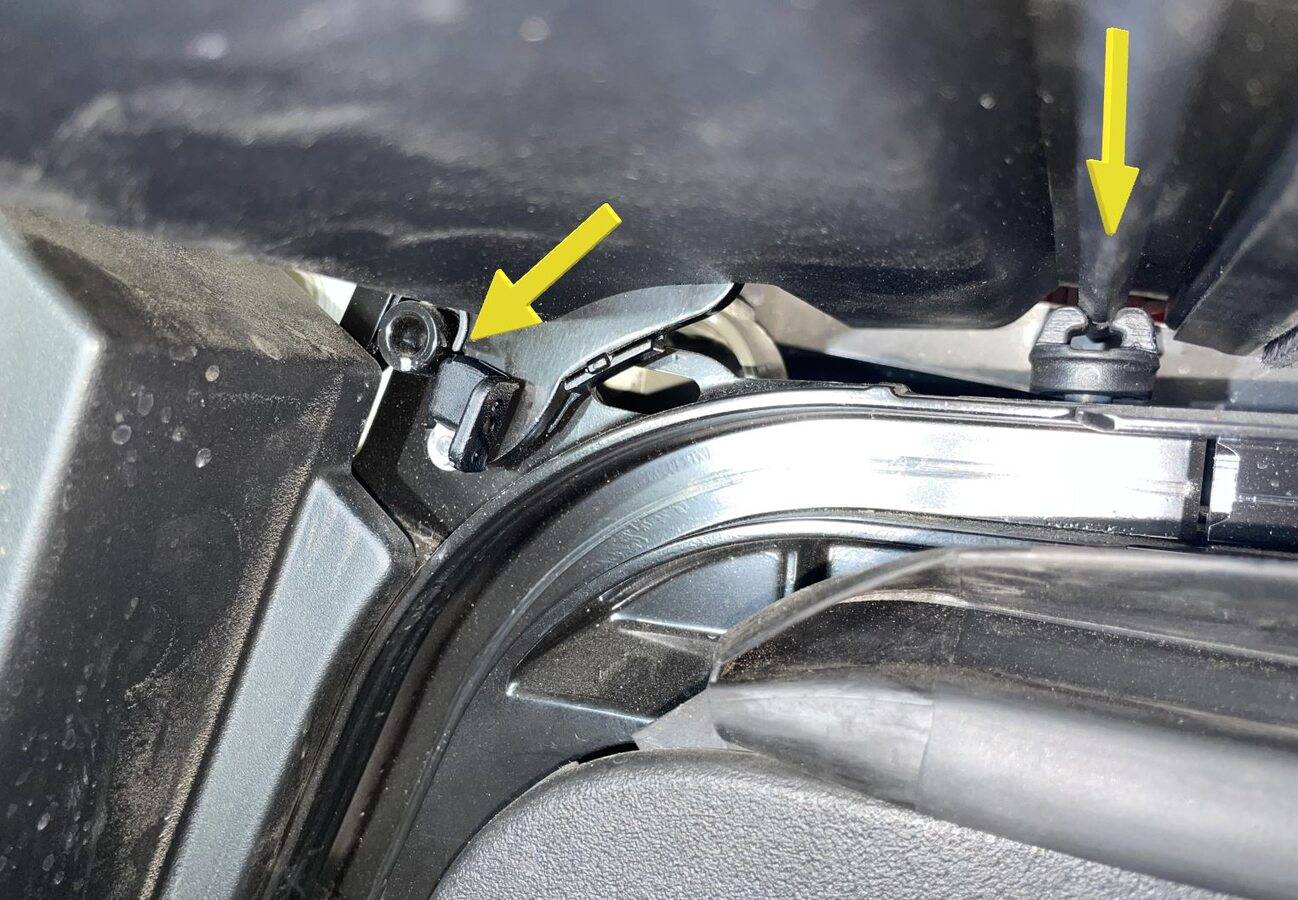

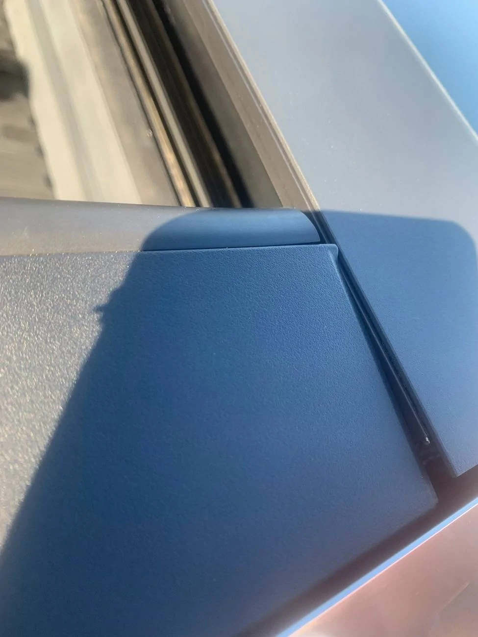

Position the tonneau applique on the vehicle, align the applique with the basecamp snapclips (x2), and then push the applique downward to engage the spring loaded locks (x2) on the fishmouth brackets (x2) and the snapclips that attach the applique to the tonneau corner rails.So today for the first time, I noticed a weird gap that doesn’t even make sense to me, since it’s all one solid piece. First two pics show the gap on the left side. Third pic shows how it should look on the right side. Has anyone else noticed this on their truck or know what would cause it?
