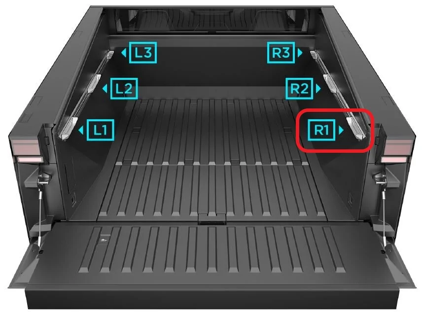

Not super complicated. When the platform unfolds it does so onto l-track brackets in specific locations.
one of them happens to be the last few holes closes to the tailgate.
Tesla Cybertruck Bed grab handles IMG_5488
So basically my handle has to be mounted behind L1 and/or R1

So here is what I got.
m8 foot pegs with 26mm screws and then m8 L-track bolts with 25mm screws. I’m hoping this will allow me to screw the peg on close to flush.
https://a.co/d/9ItpRb2
https://a.co/d/9xzKFj4
I’m fairly confident they will clear the tonneau when folded upwards but we will see
might be a long reach to the handle…

Maybe so. We will see. It will be roughly on the 5th or 6th L-track hole. If it is, I’ll make use of uncle Bezos’s generous return policy.
