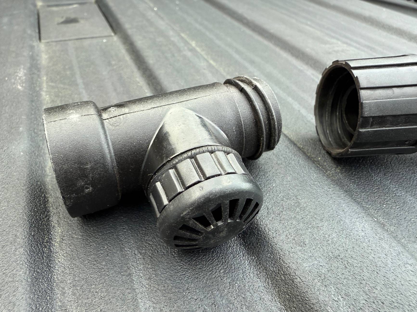

Thanks for sharing this - yes I did have that piece connected. I think it’s a valve that allows the pump to fill the tent with air on both the up and down stroke and not act as a pressure relief valve above 8psi. It didn’t relieve pressure for me when I was filling it.
On the topic of the T-connector, I can confirm it is a pressure relief valve, *but* I think it can sometimes get stuck.
With the pump in dual-action mode, and the T-connector mounted, hold the output nozzle with your finger and pump down. The valve should open at ~7-8 psi. If you pump down fast, you may see the needle on the pressure indicator swing into the yellow-red zones, too. When moving the pump up, you should feel no back-pressure on your finger: the air intake is on the pump lever itself.
I think it may get sometimes stuck, though, and I have no idea what does that. My approach now is to first unscrew it and push it open manually a few times; then reassemble and test as described above; then pump the tent.
