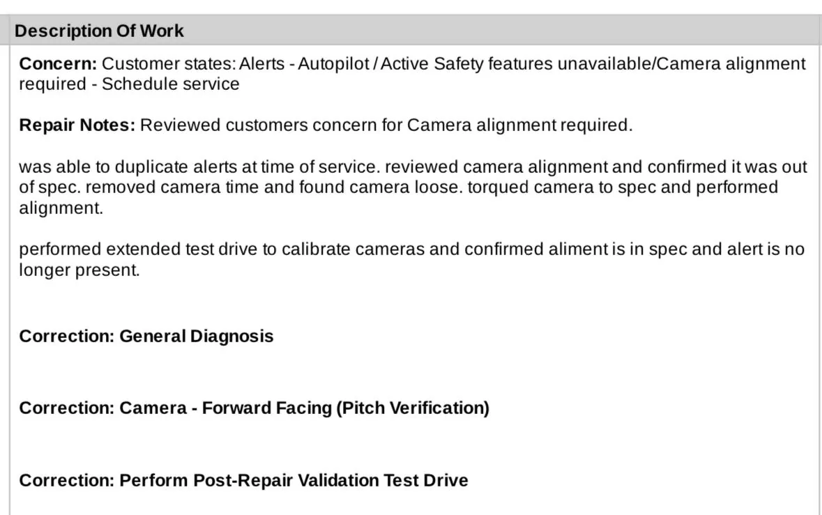

I’ve had my AWD for 6 days with zero issues then today I see two errors:
Autopilot/Active safety features disabled: Camera alignment required schedule service
And
Lane departure/ Avoidance features unavailable
Features may be restored on next drive
(They didn’t)
Anyone else had these errors? I really don’t want to leave this truck in service for even 1 day, it’s so awesome to drive!!!

Same issue.
Camera Pitch was off and CT menu camera calibration did not fix so needed service, fixed one day in service.

Maybe I should try to calibrate first before going to the SC. I didn’t think of that
Looking at the service report, it suggests that the camera is loose. Which means that you may be able to realign it, but it may move again and mess it up.
