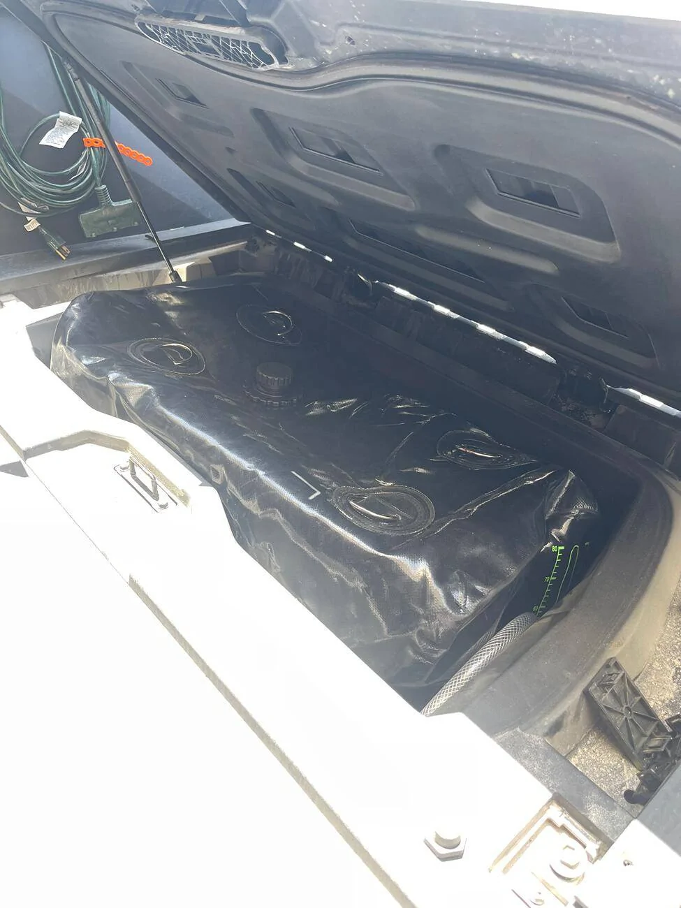

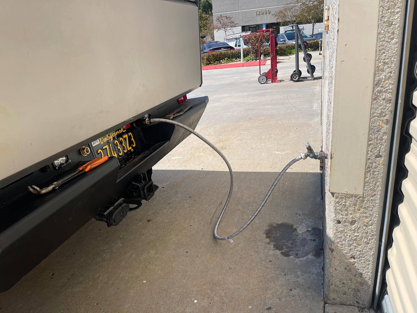

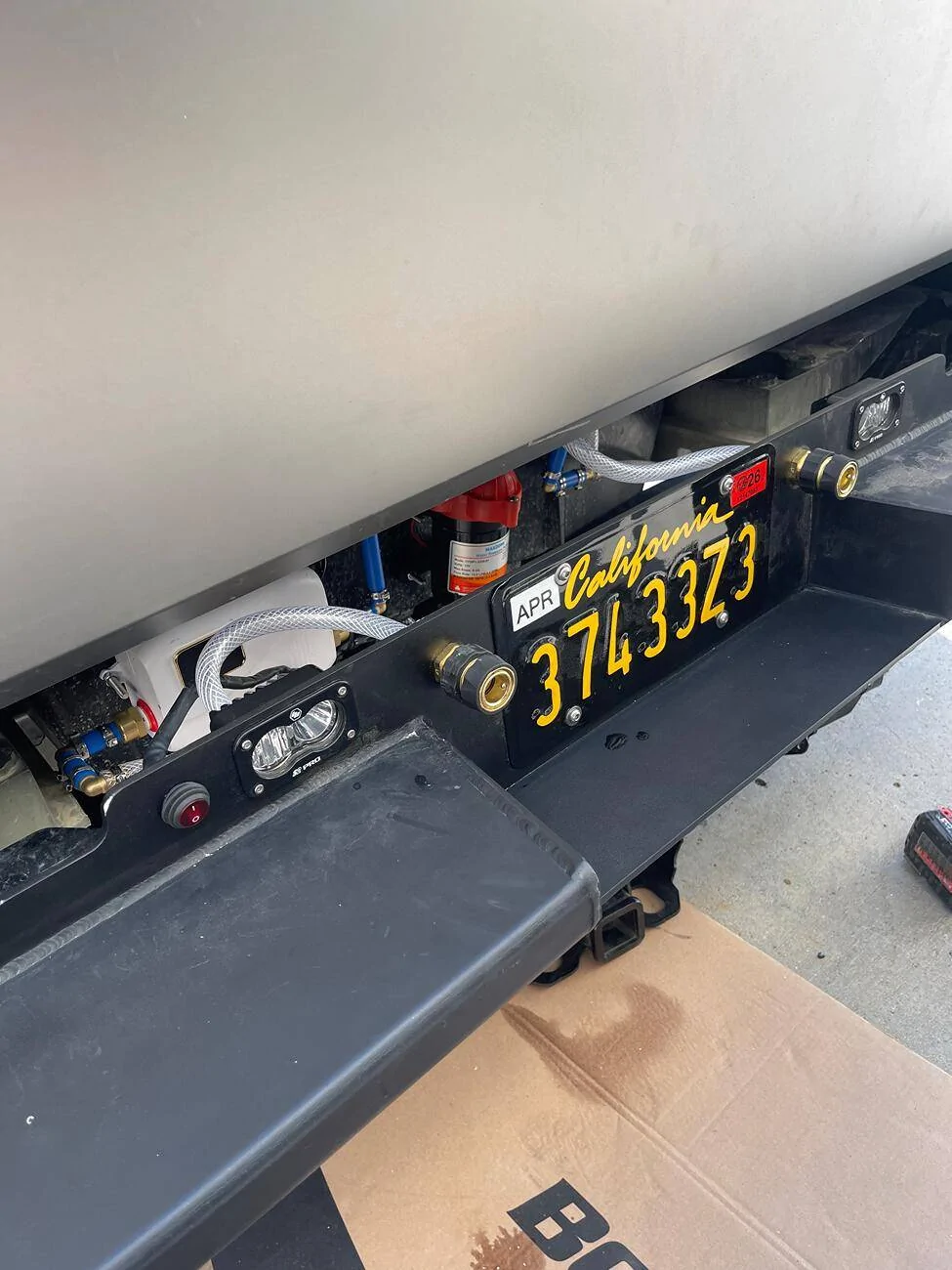

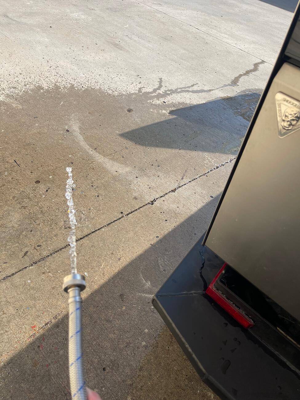

We are filming installation of our on 25 gallon on demand water system on Monday, will have on the site for sale next week for $449.
The kit includes does not have a water heater, but can be added in line as we did in these pics on our truck. We aren't including heater because there are enough options customers can figure out how hot they want to pay for.
When using the OEM rear bumper the water spigots can be placed under the tow hitch cover, in the bumper like we did or in the smugglers bay itself.

Very cool. How do you route the hoses from the smugglers bay to under the tow hitch cover?
