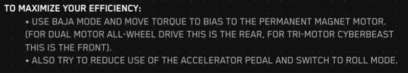

That's interesting. I presume this instruction to maximize efficiency is in the off-road section? Or lifted from the off-road manual Tesla published recently?
If so, it does seem to imply the baseline F/R power bias in automatically moved closer to 50/50 in Overland Mode. But my point remains, if low traction is actually coming into play, via wheel slippage (while not in Baja Mode), the F/R bias is probably adjusted (based on wheel slippage) such that the instantaneous traction controls don't need to be activated as frequently. Baja Mode probably turns off those automatic adjustments to F/R bias in order to provide a consistent driving experience when Baja Mode is selected.
Yeah, from the off road guide. Page 10, just before how to do donuts. https://service.tesla.com/docs/Cybertruck/cybertruck_offroad_guide.pdf
Thanks for that, I'm going to experiment more with rear wheel power bias in Baja Mode to increase my off-road efficiency. I already prefer "Roll Mode" because it feels more organic (but I will admit switching to Hold Mode in more consequential situations).
