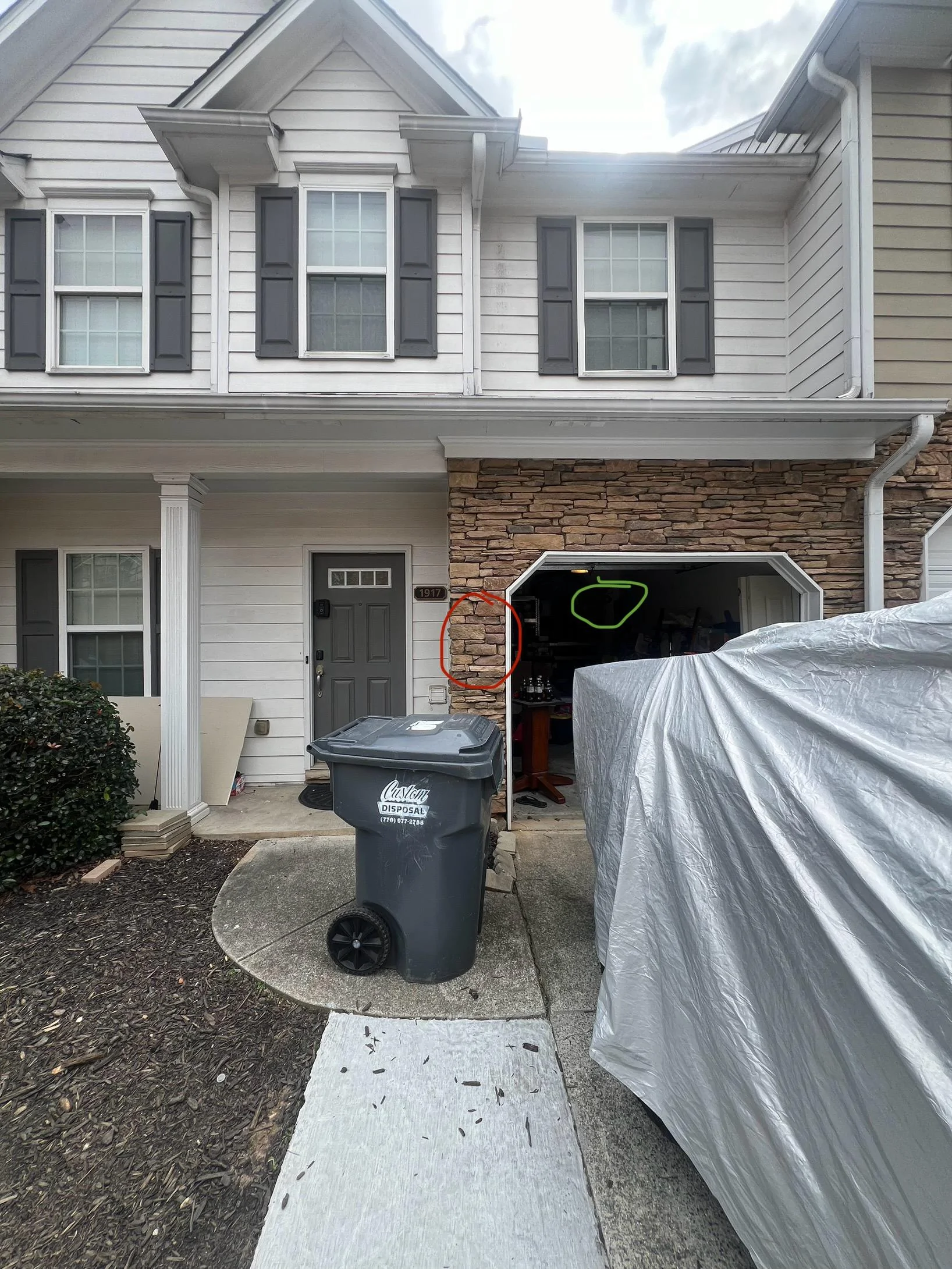

They told me that it would connect to the electric panel inside my garage. And from the panel to the beginning of my garage is 18ft.
Green marker is where I would want the wall charger and red is where the panel is. Meter is in the back of the townhome but they didn't say we needed an additional
You could put it on the inside and let the cord run under the door.
But don't forget to check with HOA, exterior modifications can be problematic. (Inside, they don't see)

People not even looking at OPs picture. No stone drilling or cutting needed. Say its 10 feet up the wall, 25 back and another 10 down, MAX, 55ft of 6g wire ($350), conduit, breaker (assuming the box has a double pole available), exterior outlet box, various, $400 or so in materials. My rule of thumb is to double it for install. Should be a $800 or less job.
Pretty sure the red circle indicates where the device is intended. Looks like stacked stone to me.
And don't forget the cost of permits.
"Green marker is where I would want the wall charger and red is where the panel is. Meter is in the back of the townhome but they didn't say we needed an additional"
An electrical permit is $75 in my area, YMMV.
